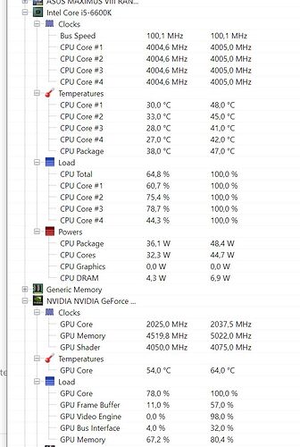

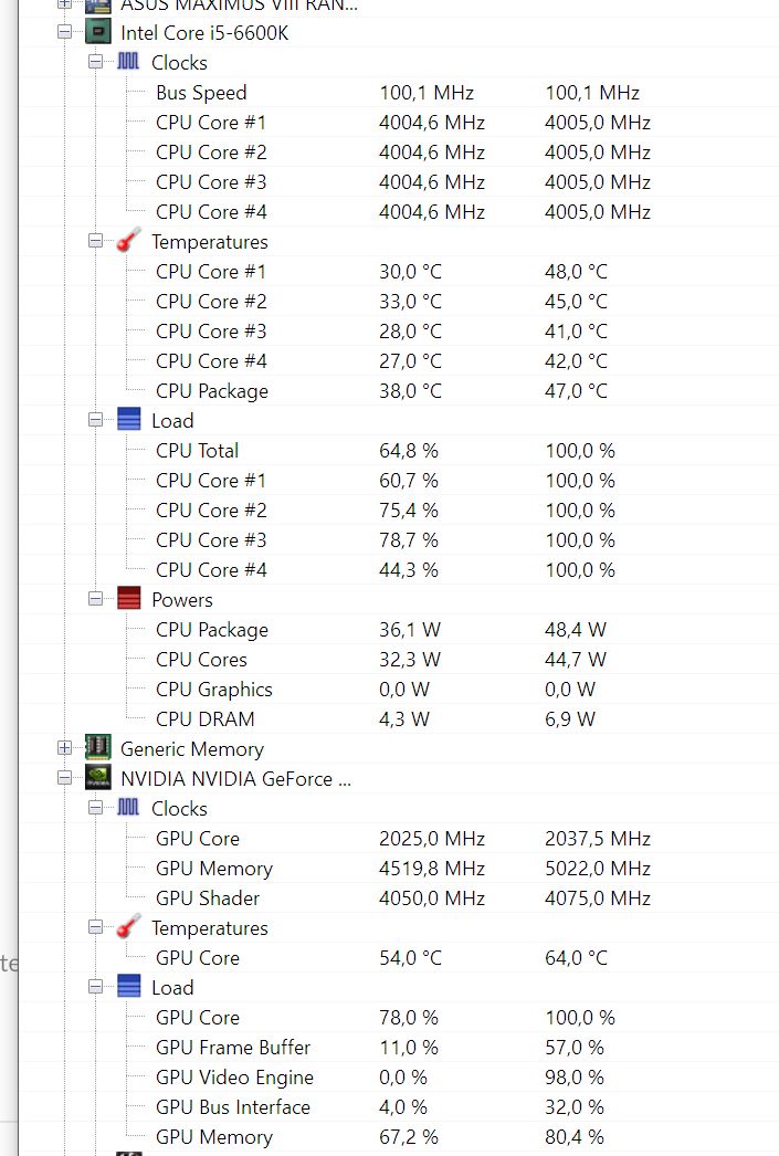

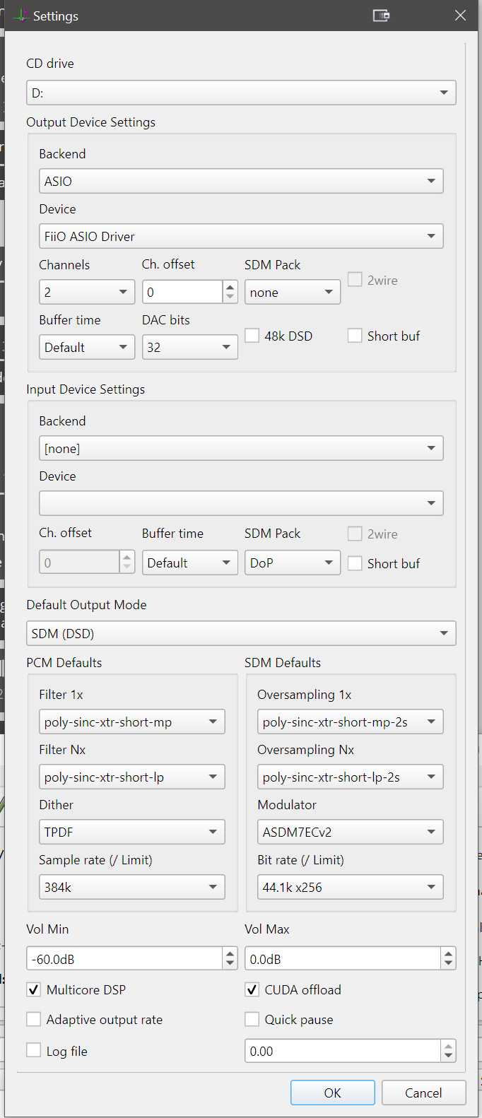

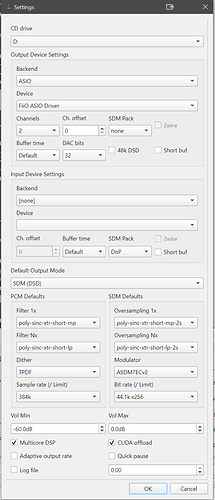

Maybe this question doesn’t belong here, but I recently get the trial of HQplayer, and I want to know if Im using properly.
This is my actual configuration
And this is my perfomance with it
Im using with a FiiO K9pro AKM on i5 6600k and 1080gtx.
Its too much cpu/gpu load for this equipment?
Should I change any option?
Thanks in advance for your help

Looks perfectly fine to me. You are utilizing your hardware up to the point where you have a good margin but it is not yet stressed too much. So you have some margin left for other things or future updates.
If this would be under typical gaming load, all CPU cores plus GPU would be at pretty much constant 100%.

I know the process could be demanding, but a friend with a rme2adi dac seems to get less load on his computer than mine.
So the question is not only for the consumption, want to know if everything is configured the way it should. :+1:

Same CPU with same clock speed and same settings?
For a quad core, I would set Multicore DSP to greyed, unless you have already tested that checked gives you better performance. But I don’t see anything else there.
Seems to he doesnt setup the HQplayer correctly on Mac, after enable SDM pack he has the same consumption.
Anyways, wanna know if I setup the k9pro AKM correctly, if anyone could help me…
