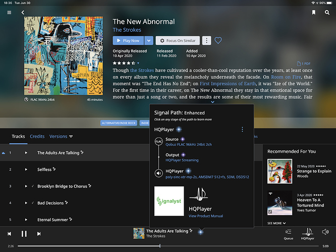

Here are my settings.
I keep going back and forth between “poly-sinc-ext2” and “poly-sinc-xtr-lp-2s”. Both using ASDM7EC and upsampling PCM and DSD to DSD128. The former is a little more Chord Dave-like on my DirectStream and the latter is just really musical yet clean and detailed. I am happy with either!!
