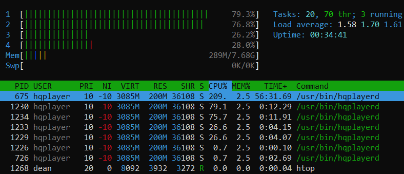

Tried the new ASDM5ECv2 @ DSD128 and poly-sinc-short-mp-2s on my i5 8gb RAM laptop - 4.26.0 HQPlayer Embedded - Ubuntu 20.04 server, a bit more CPU juice is needed:
Same song and output using ASDM5EC:
Too early to tell if 5ECv2 is any better, thanks for the great work Jussi.

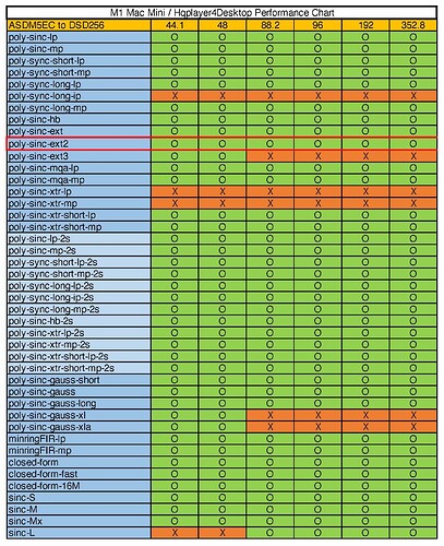

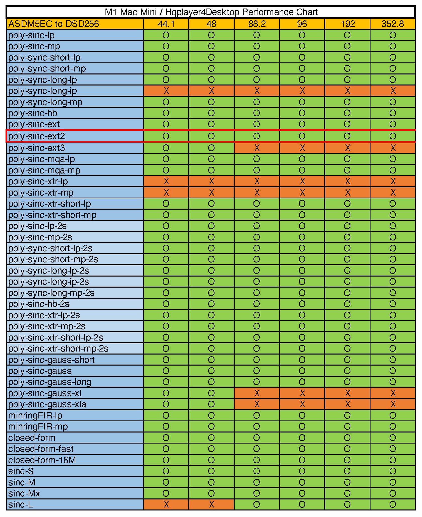

Unfortunately the performance of M1 is not sufficient for this combination. I made two charts for your reference. The first chart is ASDM5EC with filters upsampling to DSD256 or DSD256x48.

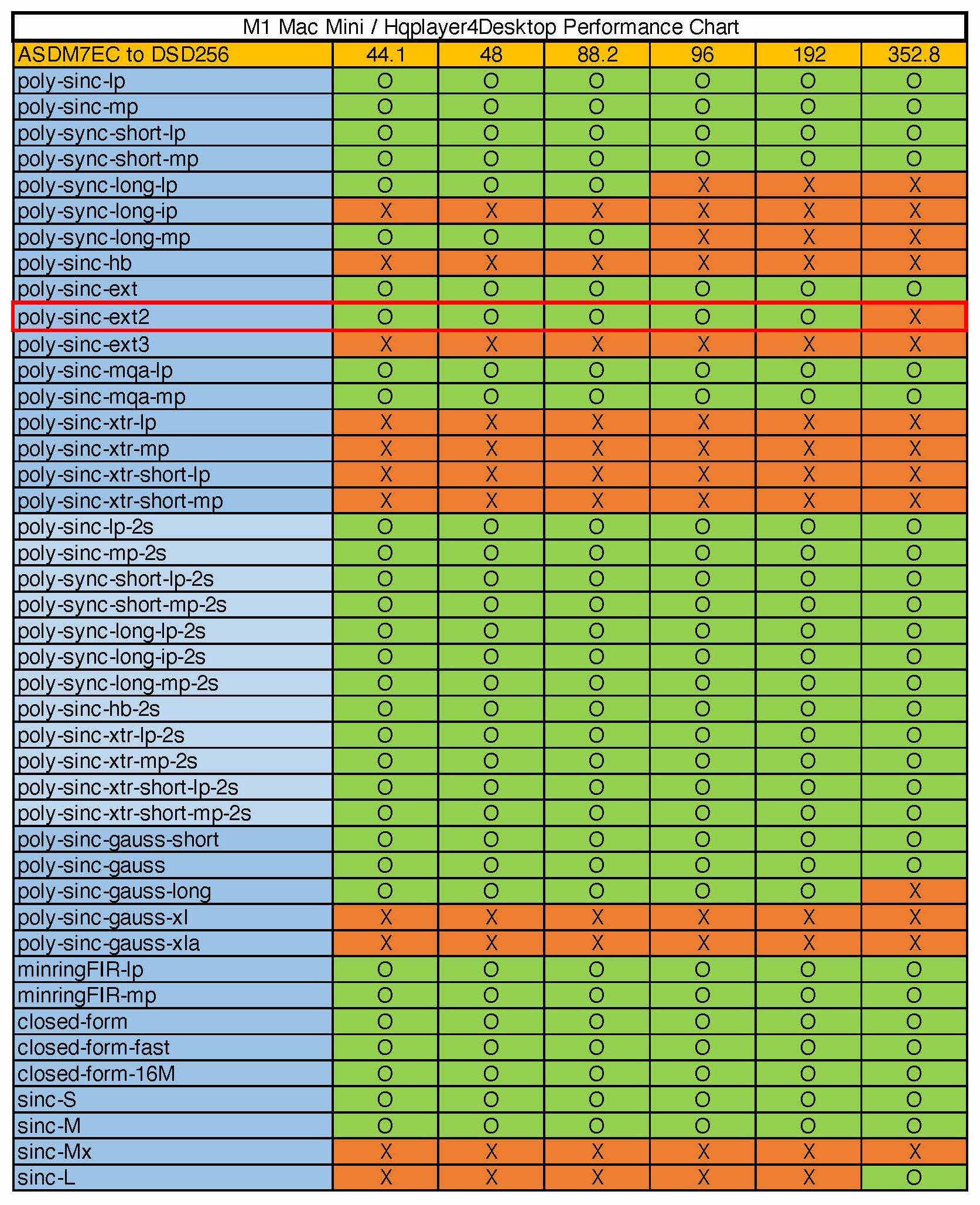

The second chart is ASDM7EC with filters upsampling to DSD256 or DSD256x48. I think this is good for other platforms’ performance comparison and evaluation.
*My Mac mini M1 was configured as 8GB RAM and 256GB SSD.
