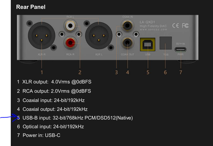

How do you know those support 32-bit PCM? Neither one mention anything about it in their specifications.
HQPlayer detects maximum available resolution for a DAC and uses it by default.
You cannot force output to go beyond detected maximum resolution as it would result in truncation which in turn would generate distortion.

Fair point. For the Soncoz, the user manual indicates 32-bit / 768kHz on the second page of the user manual:
LA-QXD1-USER-MANUAL-EN (soncoz.com)
For the Revolution I could be mistaken. The Allo web page refers to 32-bit processing, and other unofficial places I see it refered to as 32-bit / 384kHz. I know the 384kHz limitation is due to the USB interface implementation, so I’m assuming the 32-bit part is as well. But that could be referring to what the ESS DAC chip is capable of, not what the interface is designed for.
For both, when I up sample with Roon it indicates 32-bit output.
So this is why I’m assuming they are both 32-bit capable. EASILY could be wrong. But it’s enough to make me raise the question here.
Please check that the DAC is NOT selected as default audio output device for macOS. And that there are no other applications running that are configured to use the same DAC. Such as Roon. Make sure the DAC is not enabled as audio output in Roon at the same time.
If you can email me HQPlayer log files with both of these DACs I can check what is the reason for HQPlayer’s decision.
thanks, log files sent.
Now that you mention it, my Gustard X16 says it can handle 32 bit / 768kHz on usb input. Hqplayer embedded reports 24 bit, the utraRendu that is attached to the dac and in it’s own Dac diagnostics app says 32 bit for the Gustard.
