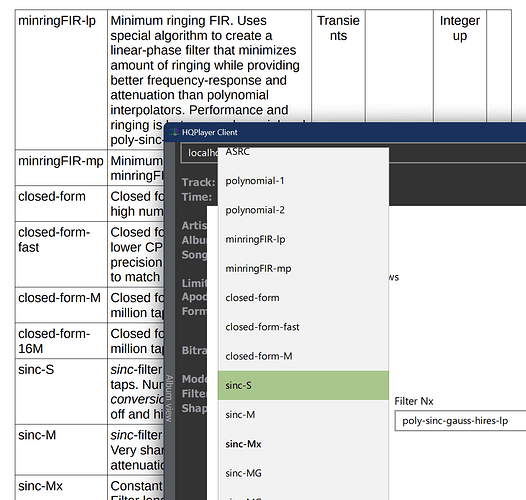

Does anyone know where the closed-form-16M filter went? it’s in the manual but in the selection screen of either the client or the server I can only see closed-form,normal, fast and M…
EDIT: Apparently 16M is only available for DSD output, not sure why though.
Because DSD output rates are higher and thus can also accommodate much higher filter lengths.
16 million taps linear phase causes 8 million samples delay. Sample rate is naturally number of samples per second. So you can calculate amount of delay it would have at PCM rates…
That makes total sense, thanks for the clarification!

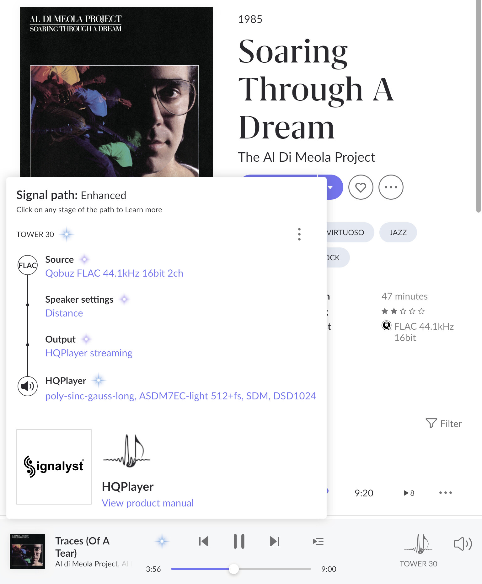

@jussi_laako : objectively, is there any advantage to using the 7EClight + 512fs filter instead of the 7EClight for DSD256 output on an A26 ?
There’s a listening advantage ? also the processing advantage (assuming the same load) ?.
I find it hard to evaluate : not worse, better ? a cognitive bias ?
