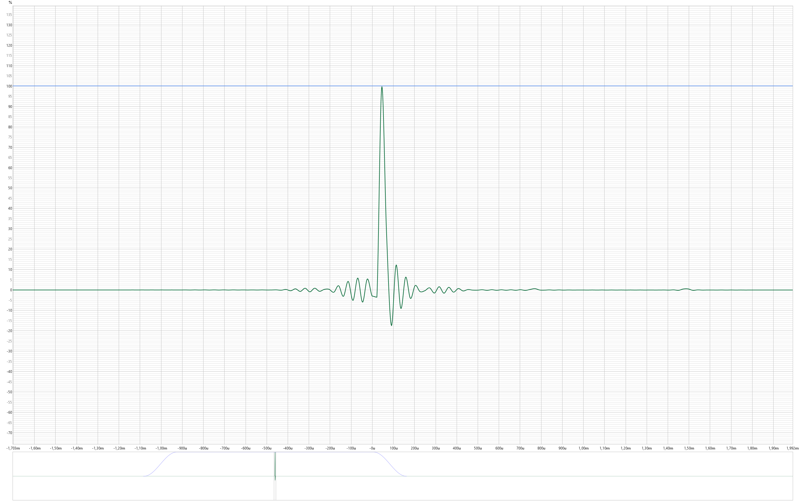

I just wanted to share what pushed me down the path of analysis and comparison. I have a DAP with R2R architecture and 256 FPGA taps. One of the filters has a very comfortable and non-fatiguing sound for me and the noted community. The manufacturer spices its description with words like “ultra” “secret” etc :). In search of the truth and “grail” I tried to take a picture of its AFC and impulse (attached below). How would you rate this filter? Which of the current list of available HQP filters is it closest to from the technical and scientific point of view?
Looks like asymFIR

Looks like combination of FIR and IIR which is what ESS does. And looks like 4x oversampling since you can can see lower half of the first image at the right side of the plot.
From that plot it looks like quite a bit of NOS-like roll-off and ripple in top octave (IOW, some pre-echo too). Followed by steeper roll-off. Depending on how that measurement came to be.

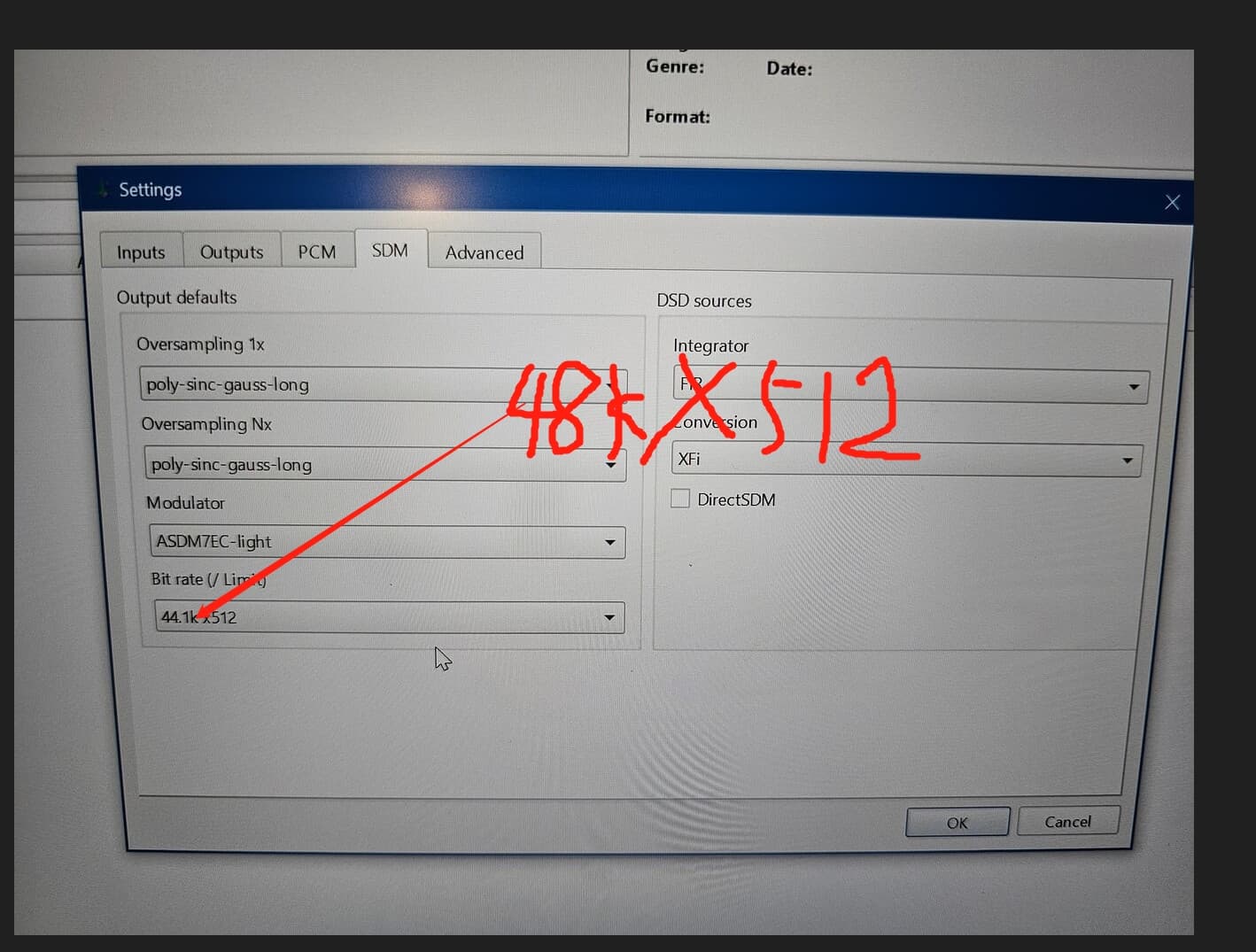

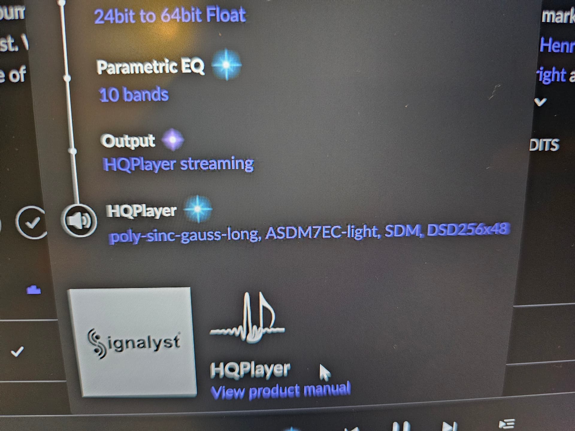

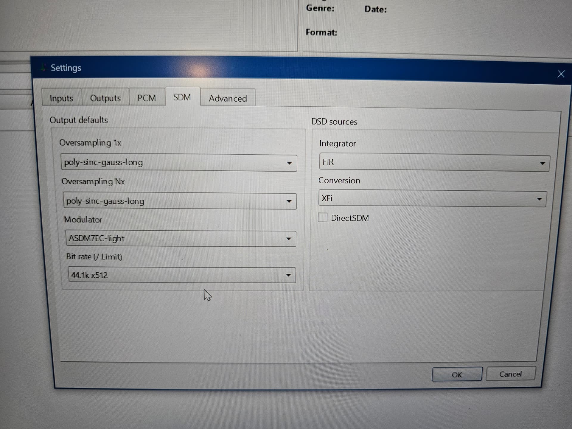

can someone tell me where I’m going wrong? aiming for DSD512 but output shows DSD256.
Rockna wavelight server
Rockna Wavelight dac
via i2s connection
if I use the wavelight server upsampling, the dac can do DSD512.
You have SDM pack “DoP” selected. This is DSD over PCM. It’s allows for DSD to be sent across drivers which only understand PCM but takes twice the PCM bandwidth. That means 512 native becomes 256 DoP.
Some DACs only support native DSD via their own drivers. I don’t know your DAC. But I’m going to assume this is why you’re only seeing 256 with your NAA endpoint. Does it work without DoP?
