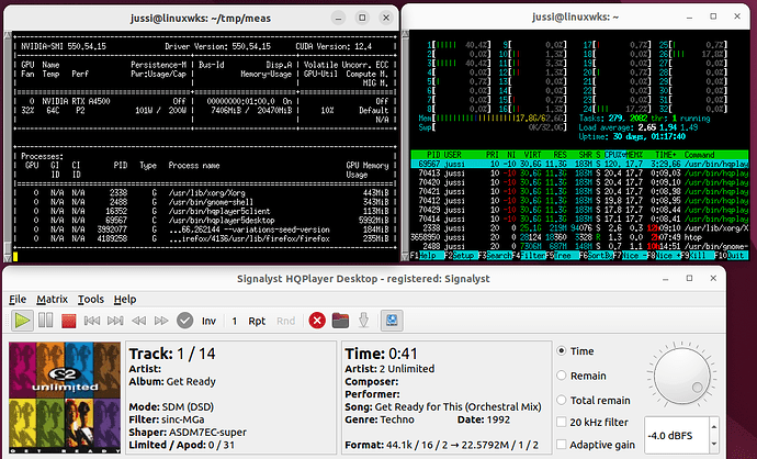

This is on my i9-14900K with DDR5-6400 CL32 RAM (G.Skill), AIO water cooling, and RTX A4500 GPU, doing DSD1024:
It is not even breaking a sweat.
And sinc-MGa to DSD512 is not much trouble either. DSD1024 with the same almost works, but ends up in buffer underrun every now and then.
This particular album because it is first item in my library :joy:

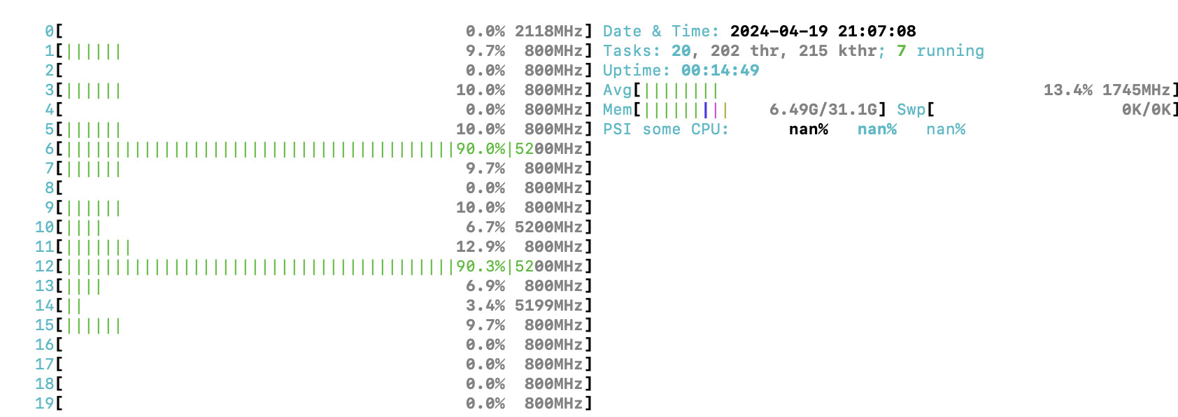

I only listened for about a minute but it didn’t stutter. I might be right on the edge though as I do see my e-cores jump to 100%. My p-cores, although not well distributed, stay below 100%. Here are my configs:
BIOS tweaks:
P-Cores can go to 5.2Ghz
E-Cores can go to 4.0Ghz
RAM is optimized for overclock XMP II
HQPlayer Embedded:
Short buffer: Short
Multicore DSP: On
E-cores: DSP Pool
Blocks per cycle: 11
Modulator: ASDM7EC-super
Oversampling: sinc-MGa
Rate: 12288000
since we’re sharing:
It bounces between e-cores close to 100% @ 4Ghz
to 2 P-Cores going close to 100% @ 5.2Ghz
EDIT: Skips on 24/48 so I can’t keep it as my 1x unless I can squeeze a little more performance out of my system.
