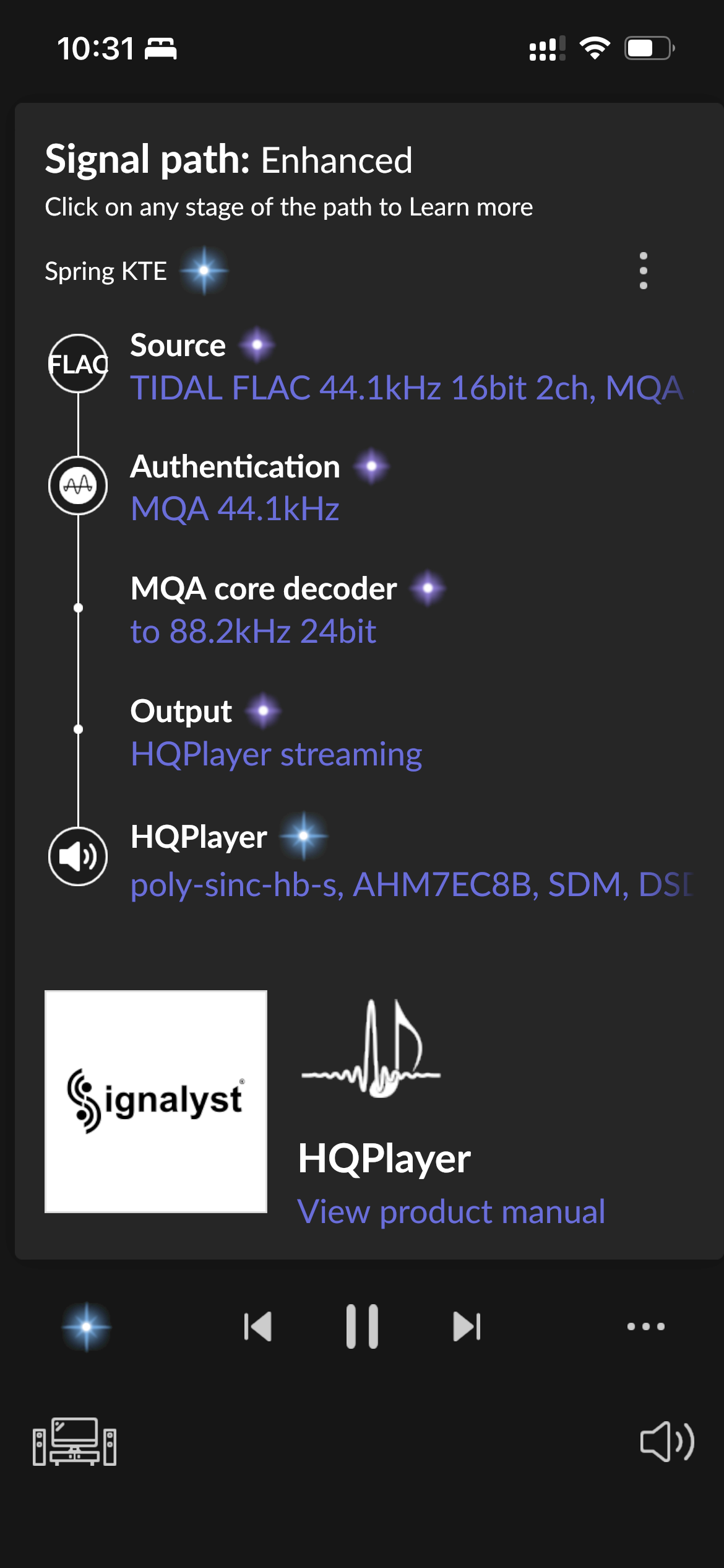

I am using a mac M4 as roon server and loaded hqplayer on the same machine. A LHY pi-based machine runs gentooplayer and it links to a Holo red running Gentooplayer via an ethernet cable. The Holo red is in pure Diretta target mode. Holo connects to my dac (dual ess 9039pro) using i2s via hdmi cable.
For the longest time I upsample to dsd512 (the max for my dac), and use asdm7ec super, and sinc short.
Recently I played some native dsd64 files and they sounded wonderful. Using the native dsd64 as a reference, I found that the most lively and stressfree sound happens when I upsample to dsd128, and use poly sinc gauss long and asdm7ec super.
In my system, asdm7ecv3 is not as good as the super version. And sinc short or sinc medium or going beyond dsd128 actually makes the sound less natural and less lively. I realize that when I do not have a proper reference, I find it hard to tune the system right.
Please note that poly-sinc-gauss-long doesn’t apply to DSD sources, only to PCM sources. So please don’t believe what Roon signal path display claims (it’s been buggy for years and Roon has not fixed it). Instead please check what HQPlayer Client (or the server) says… Current default for DSD sources would be FIR2/XFi.
This is technically also the case, ECv3 is last of the older modulator series. -ul/light/fast/super are the new generation. So makes sense…
Please note though, that playing DSD64 as-is has it’s own technical issues. So the reference is only presentation of DSD64 your DAC is able to give you within the technical limitations of DSD64…
