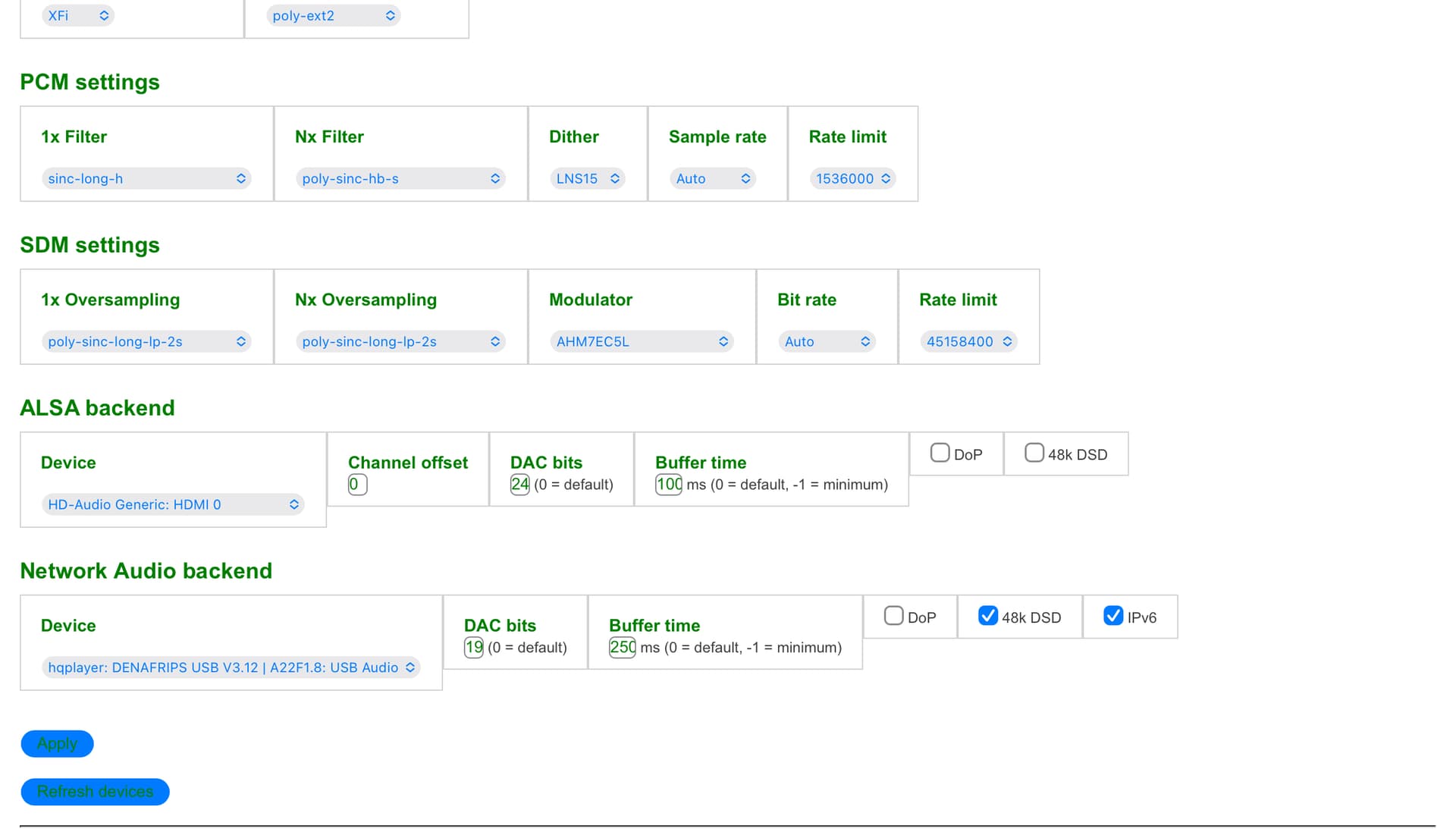

I changed my pc to new more powerful one - Beelink SER9 mini PC AMD Ryzenā„¢ AI 9 HX 370, AMD Radeonā„¢ 890M, 32Gb LPDDR5X 7500MHz, 1Tb m.2 PCIe 4.0 x4, HDMI / DP / USB4, Wi-Fi 6, LAN2500
With this change my system is able to support more configurations that require more resources like PCM to DSD 512 and even 1024. However, there are some moments that are not clear for me… For example I can configure
SDM (DSD) poly-sinc-long-lp-2s ASDM7EC-super 22579200
and it will do the PCM conversion to DSD512 and play the CD from CD transport without any drops, therefore DSD1024 it cannot even start to play. I have the same behavior with all ASDM7EC family.
Another example:
SDM (DSD) poly-sinc-long-lp-2s AHM7EC8B 45156400
it will do the PCM conversion to DSD1024 and play the CD from CD transport without any drops, therefore DSD512 it cannot even start to play. Another moment I hear a little hiss when playing 1024. With AHM7EC5CL I have the same.

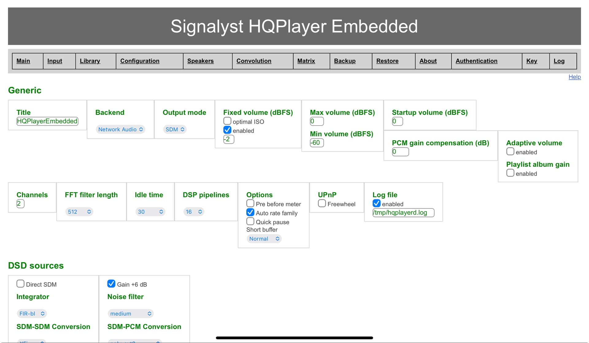

About my setup: I have Roon Core (ROCK) implemented on NUC 10th Core i5, HQPlayer Embedded implemented on Beelink SER9 mini PC AMD Ryzenā„¢ AI 9 HX 370, AMD Radeonā„¢ 890M, 32Gb LPDDR5X 7500MHz, 1Tb m.2 PCIe 4.0 x4, HDMI / DP / USB4, Wi-Fi 6, LAN2500, CD Transport Audiolab 6000CDT, DAC DENAFRIPS ARES II, Spdif optical to USB interface - Hifime UR23 SPDIF Optical to USB converter
Here are the screenshots of my configuration:
Thanks for your comments and advices.
This combination can do DSD1024, no problem. I would recommend to enable log file and take a look why it won’t play. The reason is also shown on HQPlayer Desktop server status bar for 10 seconds when attempting to play.
AHM modulators are DSD1024-only. So no rates below DSD1024 allowed.
Is your Denafrips firmware up to date? It should work fine at DSD1024, but the DSD1024 exceeds USB specifications and may not work on all hardware. If you get a noisy output, it may indicate USB data loss.
I know it works with Intel USB controllers, but I’m not sure about AMD. At least at some point there was a problem.
I was wrong, it start to play, however, I have dropouts. I didn’t find anything in log, only request for CUDA offload.
I have the latest firmware for my Denafrips Ares II (DENAFRIPS USB V3.12 and A22F1.8: USB Audio), I didn’t see any new versions for this Ares II.
it seems problem is here
I forgot to indicate that I have also HQPlayer NAA on the base of Raspberry Pi4 so no cable data communication from mini PC to DAC. However, I also tried ALSA Backend - the result is same.
About my network: I have Wi-Fi Mesh system, Roon, HQPlayer Embedded and NAA are connected by wires to the same MESH point ASUS RT-AX58U which is wirelessly connected to the main router ASUS RT-AX82U. The speed measured to the internet: downlink 380Mbps, uplink 450Mbps.
What can be the workaround or the solution? Any advices? Thanks.
Let’s say you have poly-sinc-long-lp-2s with ASDM7EC-super working at DSD512. When you go for DSD1024 with the same settings, the processing load almost doubles. So you can see how it can quickly exhaust the available processing resources in couple of output rate increase steps.
