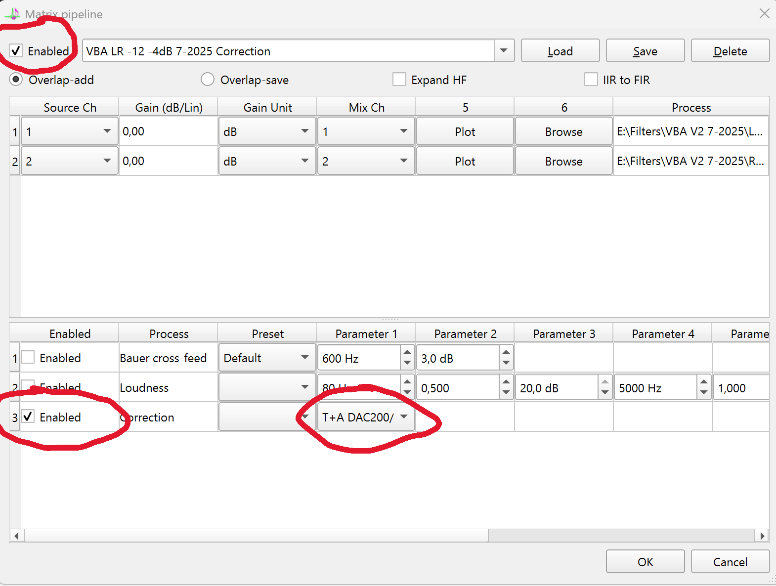

Still curious about the matrix part Dear Jussi: I presume it is under pipeline set up where I enable it and enable level 3 and find Holo audio may - however what other settings should I do?
You can find all this information from the manual.
Matrix pipeline settings can be found when you’re on HQP server main window and look at the top row. From there, select Matrix → Pipeline setup. When you have it open, check the ā€œEnabledā€ box on top left corner. Then look for Correction tab and check Enabled-box there also. From drop down menu select Holo May.
To make it easy, here’s a screenshot:
I have also the Holo May. Recently I discovered that sinc-M in pcm is incredible good. Polished warm sound with almost no digital glare. I seem to prefer long filters. Shorter filters sound a bit harsh, not only in the highs, but also harsh on voices and violins.
Hi Patouskii - thanks such much for your helpful comments. Since I am not that technically minded I am not sure what I am actually messing with here. I followed your advice but cannot seem to find anything like your: VBA LR - 12 ect. -----so where do find your filter?
Ignore those, they’re my personal DSP filters. Just check the settings I marked with red circle.
Okay thanks!

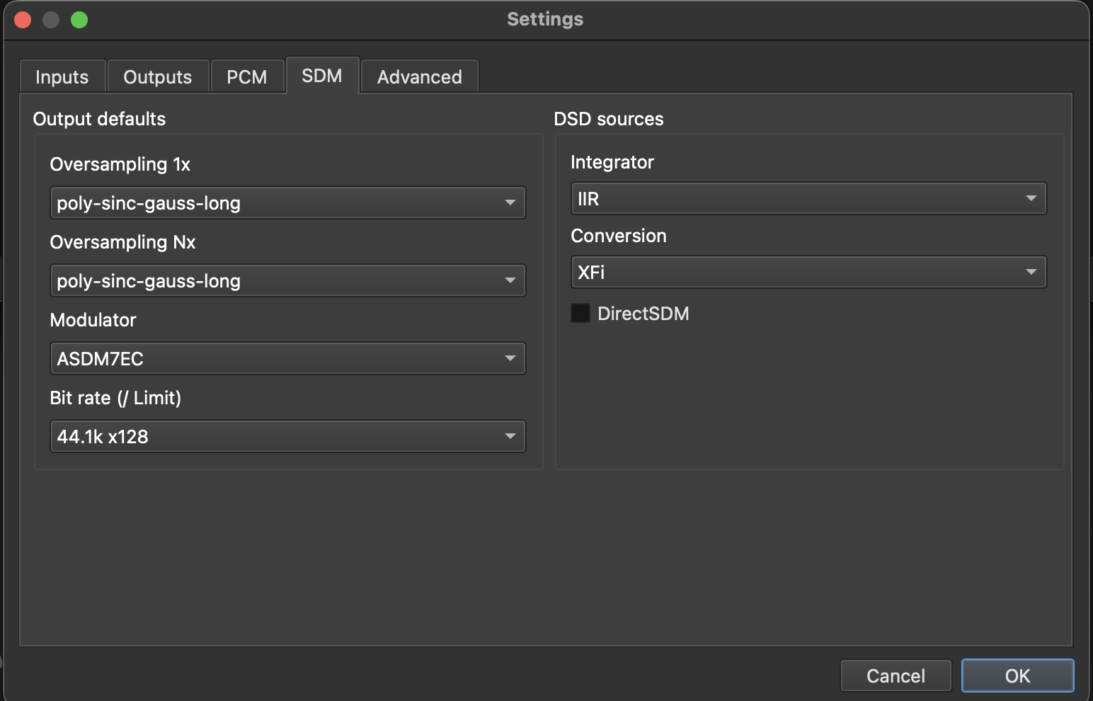

I really enjoy HQ Player and love its upsampling to DSD. I find the sweet spot for me is DSD 128. Excellent sound, normally without too much CPU for my mac mini. Oddly, I note though that when the source is anything other than 44.1, it takes much more processing power. For example, 192 sources almost double the cpu intensity and my mini starts to get hotter than I’d like. Is this because I am actually downsampling in a way, and then upsampling? Intuitively, it seems that HQ Player would need to do less work with something already encoded at 192. Thoughts on this?
@Mr_Todah You haven’t mentioned which filter or modulator causes this issue. It matters a lot
First reason would be conversion from 48/96/192k rate family to 44.1k-base family DSD output. This is not really heavier from calculations point of view, but it more demanding on the memory bandwidth. So the difference depends mostly on memory access speed.
With two stage filters for example 176.4k and 192k are also heavier than 44.1k or 48k because the first (heavier) stage converts by factor of 8 or 16. So for example 48k becomes 768k, while 192k becomes 3072k. So the first stage is four times heavier when the source rate is four times higher. Only then the second stage filter is applied to convert it to the final output rate, which in this case is 5.6 or 6.1 MHz.
Thank you. This makes sense to me.

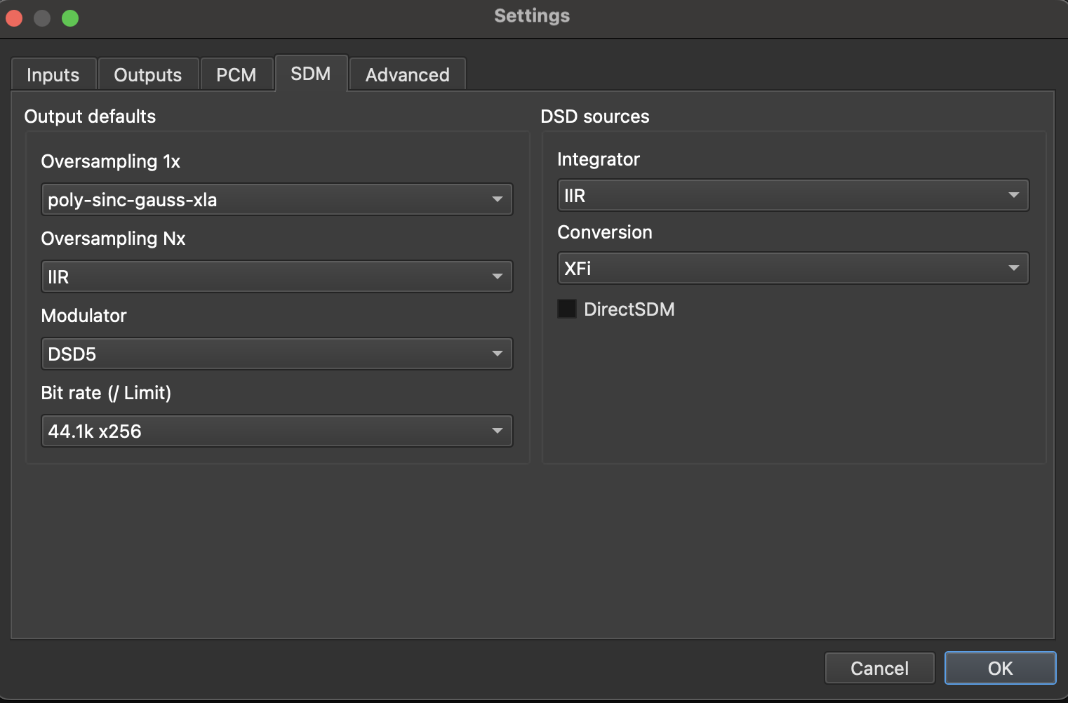

I’m using SMSL Raw MDA1 as my DAC and for the last few days I have playing with the filters on HQPlayer using this forum recommendations, I’m trying to tailor it to my Analog sound preference. I want to escape that glare sound on some digital recordings I own and replicate that analog sound on SACD and Vinyl (mainly listen to Jazz, Classical and soft rock). I’m noticing iir and xla filter combination on 1x/nx gives me that but DSD5 as a modulator was a bigger impact than ASDM5EC on sound. So far I’m so impressed with HQPlayer more than any tool I used before not sure if I get a better DAC I would get much better results or not. Any other recommendations?
Add images
You could try poly-sinc-short-mp-2s as filter. For both 1x and Nx.
You could also try ASDM5EC-super as modulator.
