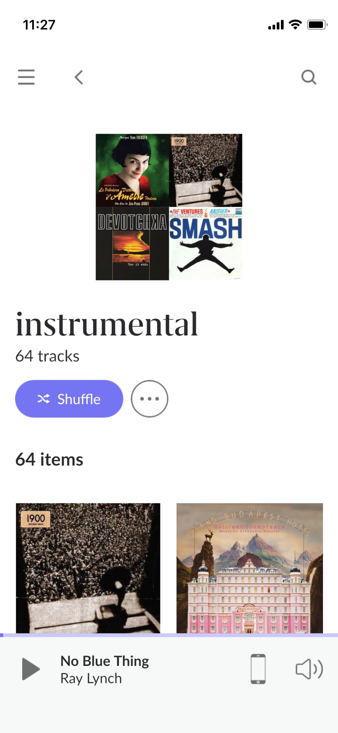

Here are some screenshots of what I do:
Go to My Stuff > Tags
Click on the tag I want to play (instrumental in this example)

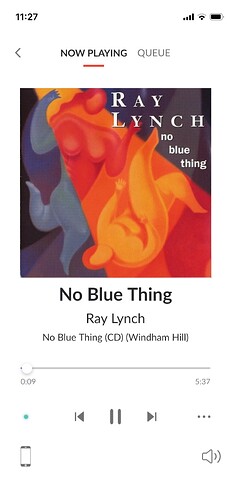

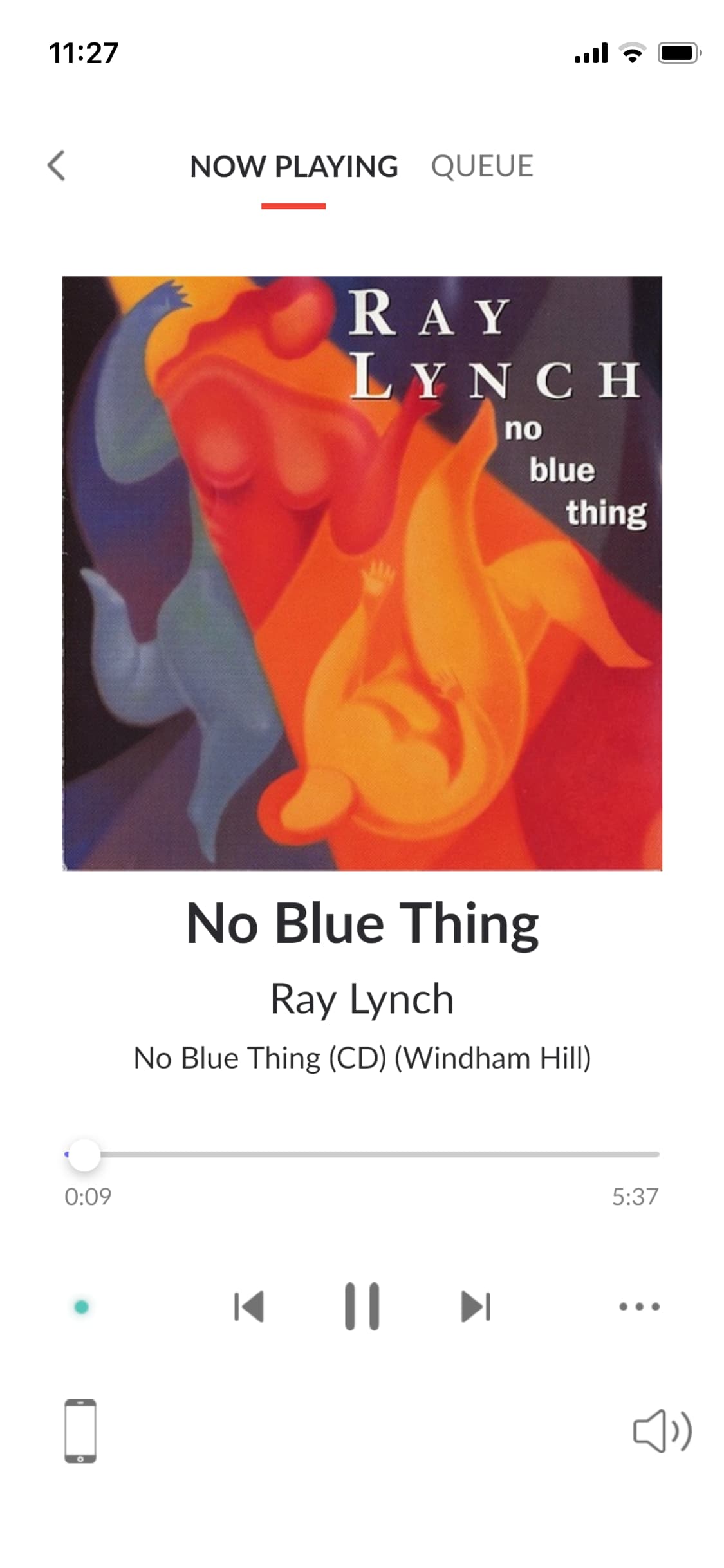

Click Shuffle

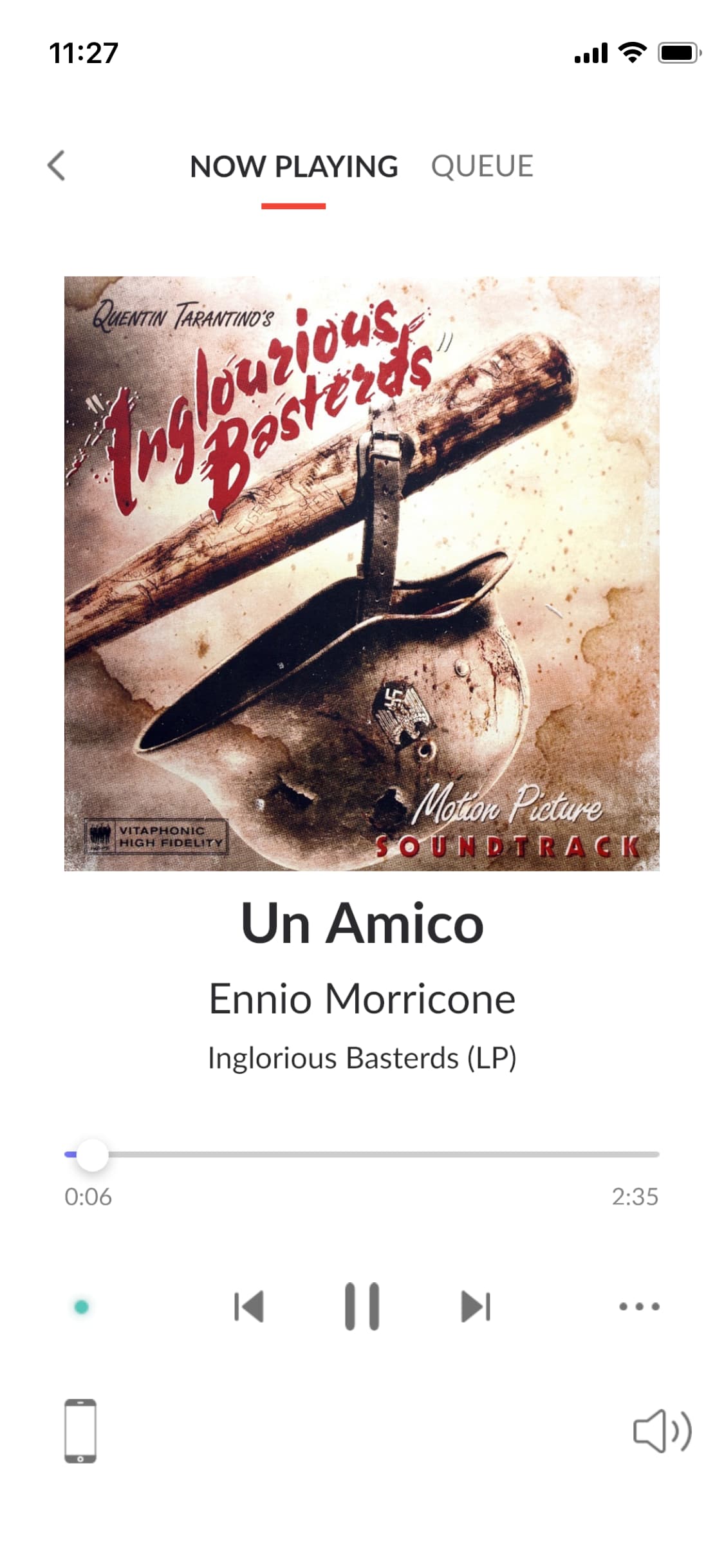

First track starts playing with no problems
After first track has finished the second track comes, no problems here

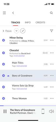

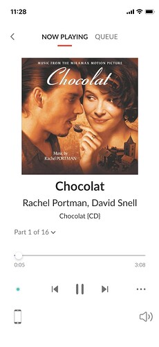

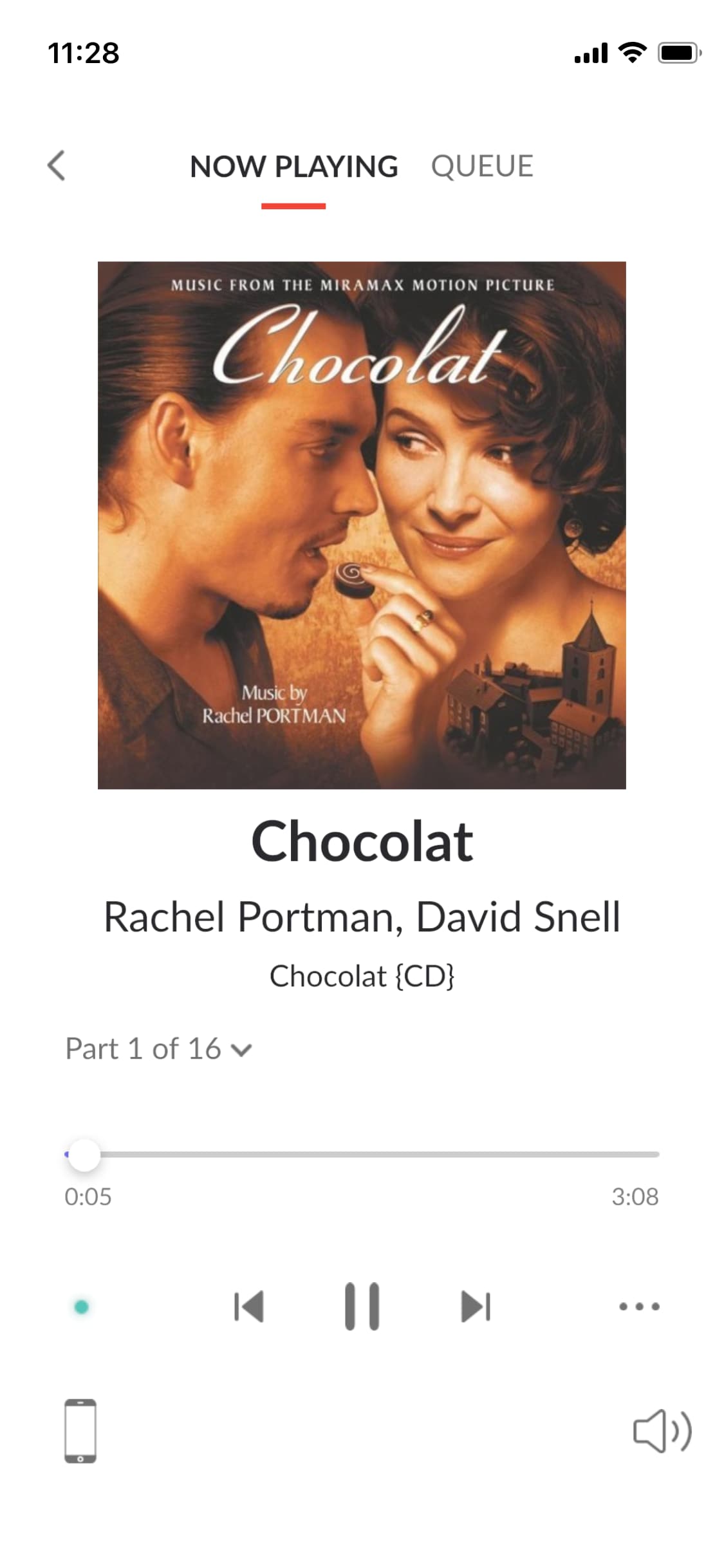

Now the third track comes up and here the problem occurs, it plays the whole composition

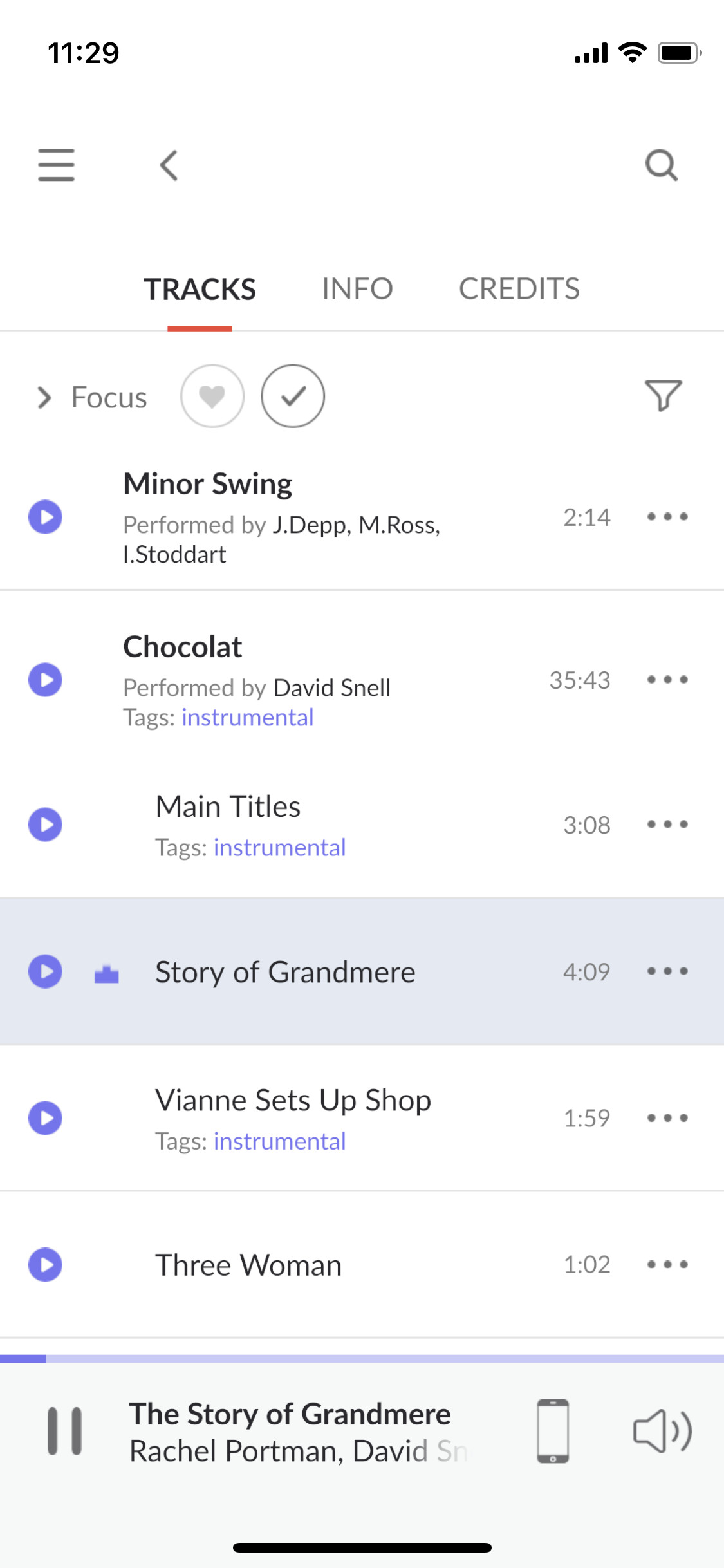

If I go the album you can see I have only tagged the tracks “Main Titles” and “Vianne Sets Up Shop”. But since this is a multi-part composition Roon adds the whole composition to the tag and that is wrong.
