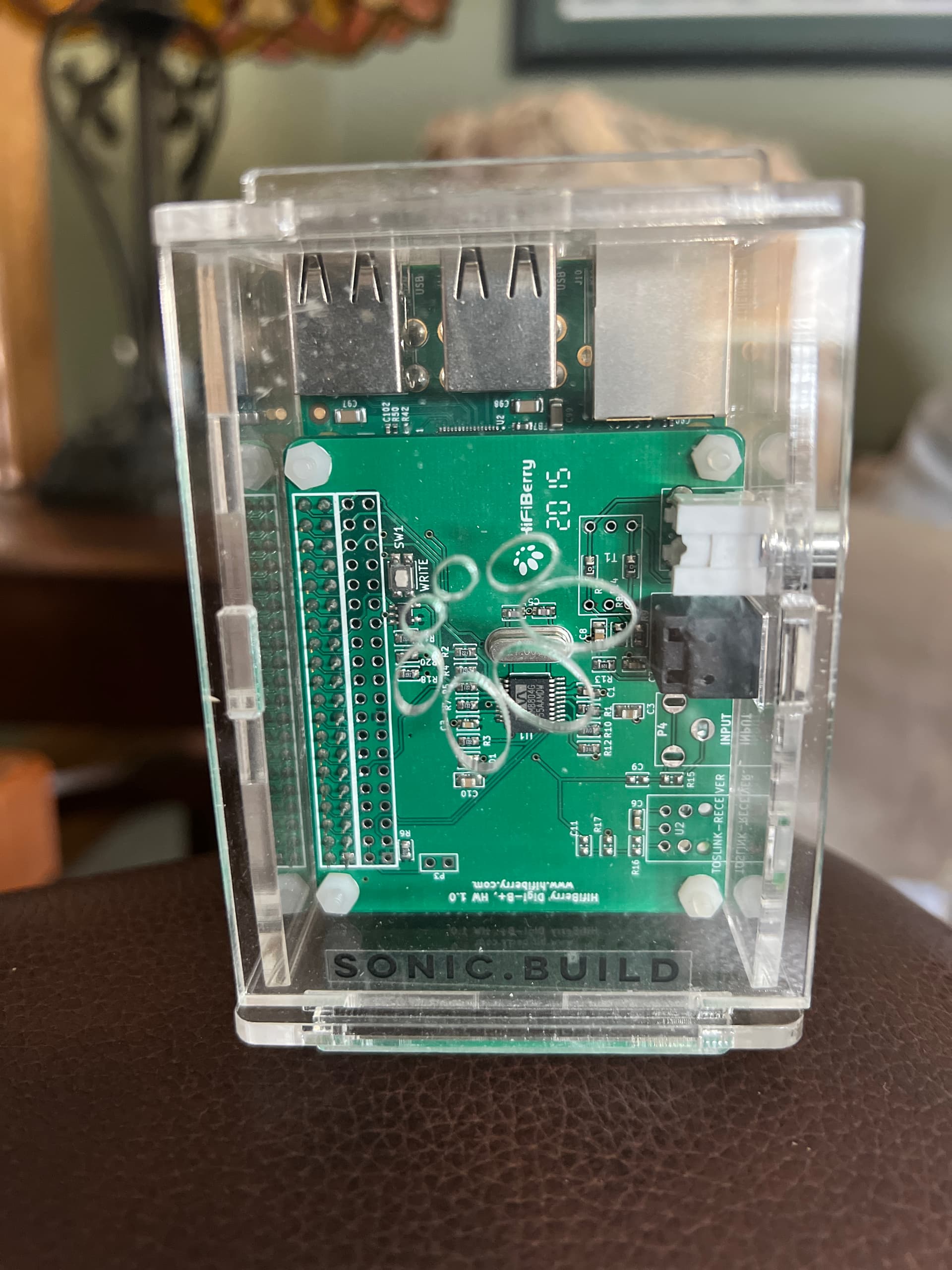

I bought this a couple of years ago. I attempted to use it with ROON with the core on a PC. I controlled it on an iPad. It did not work so I stopped. I then was told to add a Schitt Modi. I am attempting to add the core to a PC laptop. I have Yamaha cx-a5100 integrated amp.

This is one of the more confusing questions I have read :slight_smile: Can you clarify a bit? Does the Sonic Build Pi have anything to do with your current question? (Seems not because you stopped using it)
It looks like Sonic Pi is some sort of Synth based on Raspberry Pi?

Raspberry Pi’s can be setup as a “Roon Ready Endpoint” aka a Streamer or Bridge.
This would connect to your Network and then to the Modi.
This allows you to use Roon without the Modi being tethered to the core via USB.
So for example you wouldn’t need to have the PC in your listening room.
Some would argue this also improves sound quality.
To do this you need to load an operating system such as
https://ropieee.org/
on the Raspberry Pi.
But whether your Pi is able to do this I don’t know.
Hopefully someone with more familiarity with Sonic Pi will chime in.

You can still use your Raspberry Pi as a Roon bridge, but you’ll have to load Ropieee or another OS that incorporates the Roon bridge software. That will likely eliminate the ability to use the Sonic Pi software. I agree with Placebophile, just connect your Modi to the USB port on your PC or whatever you decide to use for a Roon core and you should be good to go.

David made a good point: If your Pi set up to run ropieee it will no longer function as a Sonic Pi so beware. But skip all that for now.
