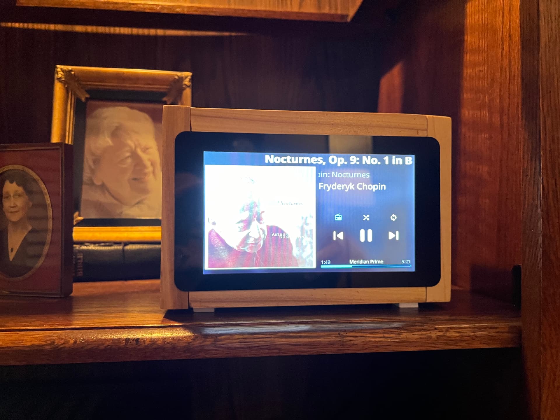

Flirc case is fine. I’m also running an RPi4 in this DIY, 1x4 inch board with open back.
My Argon One case gets hot to the touch, but DietPi reports the temp as ā€œcool runningsā€ (<40 degrees). I use it as Roon bridge, Plex server and for HQPlayer (PCM only). I’ve never heard the fan
