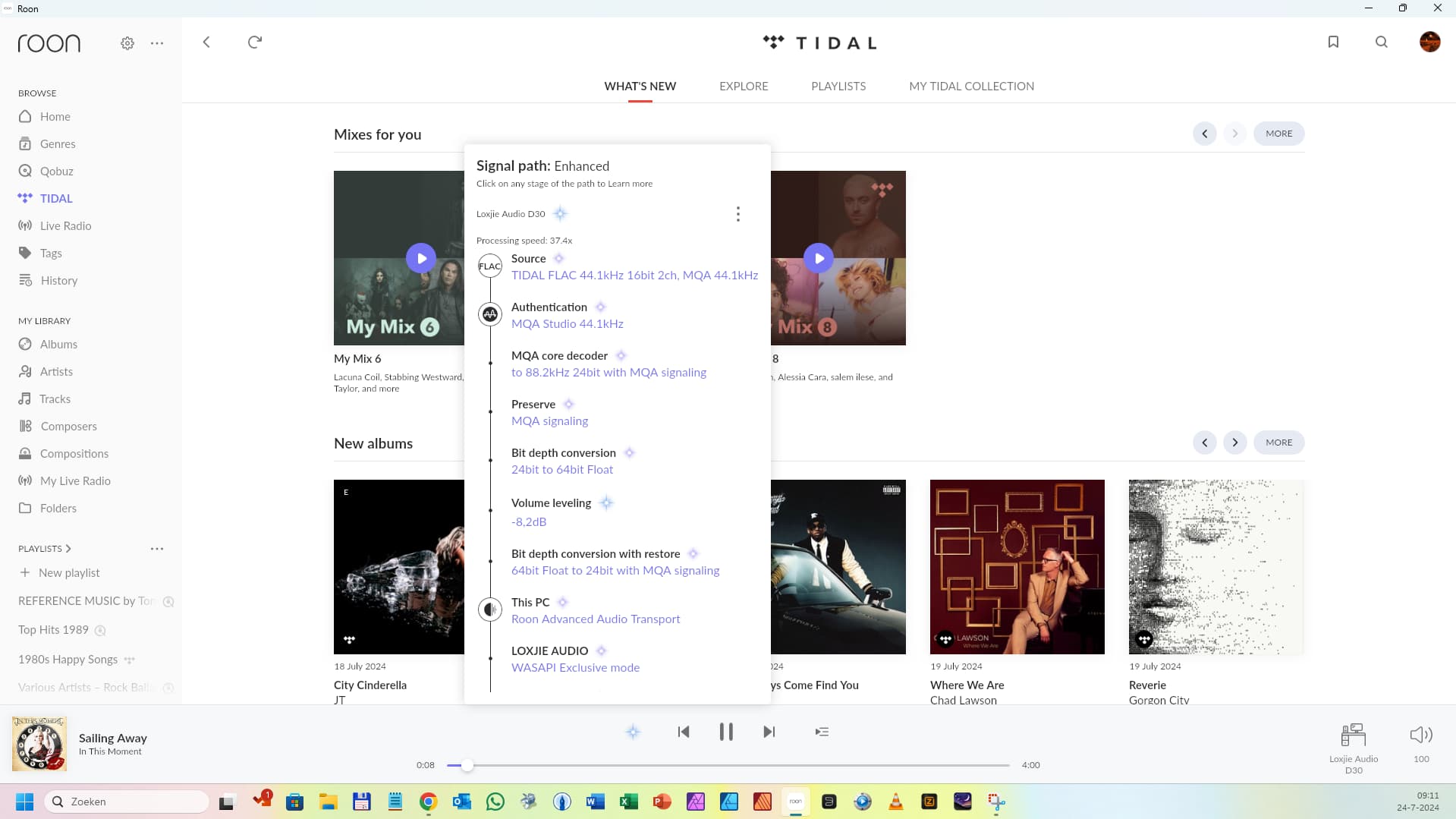

Some movement on the Tidal front. Got up this morning and confirmed that Tidal was still showing and playing on Roon and Audirvana. So i rebooted my Computer so that i would get fresh logins and unfortunately Roon is still showing and playing MQA Files, however Audirvana is now completely clear of MQA Files.
Hopefully Roon will update shortly.
Audirvana - MQA gone
Roon - Still withy MQA

Think is was wrong. Thru roon, still seeing MQA files but not thru Tidal app. Looks like could be tagging issues as well. Some MQA tagged albums are now showing as lossless once played. But still think a few MQA got left.
Take a look at Roon’s signal path. It will show you exactly what is playing. For me its easy to see as my DacMagic 200M shows different colors on its LEDs. White for PCM/FLAC. Green, Blue and Magenta when it comes to MQA.
Yes, I have looked at the path. It’s inconsistent. Some tagged as MQA are still showing MQA and others now showing as lossless Flac. If not cleared up soon, I just stick with Qobuz.

Still getting MQA on roon.
Yeah me too as of today August 10. Is it just a tagging issue? I didn’t think so because it still MQA in the authentication field.
No, TIDAL is still serving up MQA, but is no longer marking it as such in its own apps.
