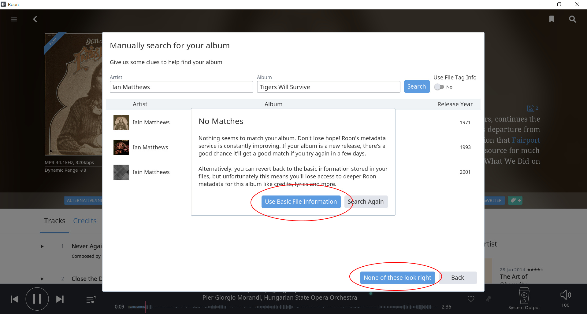

You can “unidenify” an album by clicking on the 3 dots and going through the manual identification process but just don’t accept any of roon’s suggestions until roon just drops out asking you if you want to use “basic information”. I don’t know if there is a quicker/easier way. I would be interested myself if someone knows.

On the screen what I get is somewhat different from your picture but the bottom line is that Roon tells me to come back in a few days but it does not ask me if I want to use “basic information” as you mention.
At this point this is really the issue for me I think I have not been able to “unidentify” the Album.

On your other point about unidentifying an album. If you do a manual identification and keep on clicking “none of these look right” then eventually you will get to this screen. Click on “use basic file information” and roon will un-identify your album. There may be an easier way of doing this but I don’t know what it is.
You do say that roon says “come back in a few days” so that is a bit of a puzzle. Maybe something is being lost in the translation but that is what roon says when it has failed to make an identification so it is not clear to me that you have an identified album in the first place.
It says:
When album not identifyed do not loose hope!
… try again in a few days.

That’s the first time I’ve seen a localised (foreign language) roon. So it looks a lot different than I expected. But I assume if you click on “OK” then roon will unidentify. If it doesn’t then that “OK” button is not working the same way that the “use basic file information” button works in English roon. You should end up with something similar to the following with “Unidentified” in French.
But is there any reason why you want to unidentify that Claudio Arrau album? You do not have to unidentify it if all you want to do is fix the grouping. You can edit the WORK/PART and have the benefits of an identified album as well.
