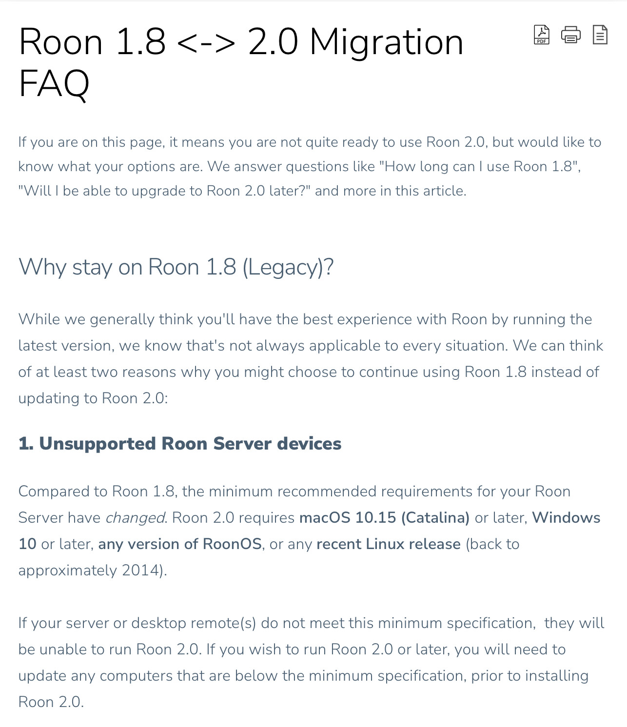

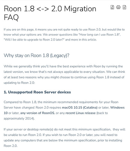

It depends on itā€™s OS version, see this Roon knowledge base article and screenshot ā€¦ but you could still use OpenCore-Legacy-Patcher to update Mac OS ā€¦
Absolutely. Only ā€œproblemā€ will be support for the MacOS that can run on that hardware. But a cheap NUC with ROCK, Will work better. Iā€™ve had the same setup as you, used headless with only Roon running on the Mac mini, but my low spec 2nd hand NUC runs much better.

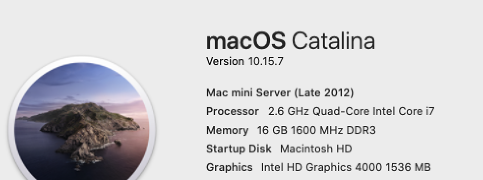

If you have Catalina on the MacMini it will be fine as a dedicated Server, running Roon 2.0 without any upgrades, as the key requirement is the SSD drive.
