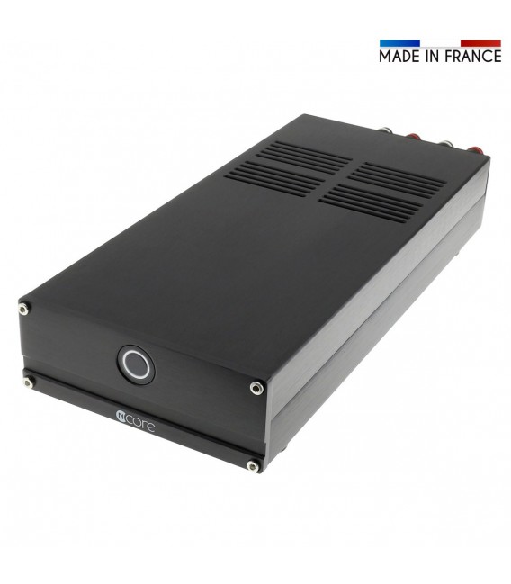

This has been bugging me ever since I found the schematic. So I finally broke down and ordered the parts for one of these nCore power amplifiers so I can get rid of the Onkyo. Still going to use digital volume control, but this time in the DAC, where it belongs.
Also pure mode bypasses room correction and subwoofer
FWIW, audiophonics.fr sells a completely assembled version of that amp for €391 (ex VAT). That’s pretty competitive with the DIY cost (but lacks the excitement of plugging in the DIY version for the first time and seeing whether you wired the mains connection correctly :slight_smile: )
Yes, looks like a good layout, power switch on the front.
Actually, 2 power switches.
  • A standard rocker switch on the back, and
  • a push-button with LED on the front.
There’s also a 12V trigger, if you have a preamp you want to control it with.
