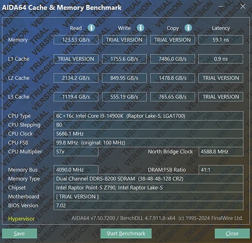

Raptor Lake doesn’t support CUDIMM. They will work without CKD. But they will waste your money and they have absolutely terrible timings. Go Aida for fun… 9400 is slower than my 8000…
My 8000

Okay. Doesn’t look as bad as I expected. Have you run any proper memory tests? TM5, Karhu or y-cruncher?
no
i plug and play
i never mess with ram oc before and read not much minimal improvement
8200 is really overclocking. With those tests you would see that they are definitely not stable. With memories that are not stable you will only break your headphones and your hearing. If you are not interested in tests and tuning, you should stay at 6000Mt/s. XMP is always overclocking.

It’s the hardest of all. Start TM5 1usmus.cfg it will give you hints where the problem might be. Also download HWiNFO to see your memory temperatures, over 45c usually produces errors and it is reached in tests really easily.
Here is a link to unlock TM5 error codes
edit. you can skip the whole y-cruncher completely. And be satisfied and confident that there will be no really strong spikes if you get TM5 and Karhu through. Then remember not to use the machine during the test and turn off the screen shutdown in the power management for the duration of the test.
TM5 with 1usmus. Remember 25 cycles about 2.5hrs
