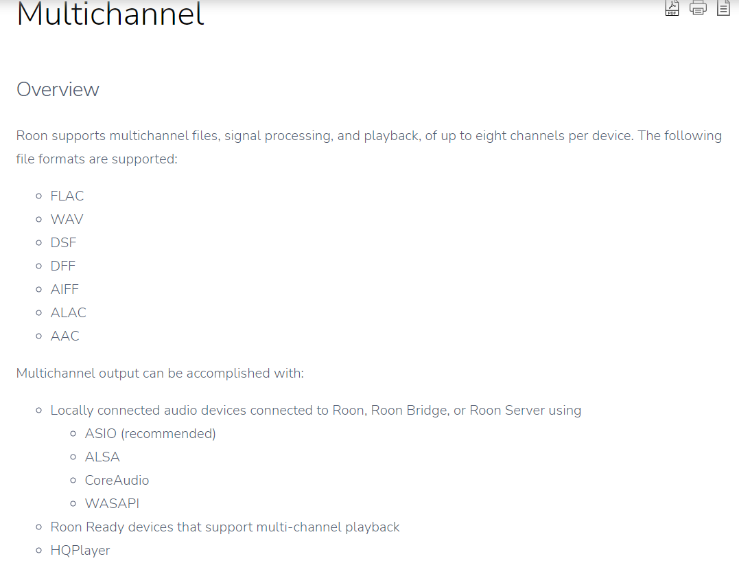

–MD
To read all of Roon’s knowledgebase article, click here.
And yes, the manufacturers are to implement RAAT it in their firmware - have you asked Zidoo about their missing Roon Ready multi-channel DSD capability, yet?

Roon has their own network streaming technology called Roon Advanced Audio Transport (RAAT). It already supports multichannel audio and it even lets you remap channels before the stream hits the network. That’s all Roon needs to do. So, this isn’t a Roon issue. Their part is done… they support the bitstream the device needs to decode the multichannel audio.
I’ve been looking for an “easy” solution for years. There is no easy or cheap solution here. The Zidoo Neo Alpha looks close… Have you asked why they don’t present multi-channel to Roon? They would need to fix this not Roon. Roon already supports it but it’s the Zidoo telling Roon that the device is only 2-channel.
