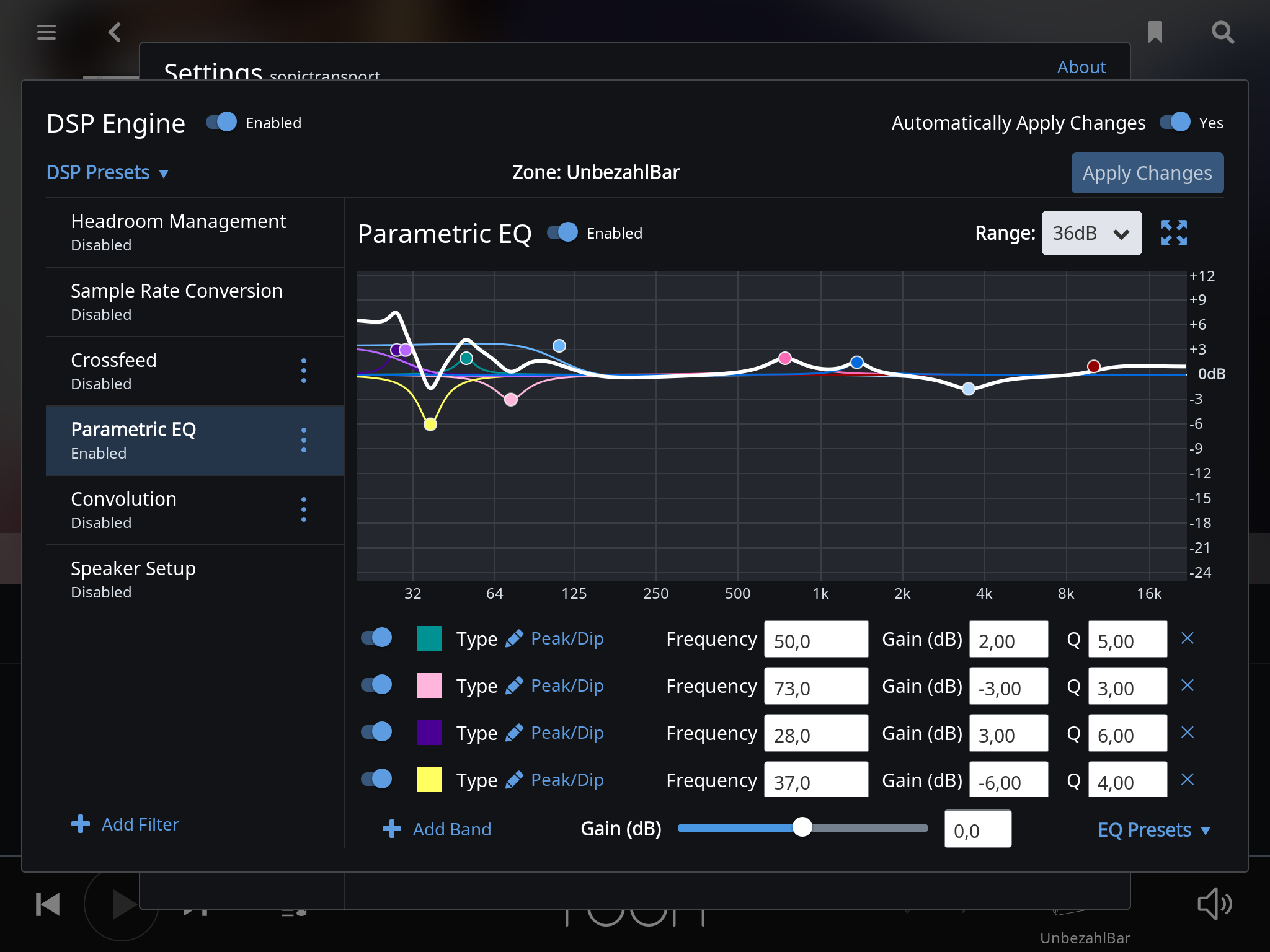

With PCM files the EQ works, also with DSD files downsampled to PCM.

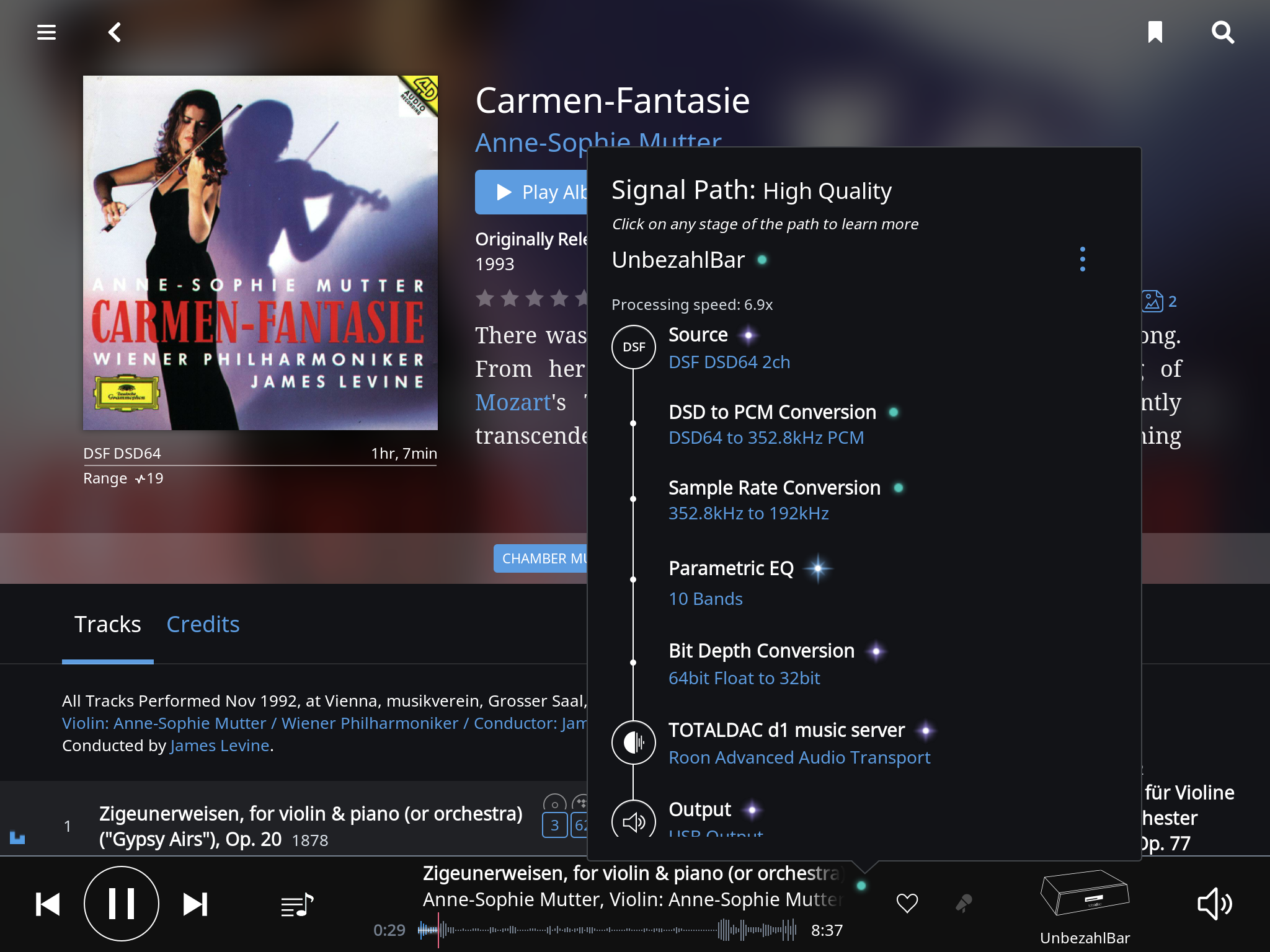

The EQ just doesn’t work with DSD files. When I downsample DSD to PCM, what I understand as an additional load for the CPU, it works. I get a 7x speed with downsampling and EQ:

I can upsample to DSD without any problem…
