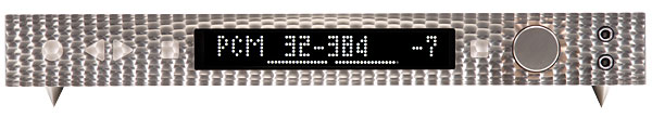

Merging NADAC+Player, slightly over budget so you would need to negotiate a deal or look at the used market.
Will the NADAC do DSD 512 ? They talk about 256 over Ethernet but didn’t see 512.
