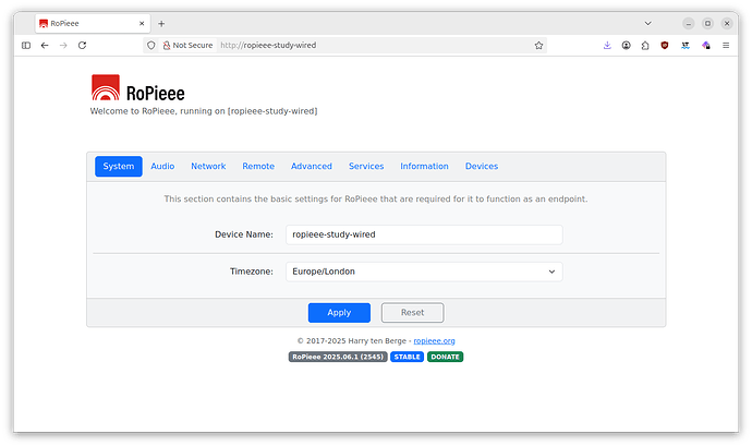

Go to http://ropieee.local, and change the device name. For example …

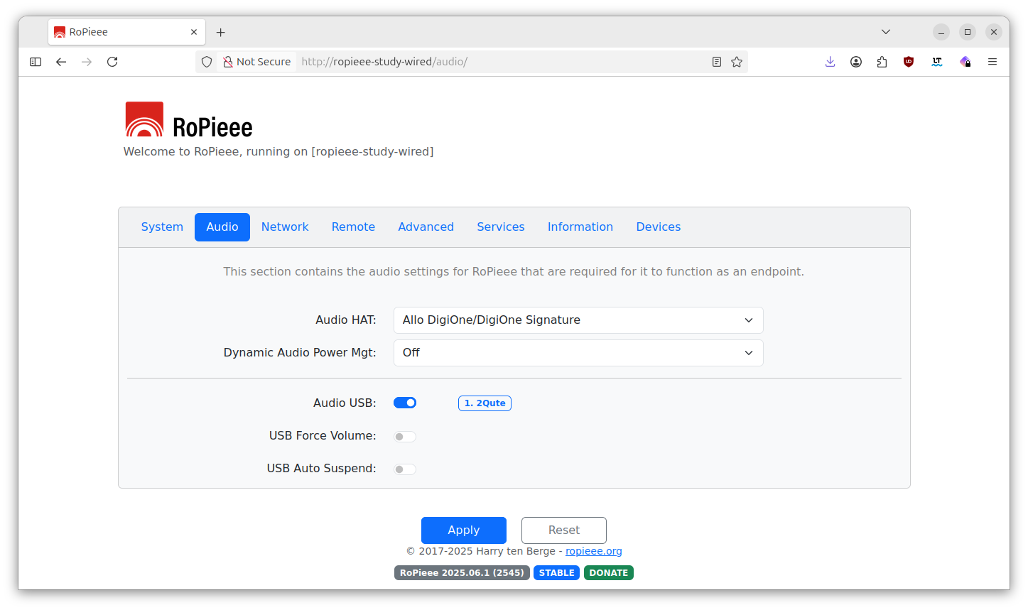

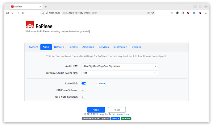

After Ropieee is reconfigured, and reboots, type in the new link the browser will redirect to the new link, e.g., http://ropieee-study-wired.local. Then, go to the Audio tab, and set up the Allo DigiOne.
Repeat this for the other RPis, and give each a unique name.
That’s not even necessary, RoPieee these days will navigate automagically to this new url after configuring/rebooting :wink:
