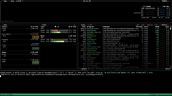

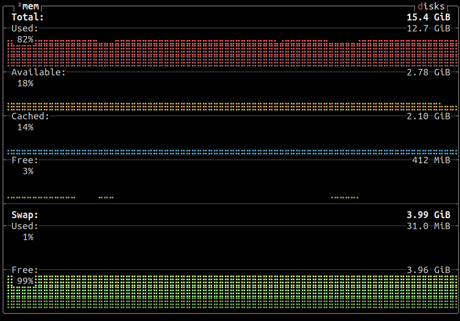

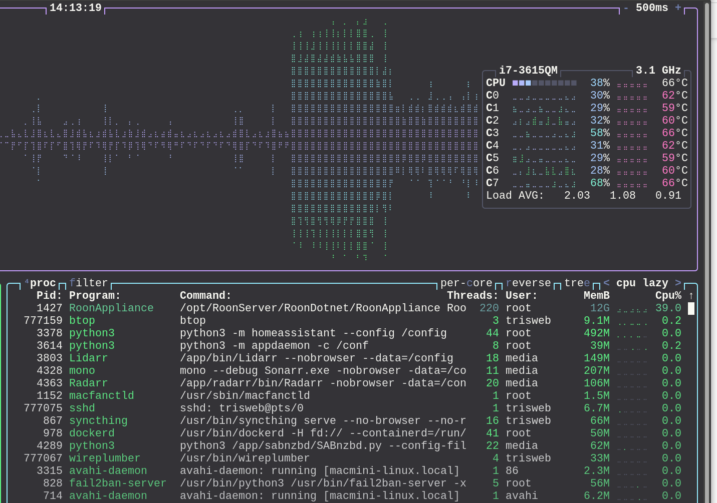

It is still happening. It just took nearly 3 full minutes for Roon to start playback (Startling me again, because at some point you forget you tried)
Notable points: memory is actually ever-so-slightly down ¯\(ツ)/¯
Note the ominous stepwise increase of idle CPU load. This gonna be droppy as hell again shortly.
@Robem Swap is still nonexistent as it should:
No time-correlated (network) events that I can see.

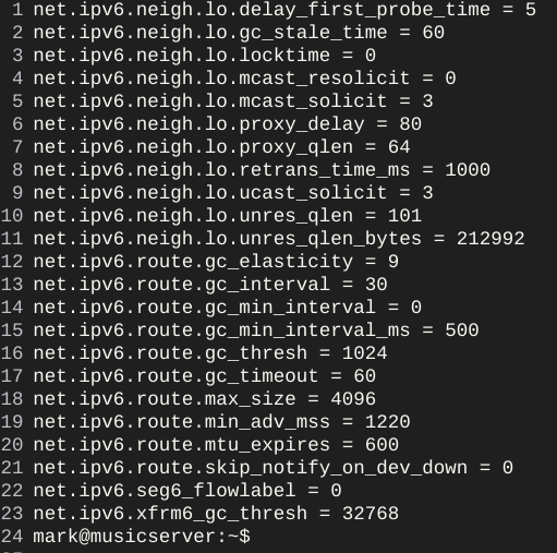

Hi @S_Heeren ,
Thanks for the additional details and testing you’ve done here. I am still in active communication with our developers trying to get to the bottom of what is causing this behavior for some of our users. Our devs have asked if you could kindly share the output from the following Terminal commands with us:
sysctl net.ipv6
ifconfig
@noris much appreciated
Here it is:

net.ipv6.neigh.enp1s0.ucast_solicit = 3
net.ipv6.neigh.enp1s0.unres_qlen = 101
net.ipv6.neigh.enp1s0.unres_qlen_bytes = 212992
net.ipv6.neigh.lo.anycast_delay = 100
net.ipv6.neigh.lo.app_solicit = 0
net.ipv6.neigh.lo.base_reachable_time_ms = 30000
net.ipv6.neigh.lo.delay_first_probe_time = 5
net.ipv6.neigh.lo.gc_stale_time = 60
net.ipv6.neigh.lo.locktime = 0
net.ipv6.neigh.lo.mcast_resolicit = 0
net.ipv6.neigh.lo.mcast_solicit = 3
net.ipv6.neigh.lo.proxy_delay = 80
net.ipv6.neigh.lo.proxy_qlen = 64
net.ipv6.neigh.lo.retrans_time_ms = 1000
net.ipv6.neigh.lo.ucast_solicit = 3
net.ipv6.neigh.lo.unres_qlen = 101
net.ipv6.neigh.lo.unres_qlen_bytes = 212992
net.ipv6.neigh.virbr0.anycast_delay = 100
net.ipv6.neigh.virbr0.app_solicit = 0
net.ipv6.neigh.virbr0.base_reachable_time_ms = 30000
net.ipv6.neigh.virbr0.delay_first_probe_time = 5
net.ipv6.neigh.virbr0.gc_stale_time = 60
net.ipv6.neigh.virbr0.locktime = 0
net.ipv6.neigh.virbr0.mcast_resolicit = 0
net.ipv6.neigh.virbr0.mcast_solicit = 3
net.ipv6.neigh.virbr0.proxy_delay = 80
net.ipv6.neigh.virbr0.proxy_qlen = 64
net.ipv6.neigh.virbr0.retrans_time_ms = 1000
net.ipv6.neigh.virbr0.ucast_solicit = 3
net.ipv6.neigh.virbr0.unres_qlen = 101
net.ipv6.neigh.virbr0.unres_qlen_bytes = 212992
net.ipv6.neigh.wlp2s0.anycast_delay = 100
net.ipv6.neigh.wlp2s0.app_solicit = 0
net.ipv6.neigh.wlp2s0.base_reachable_time_ms = 30000
net.ipv6.neigh.wlp2s0.delay_first_probe_time = 5
net.ipv6.neigh.wlp2s0.gc_stale_time = 60
net.ipv6.neigh.wlp2s0.locktime = 0
net.ipv6.neigh.wlp2s0.mcast_resolicit = 0
net.ipv6.neigh.wlp2s0.mcast_solicit = 3
net.ipv6.neigh.wlp2s0.proxy_delay = 80
net.ipv6.neigh.wlp2s0.proxy_qlen = 64
net.ipv6.neigh.wlp2s0.retrans_time_ms = 1000
net.ipv6.neigh.wlp2s0.ucast_solicit = 3
net.ipv6.neigh.wlp2s0.unres_qlen = 101
net.ipv6.neigh.wlp2s0.unres_qlen_bytes = 212992
net.ipv6.route.gc_elasticity = 9
net.ipv6.route.gc_interval = 30
net.ipv6.route.gc_min_interval = 0
net.ipv6.route.gc_min_interval_ms = 500
net.ipv6.route.gc_thresh = 1024
net.ipv6.route.gc_timeout = 60
net.ipv6.route.max_size = 4096
net.ipv6.route.min_adv_mss = 1220
net.ipv6.route.mtu_expires = 600
net.ipv6.route.skip_notify_on_dev_down = 0
net.ipv6.seg6_flowlabel = 0
net.ipv6.xfrm6_gc_thresh = 32768

Came upon this thread looking for the culprit of my 12GB resident Roon server and high CPU every 15 minutes.
It seems to have started on upgrade to Debian 12 Bookworm, so potentially a library update or change of some kind there. Or it could have just been the restart.
Def some kind of process that takes a minute or two spinning up every 15 minutes, potentially with a memory leak in it.
My graph in Home Assistant that warned me:
And the culprit (p.s. love all the btop in this thread)

Thanks for sending over those outputs @S_Heeren /@airdronian . I’ve forwarded your results to the dev team for further review, I will let you know once I have further feedback to share.
Sounds good. Let me know if I can supply anything else.
