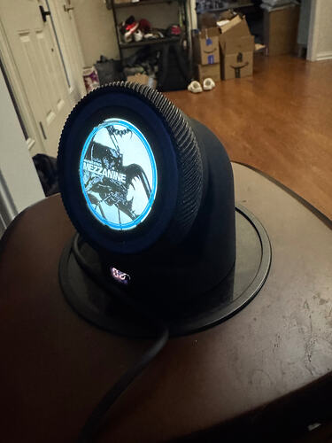

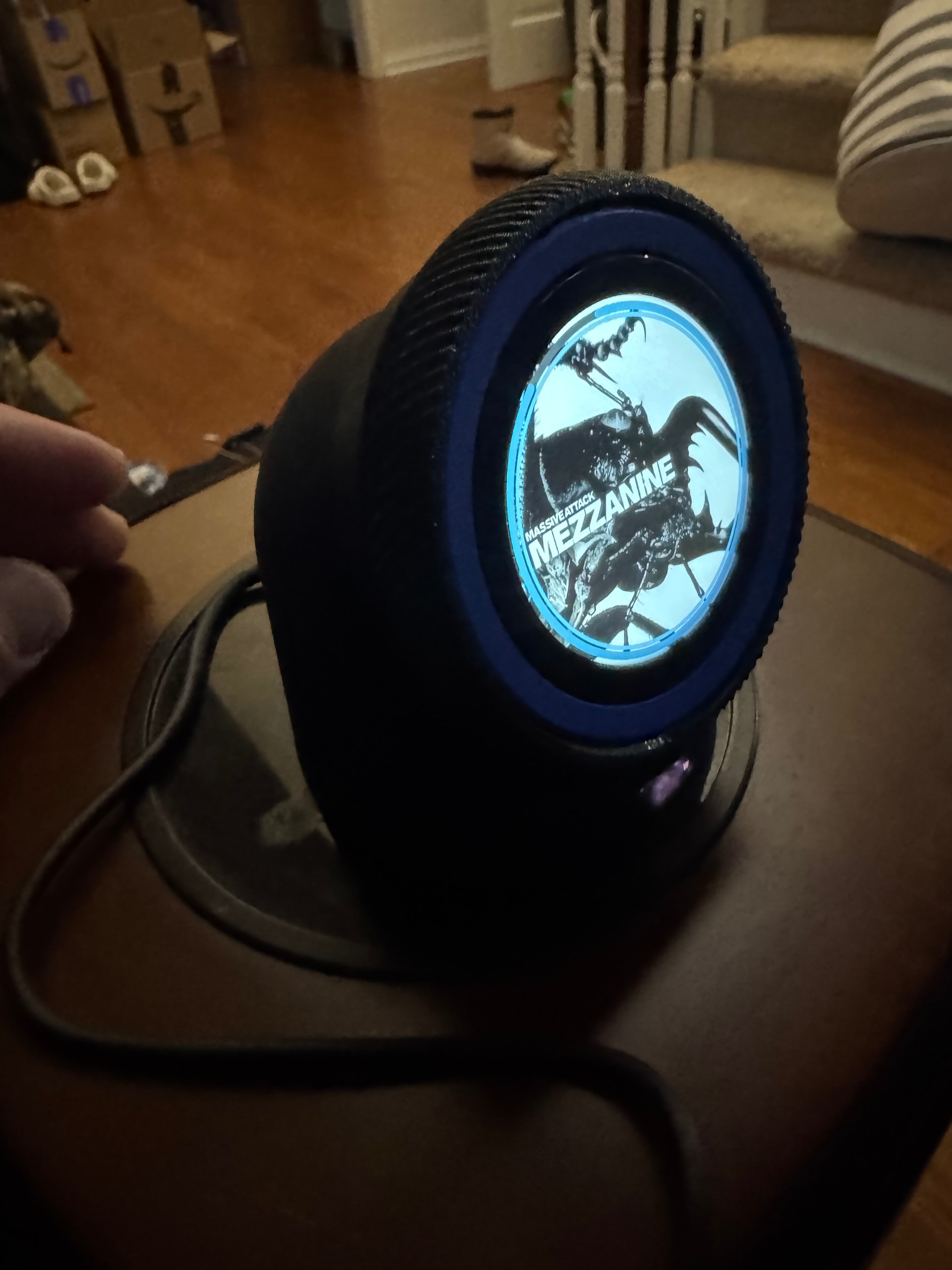

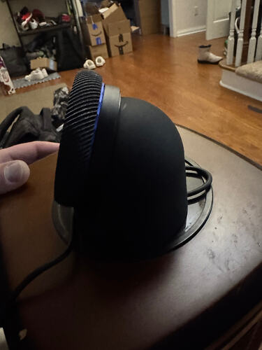

Got mine and uploaded photos $50 ESP32-S3 Knob Hifi Controller - #396 by Muness
Oh you tried it! It’s a pretty cool little dock. Oddly, when I swap USB cables besides the supplied one charging doesn’t work at all.
But the form factor is perfect for this knob and I’m keeping it!
I had purchased this thing to turn an old Pixel phone into an always on Roon controller. But this knob works way better for this.
