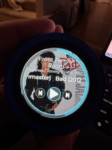

Inspired by the rooExtend controllers, I built a custom firmware + roon extension bridge to be able to control Roon using a Waveshare ESP32-S3 Knob into a dedicated Roon controller.
See this video demo from an earlier release.
Features
  • Real-time now playing with album artwork
  • Volume control with dB display (turn the knob)
  • Play/pause and prev/next (buttons to tap)
  • Art mode - full-screen album art (swipe up/down)
  • Multi-zone support (with a zone selector)
  • Automatic display dimming and sleep

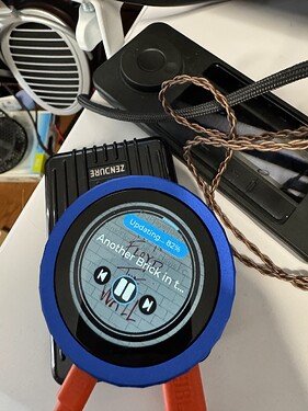

  • Over-the-air firmware updates that are shipped with the extension.

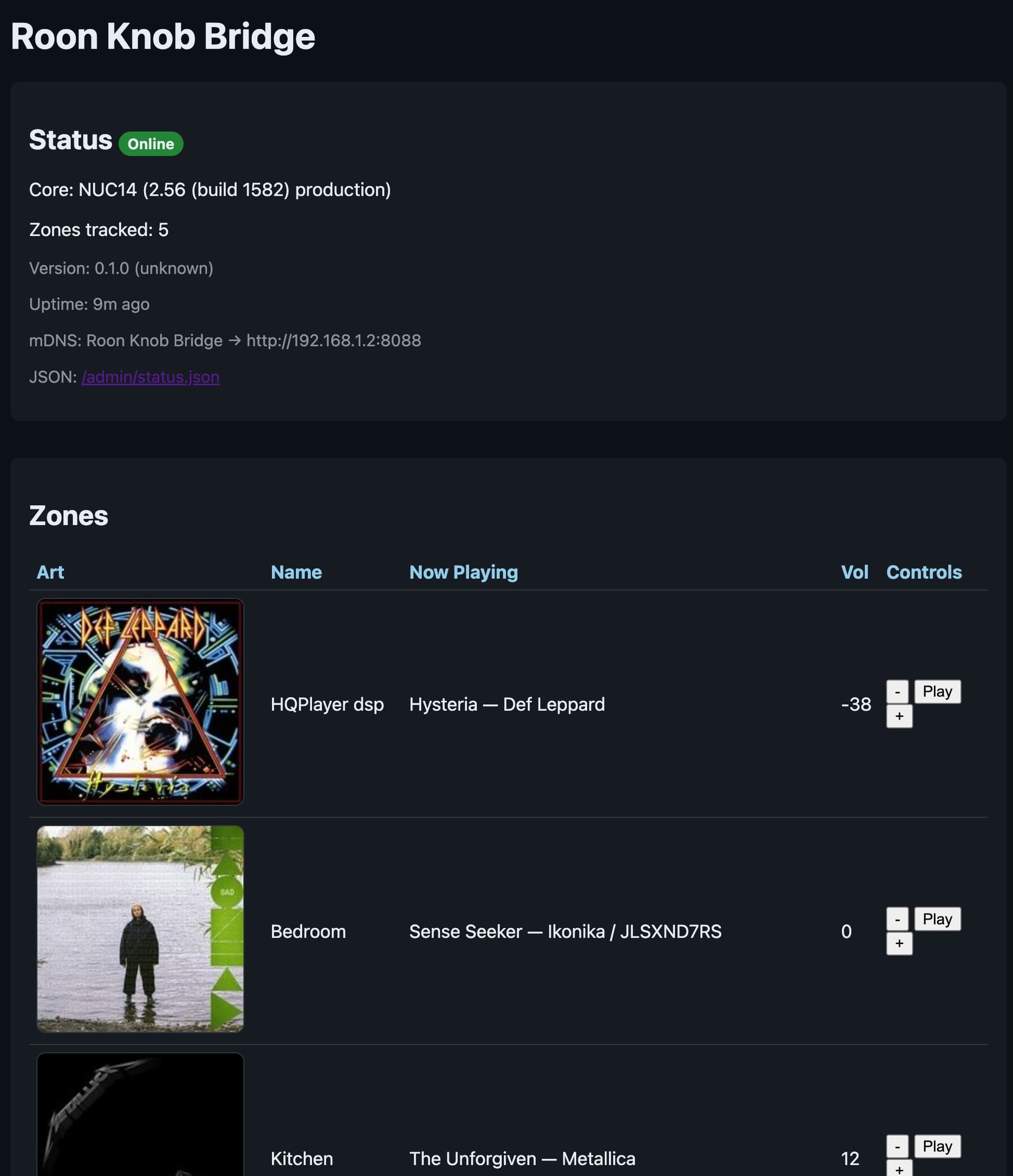

Roon Extension Bridge screenshot

  • The bridge is running and working - I can see in it’s logs that it’s aware of events on the Roon server. Your post shows a UI for the bridge but I’m not sure how to access it. Is it on 8080? Doesn’t seem to be. I’m not using host network for the bridge, I use a macvlan and the bridge has its own IP. I don’t see how that would be an issue.

Also, I think you may have a bug with how your bridge is handling your service port. I set it to 80 but it’s actually listening on 8088 according to the logs, and that’s the port that I can actually connect to. I see this in the docker log:
> roon-knob-bridge@0.1.0 start
> node app.js
fatal: not a git repository (or any of the parent directories): .git
[2025-12-12T19:20:05.797Z][Sidecar][INFO] Starting server {"version":"0.1.0","git_sha":"unknown"}
Setting up sood
Starting sood
[2025-12-12T19:20:05.821Z][Sidecar][INFO] Listening on 8088 {"service_port":80,"base":"http://03a79980a99f:8088"}
Also…dang, sir. You can code. This was a ton of work!

Got home and it worked with my beta firmware (while on the road, and without a Roon controller handy, I decided to make it a Bluetooth controller too). I’ll put out a release in hopes that I’d already fixed the issue you saw in the 1.2.12
@Muness - I see the new release but I don’t understand the flashing instructions in your release notes.
On this page, it says to flash, then flip the usb-c cable, then flash something else.
The only artifact is your .bin file. So what’s the actual flashing requirement?
Thanks
Ah! I need to add the ESP32 firmware (the knob has an ESP32 and an ESP32-S3. I was only using the one).
Working on wifi debugging improvements, will fix this as well.
