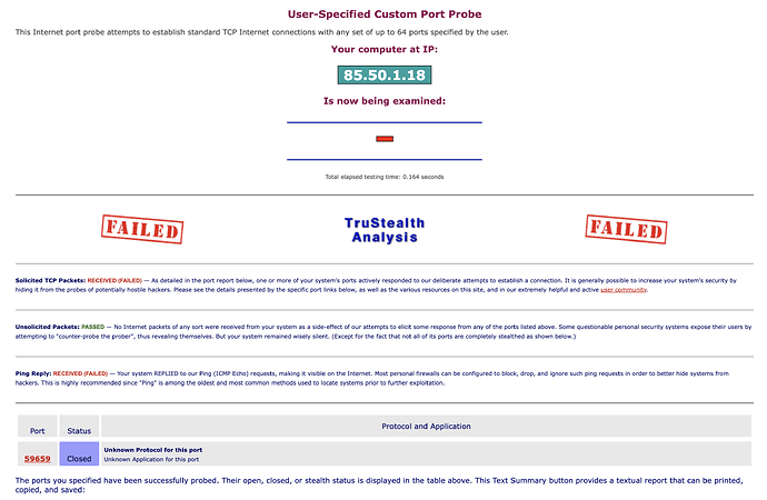

Hi
I tried the shieldsup site.
It saw my fixed IP
The report on my roon port was:
RC Port Authority Report created on UTC: 2023-04-13 at 16:03:27
Results from probe of port: 59659
0 Ports Open
1 Ports Closed
0 Ports Stealth
1 Ports Tested
THE PORT tested was found to be: CLOSED.
TruStealth: FAILED - NOT all tested ports were STEALTH,
- NO unsolicited packets were received,
- A PING REPLY (ICMP Echo) WAS RECEIVED.

er…no. It looked like this:
