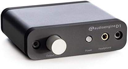

would something like this work?
starting to see i will have to buy something to transmit to my A9 instead of my IMAC?
Shouldn’t think that will work. It’s just another DAC, it doesn’t have optical out and it isn’t a Roon endpoint.
