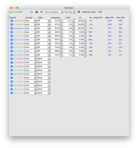

After reading a lot in this forum, the 37.5 Hz mode needs to be corrected. REW suggests dampening with about -11 dB and a Q around 12. I think this is reasonable. I read in many room EQ forums that dips can’t be reasonably handled, so I first want to target the 37.5 Hz hump, eventually also the 91 Hz peak. Therefore, I don’t really want to export EQ to a wav file and load it into Roon’s DSP panel. Rather I’d like to manually target the room modes with the Parametric EQ tab. Roon however, accepts Q values of up to 10. Is this a different scale Roon uses, or is it just the algorithm’s limit it can handle? Plugins like Fab Filter Pro Q allow much higher Q settings.

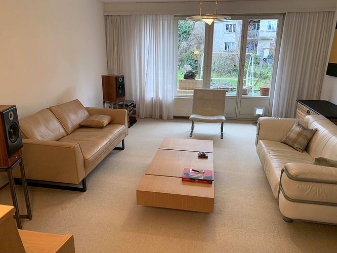

Looks a bit strange to me! How exactly did you do the measurements? Could you post a picture of you room and speakers?

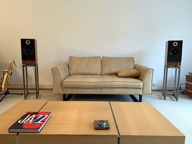

Here are two pictures of the room/speakers. Speakers are ATC SCM 19 and they are approx. 150 cm from the side walls and about 50 cm from the rear wall.
Hope this helps.

So I averaged all measurements and set the target to 70 dB. I basically get filter settings that dampen a number of target frequencies (see attachment) but wouldn’t boost anything. My question is: which filter settings are required in the ‘Filter Tasks’ pane for ‘Individual Max Boost’, ,Overall Max Boost’, and ‘Flatness Target’ to lift regions in the bass and above.
Individual boost is how much a single filter can boost, max boost is how much all filters together are allowed to boost. Flatness target is how flat REW will try to make the curve, and I often use 3 to allow some irregularities and make sure REW don’t overcompensate (the curve wont look as good but will probably sound better).
But here is where a little trial and error comes into play. There is no absolutes about the sound you like, only opinions. So try to boost everything to the target, and try to limit the boost or even fully prevent it, and see what you like best.

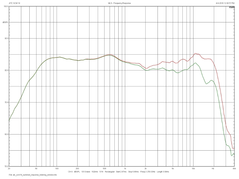

Here is a measurement I found of your speaker, done in an acoustically dead room:
Based on this picture, I would be cautious to boost anything below 80Hz.

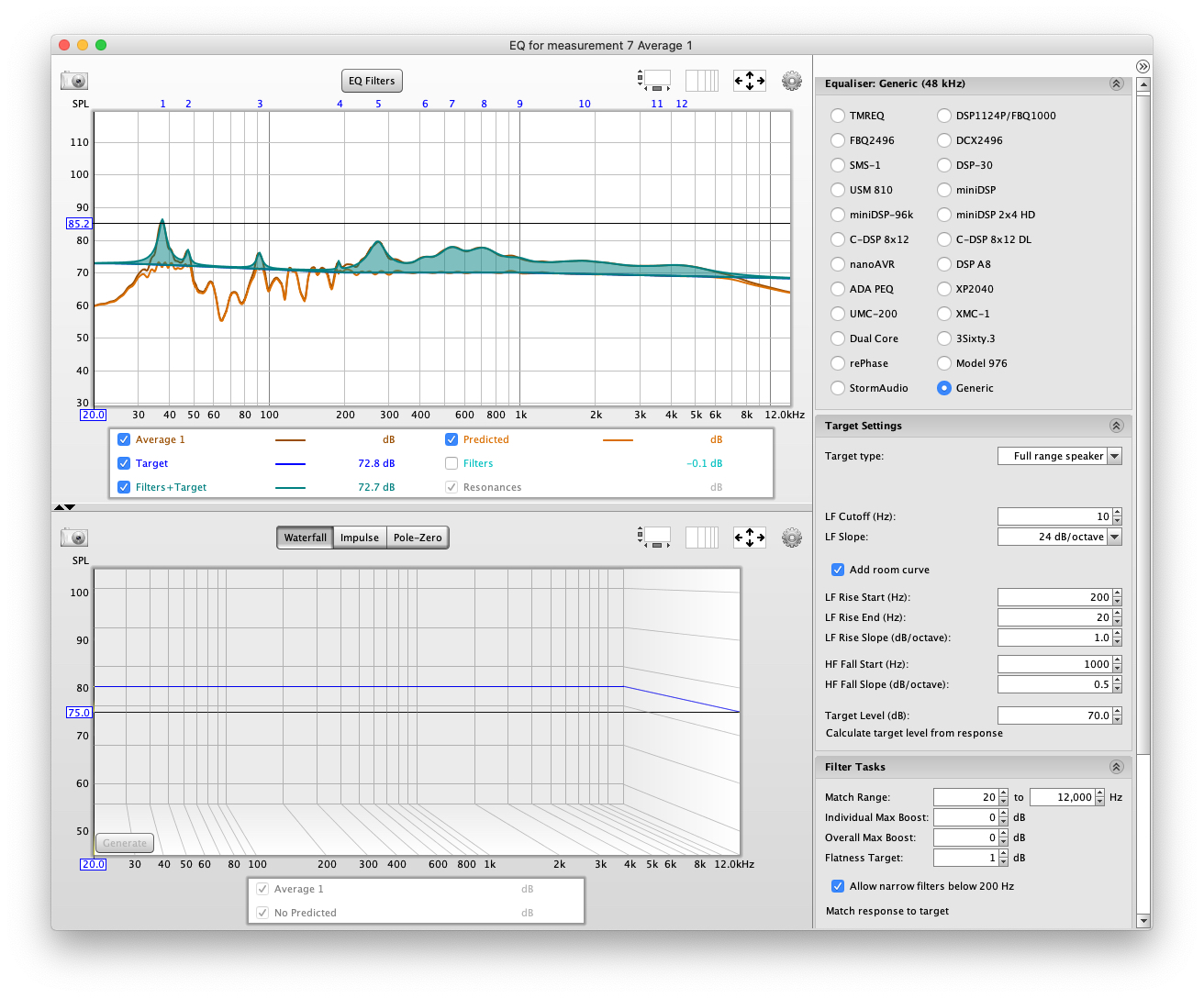

So I had the target set to 70 dB, and flatness target to 3 dB, while individual/overall boost were set to 0 dB just to avoid any boost below 80 Hz. Here’s the response curve and the filter settings. Does that look somewhat all right? Nevertheless, the restriction of max Q in Roon remains, correct? What happens if I’d export the filter settings to a wav file and let Roon use this. Would the corrections still be lemited within Roon’s constraints?
You could allow some boost in the 100 to 200 region, so maybe set match range from 90 and allow boost. I would also make a little more HF slope although that’s more of a personal preference.

Its the speakers, ATC are excellent speakers but somewhat limited in bass. Look at the frequency response picture I posted above for the ATC SCM 19 speakers. Then you get a big peak in bass due to room nodes, which can be (as seen in his measurement) well below what the speakers typically can manage.
