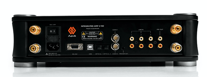

there is no ethernet on Aavik U-180, you need a device with RAAT SDK or a comp with roon bridge, or connect directly to the comp running core

It’s an amp, not a streamer, it can’t be Roon Ready. And it does have USB input. Now whether those Tesla coils actually do anything useful is another question.
On the other hand while the digital input is probably sufficient for all real purposes, 24/192 and up to DSD128 over USB isn’t exactly state of the art…
Hey, I’ve got an integrated amp with a built-in DAC, and it is Roon Ready, as well. Just saying, for that much money, you could get more. Like an Ethernet jack.
As for that USB port, I think it’s just USB-A, for plugging thumb drives into.

There’s even a picture of the backside a few messages above. It’s a USB-B port, and the spec sheet does say that it is a digital audio input… Whether it is actually worth $10 grand is another question.

Yes, I see it now. My mistake.
