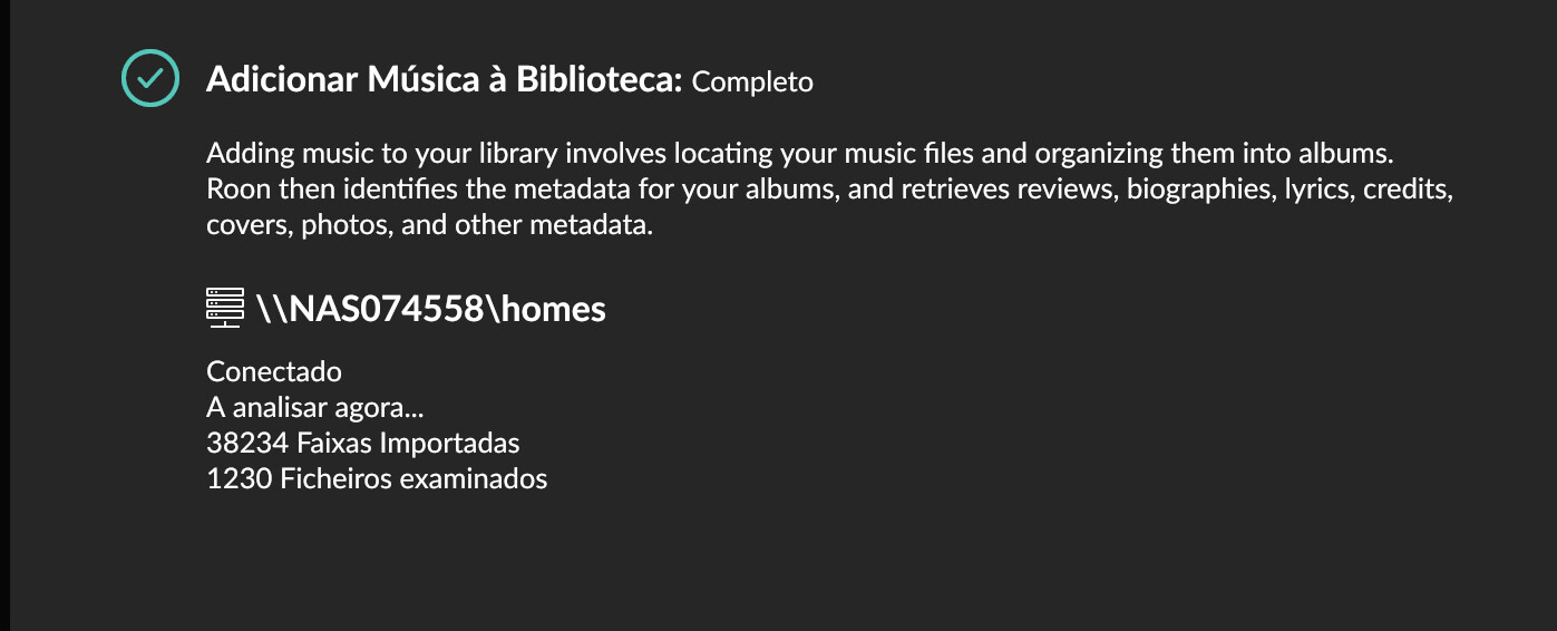

Adding Music to the Library, (too long) process
This process takes almost one hour in my NucleusPlus to process my half million files. But the bigger problem is that, while it runs, Roon gets annoyingly slow, making navigating through the Music Library almost impossible.
Is there any way of
  • preventing it from starting?
  • pausing it?
  • schedulling it?
That would be nice.
Thanks
Rui Ribeiro

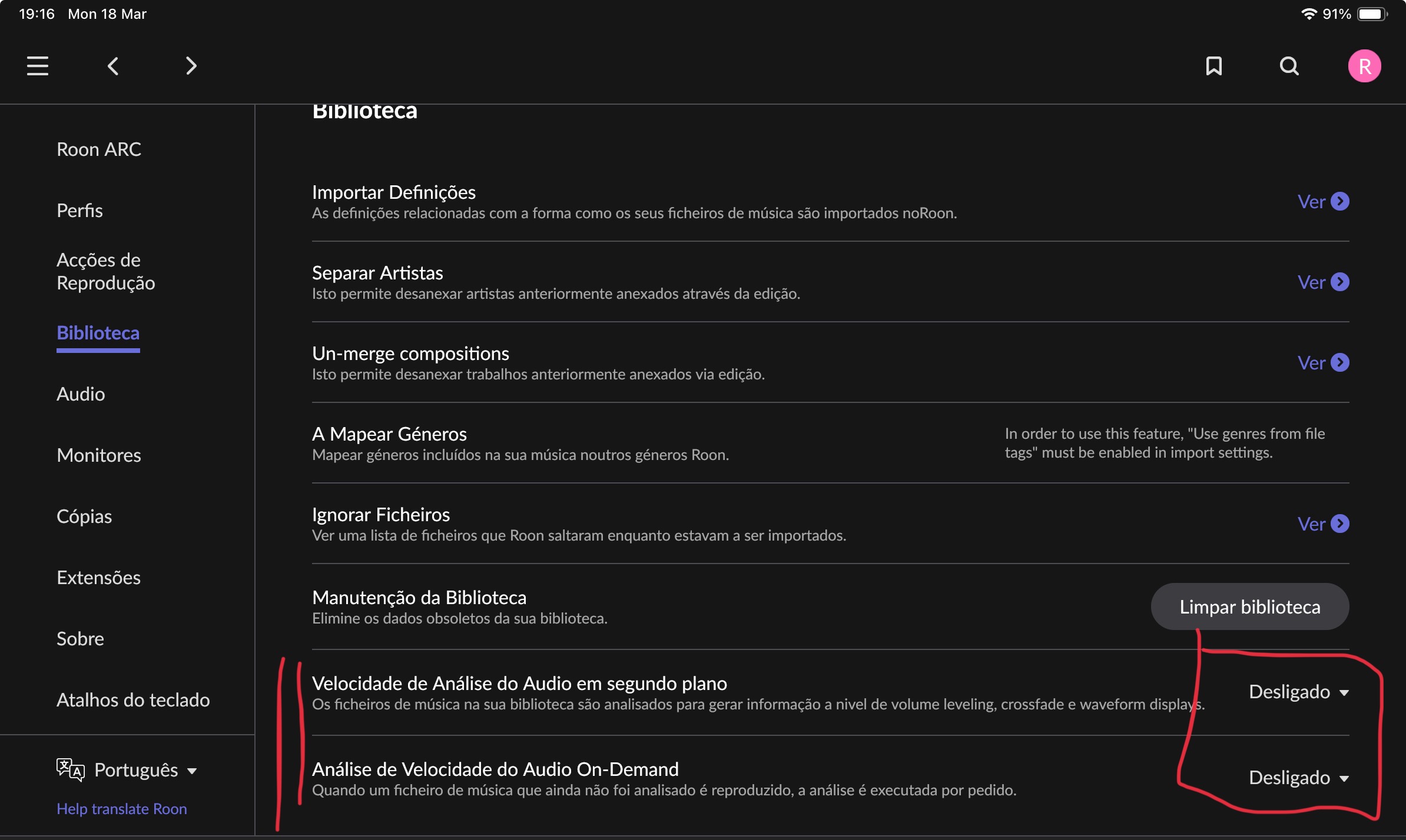

That would be great and precisely what I am looking for. But please, where is that miraculous SETTING ?
Settings > Library
Thanks a lot for the advice. I must be absent minded because I looked everywhere for that Setting
These are my Library settings a long time ago. The ones I thought could be related are Switched Off. Is there any other relevant ?
I would turn on „on demand“ or nothing will ever get analyzed.
But if turning off the background analysis doesn’t help, then it wasn’t the real or the only problem
Shall I switch ON the last one, that saying OnDemand , as Acelerated for exemple? It has been always switched off in my case, don’t tell me I understood it wrongly and we must put it ON /fast or accelerated), in order to stop the process and get it only on a Demand basis…?
Background analysis, the first option, runs automatically in the background and analyzes the whole library (or when you add someone new). It can take a long time with a very big library and uses a lot of resources until it is finished.
On-demand, the second option, runs only for the tracks you play, when you play them.
