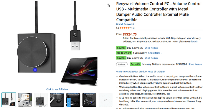

Hi, I have a USB HID volume knobs that isn’t recognized by Ropieee. Would it be possible to add support for it? The idVendor:idProduct is 413d:553a

Can someone enlighten me what this is all about?
@ntrusbak what kind of device is that?
Sorry, I just discovered a previous thread on the same topic, sorry for not using that one.
I bought a couple of these thinking they could be plugged into the Raspberry Pi endpoints running RoPieee. They don’t seem to be supported, however. They work on Windows and Ubuntu.

I’ll buy one and have a look. All the basics are in place for this.

Hi @ntrusbak ,
I’ve received the device and got it working. I’ll prepare a beta build for you to test.

Beta is out: if you want to test this then go to the advanced tab, set the update channel to ‘beta’ and follow instructions. Keep in mind: it will take a few hours before you’ll get a notification that the beta is ready to be installed.
Let me know how things are doing.
thank you @spockfish, beta received and tested.
The Renywosi remote shows up on the “Remote” page. Good start :slight_smile:
However, nothing happens when I turn or click the knob…

Have you enabled the extension?
as expected, but I think ‘generic’ is a better word than ‘unknown’ in this case.
I had not - That did the trick :partying_face:
Works like a charm. Super nice!
