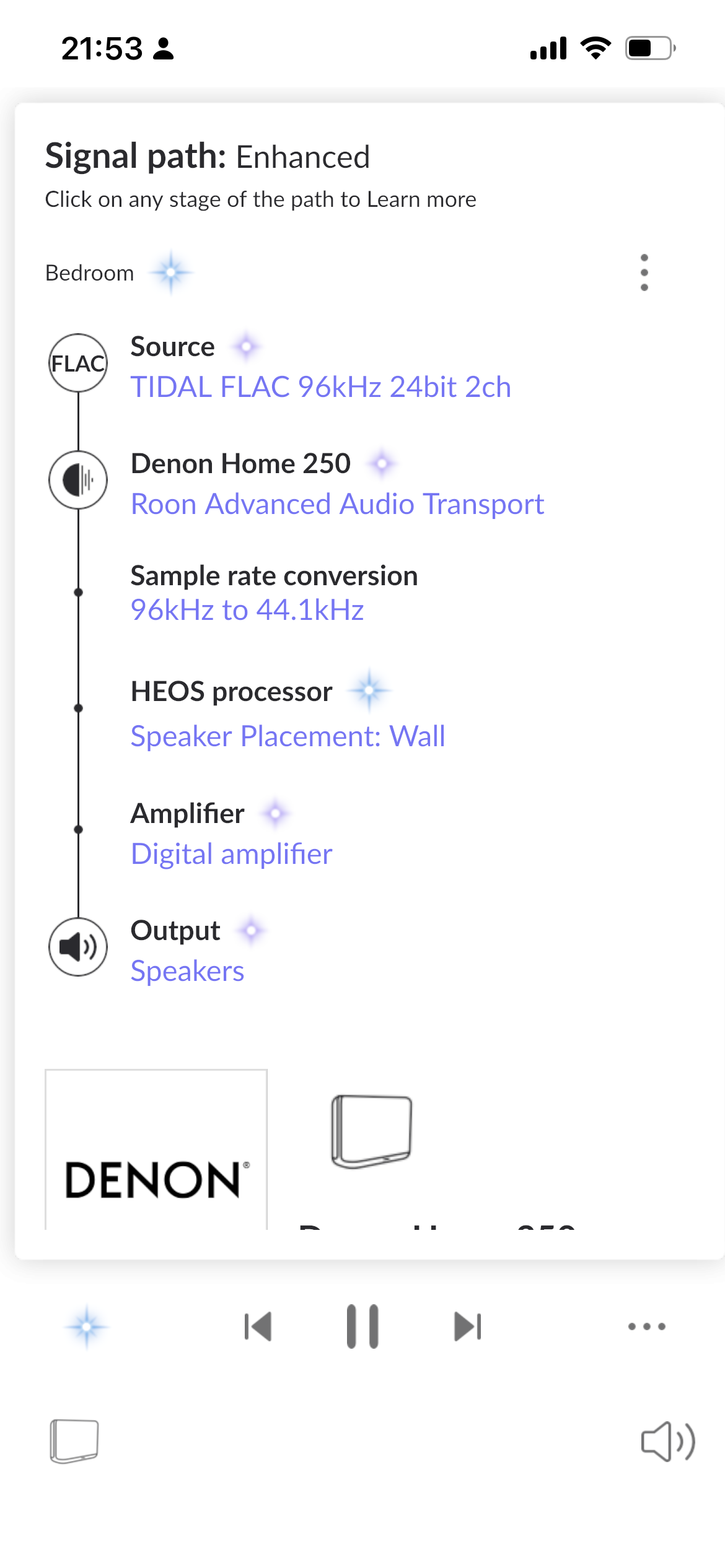

Hey there and all, I’ve noticed that when playing on the Denon from Roon the output has static and popping noises. Could this be due to some signal interference ?
No. Can you show your signal path while this is happening?
Here it is. Popping and ticks on every track. The core is a home put together small box, I wonder if I should get one of the Roon Nucleus
Is your core hard wired?
In Roon settings under the Services menu, set Tidal to HiFi (not Max) and try again.
The Home 250 is down sampling from 96 to 44.1 for some reason.
So trying it with 16/44.1 is part way to finding the cause.
I’d also try rebooting your router, Roon Server and then Home 250 in this order.
Is the Home 250 connected via Ethernet or WiFi.?
Thanks it is connected using WiFi. I have an Ethernet point in the bedroom so I could connect it to that to try and establish a wired connection to the router and then to the core.
It wouldn’t be some sort of interference from the core itself ?
Very unlikely.
I’ve encountered similar before, not just with Roon.
A reboot of everything in the chain of equipment generally resolves these kind of things.
But I’m curious if on an Ethernet connection if the down sampling stops.
