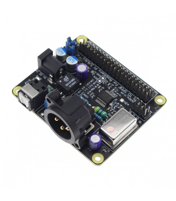

lets go that route with a Pi2AES hat… if anybody has one to sell pm me ![]()

Not sure where you are based but this AES/EBU HAT is available in France / Europe.
You’ll need to select the HiFiBerry Dig+ driver in Ropieee. General details on building a Roon endpoint with Ropieee here. Seems to work best with a RPi4 with the RPi powering the HAT (first jumper settings here).

That makes more sense then re. why you want AES/EBU output.
In that case try the Audiophonics HAT given they are based in France as well.
I am not sure where is best to source a Raspberry Pi in France or what case / enclosure will best fit the HAT + RPi but I expect Audiophonics can advise you on that.
You should just need a Raspberry Pi 4B+ (the 2GB is fine), the standard RPi power supply (it’s just a computer, no analog here) and a micro SD card (and maybe an adaptor to allow you to flash the micro SD card on your desktop computer). Might just be easiest to buy a bundle/kit. I wouldn’t use a RPi5 yet as they are not yet well supported.

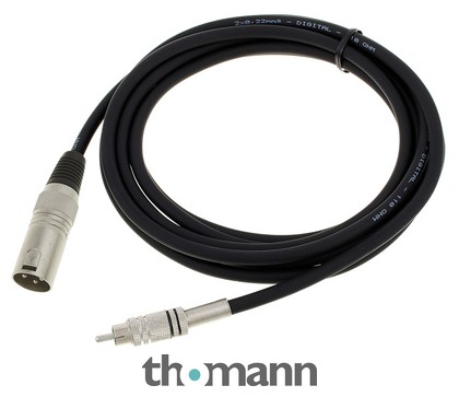

The other simple option is to use a Roon supported WiiM Pro with a S/PDIF (COAX) to AES/EBU converter.
With either:
1) An active converter
2) A simple adaptor cable
Depending on how fussy your DAC and switch is, you may even be able to get away with using a basic passive adaptor cable over a short run.
If you already have a device with an S/PDIF output you could cheaply test out whether such a passive cable would work with your existing DAC and AES switch. It will either work or it won’t and you’ll get very obvious drop outs, pops and glitches. It won’t affect the sound in subtle ways.
