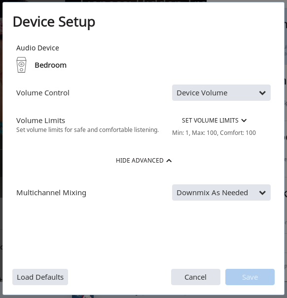

  2. Aside from 1 Drs album all my files are flac files. On the flac files I would say about 80 to 90% are 16bit 44KHz. Will have to test, but so fare the issues is with flac with 16bit 44KHz.
  3. On my network I have 1 Audio pro A10 that I can link via Air Play and works well.
    I also have linked to the Marantz SR8012 a piBerry with a digi+ pro. The piBerry is linked via a coax cable to the SR8012 internal dac, and works well.
Below the image from the device setup:
Let me know if you need mor information

So just to verify the Marantz now works on it’s own in Roon, but when grouped you’re experiencing issues? Can you share a screenshot of device setup for the Audio Pro A10?
Hi @dylan
Yes, currently when grouping both devices over Airplay I am having the same issue. The setup is the same has in the Marantz. See below:
