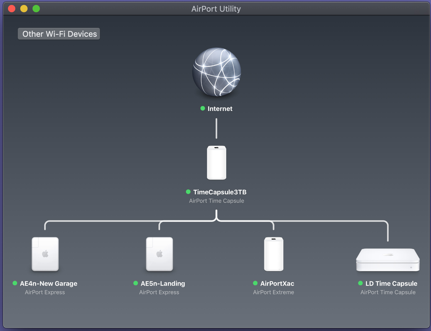

  2. Airport Utility showing the AEs with the NEW names

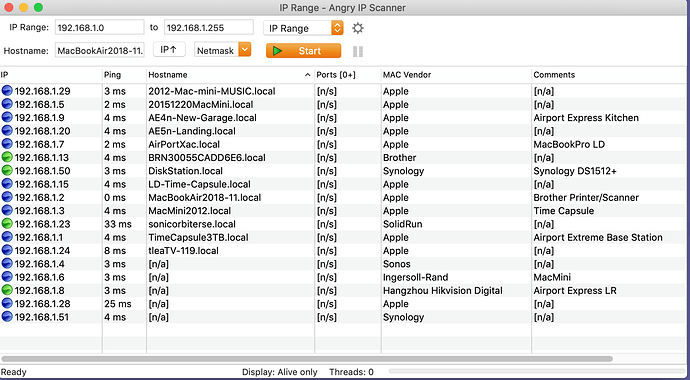

  3. IP report showing the addresses of everything on the LAN. Roon Core runs on 192.168.1.29; AE4n is at 192.168.1.9 and AE5n is at 192.168.1.20.

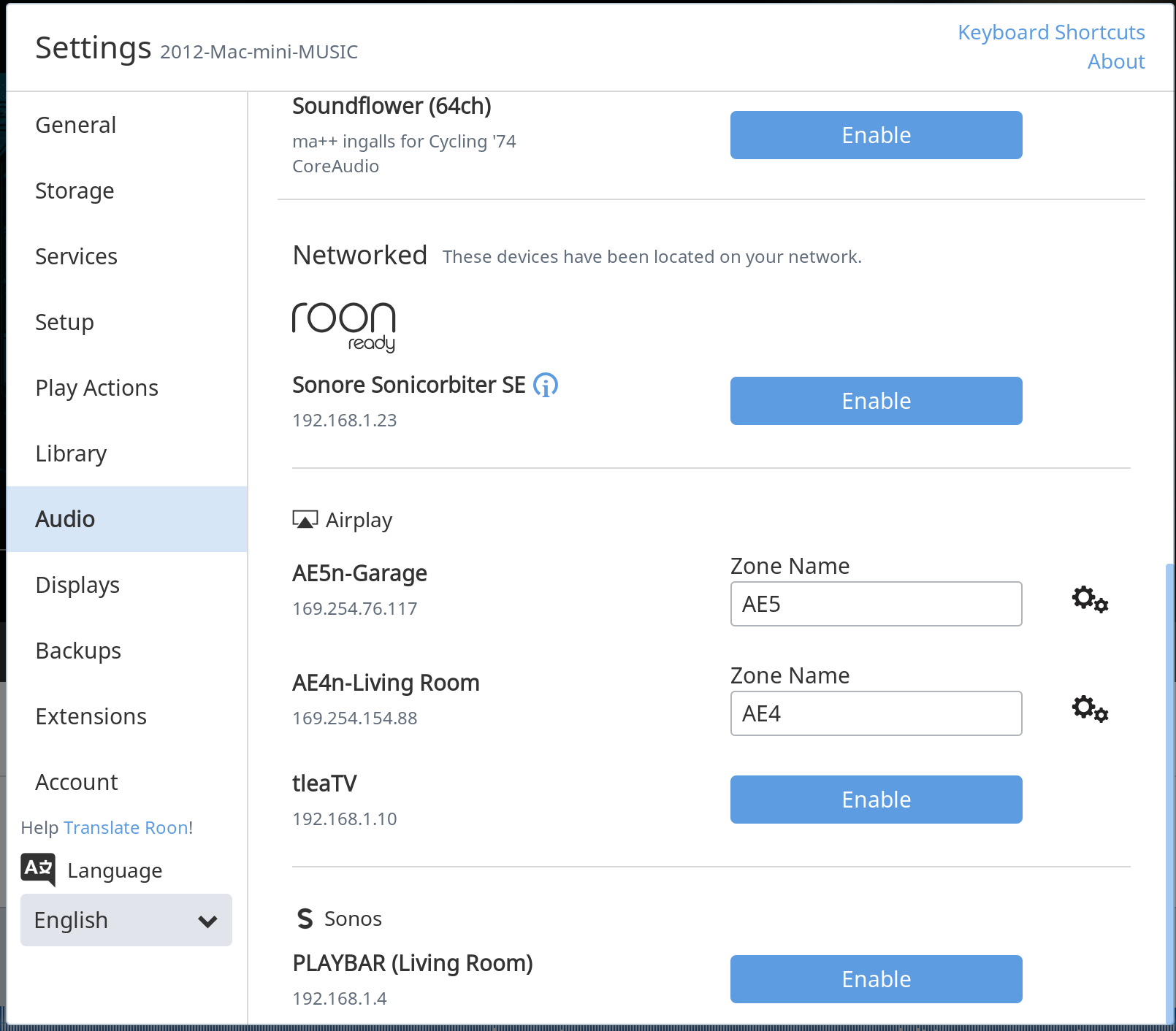

Okay, that sorta worked. The two AEs still show up in Roon with the wrong names and IP addresses, but at least I can stream to them.
Is there not a way to delete (not disable, but delete) or rename audio devices? Clearly Roon has remembered the old names even though the rest of the LAN recognizes the new names.
I’ve attached a screenshot. Notice the phantom 169.254 IP addresses. The actual IP addresses are 192.168.1.xx

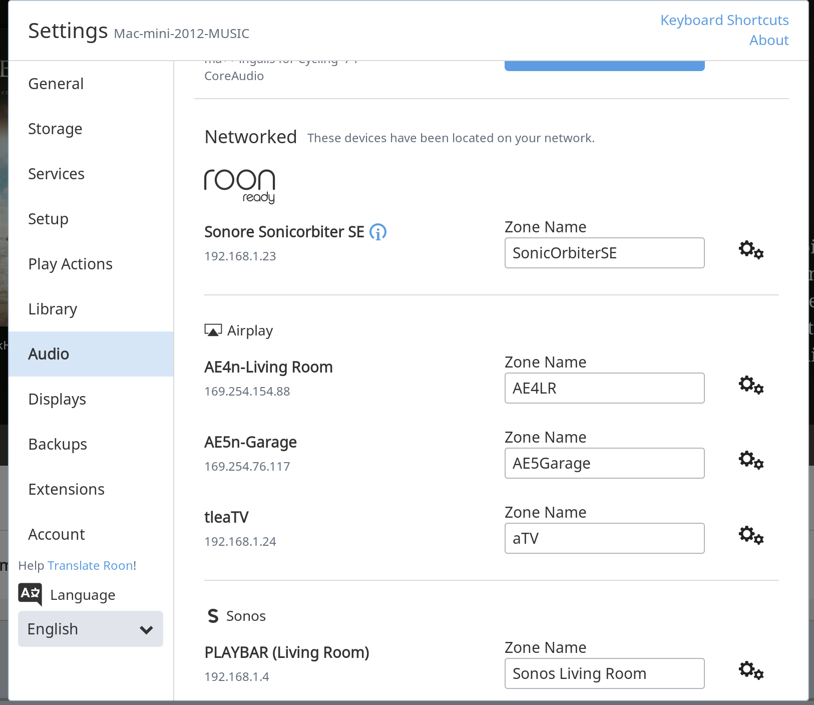

  1. In Airport Utility, in addition to changing the name of the Base Station you must also change the name of the AirPlay speaker. D’oh.
  2. When I tried to do this through a wireless connection I got an error message. I had to do it through an hard-wired Ethernet connection. Strange but true.
  3. Even after rebooting everythjing: Core computer, router, each endpoint, and RoonServer, the IP addresses of the endpoints still show up incorrectly in Roon (169.), But maybe that will resolve with time and it doesn’t affect usability so I am ignoring it.

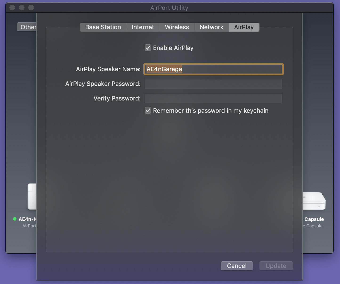

To change the name of the AirPlay speaker (aka Airport Express):
From AirPort Utility click on the base station in the flowchart, click Edit and enter the password if prompted.
Click the AirPlay tab and enter the new AirPlay Speaker Name
Click Update and the unit will restart.
Note that it is possible for the AirPlay Speaker name to be different from the Base Station name, although it’s unclear to me why that would be necessary or desirable. Roon understands only the AirPlay Speaker name, not the other one, which led to some confusion on my part.

In Roon, click Settings>Audio and scroll down to Networked Devices to see the new name.
Or click the audio device in the lower left corner and the new name will appear in the list of Zones for selection.
The perfectionist in me finds it mildly troubling that Roon is reporting an incorrect IP address for the renamed endpoint, but everything functions correctly so far so I am trying to get over it.
