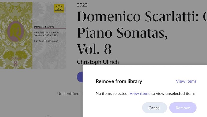

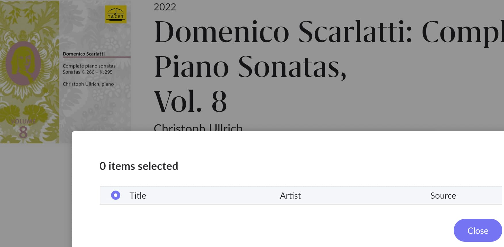

I looked at albums in Roon with Qobuz Library ON and discovered the album, and was able to open it (once only) and take some pictures. The “remove from library” option was displayed, but didn’t work.

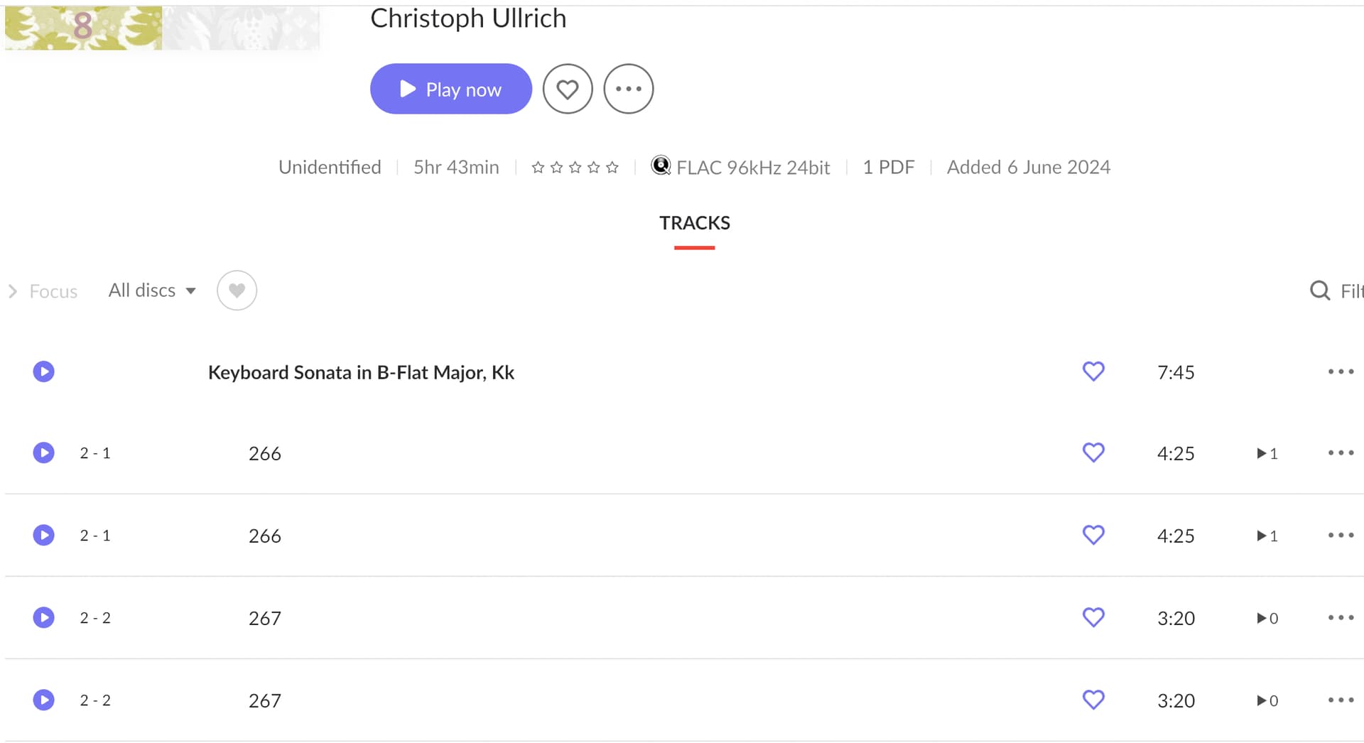

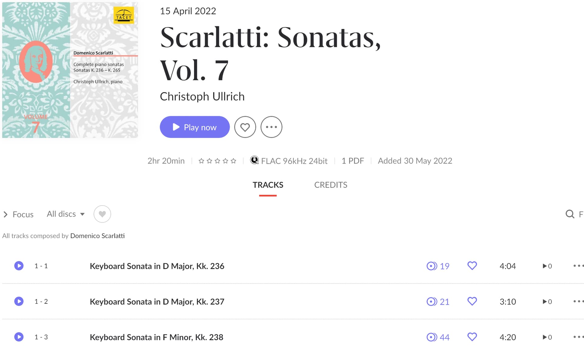

You can see how long it is at over 5 hours. Also the display is weird with repeated tracks. It should look like the last picture which shows a closely related album. It seems quite likely that I can never play the download I bought since this contaminates it. However, that is better than losing all the metadata in doing something drastic.

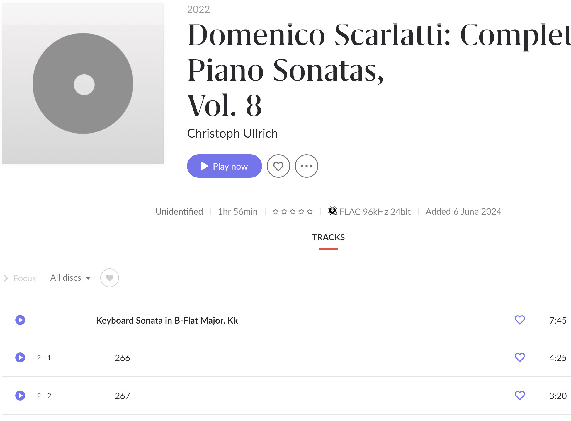

I tried turning off Roon, turning off the Nucleus, turning on the Nucleus, turning on Roon, and this time got the apparent Qobuz favourite, but smaller! Same messages come up if I try to remove from library, presumably because it isn’t in the library really.
I should add that, when I could see the album, it showed the tracks looking fine through to Disc 1-30, then it started over with a Disc 2 and two duplicates of each track. The appearance–the spacing–was different.
