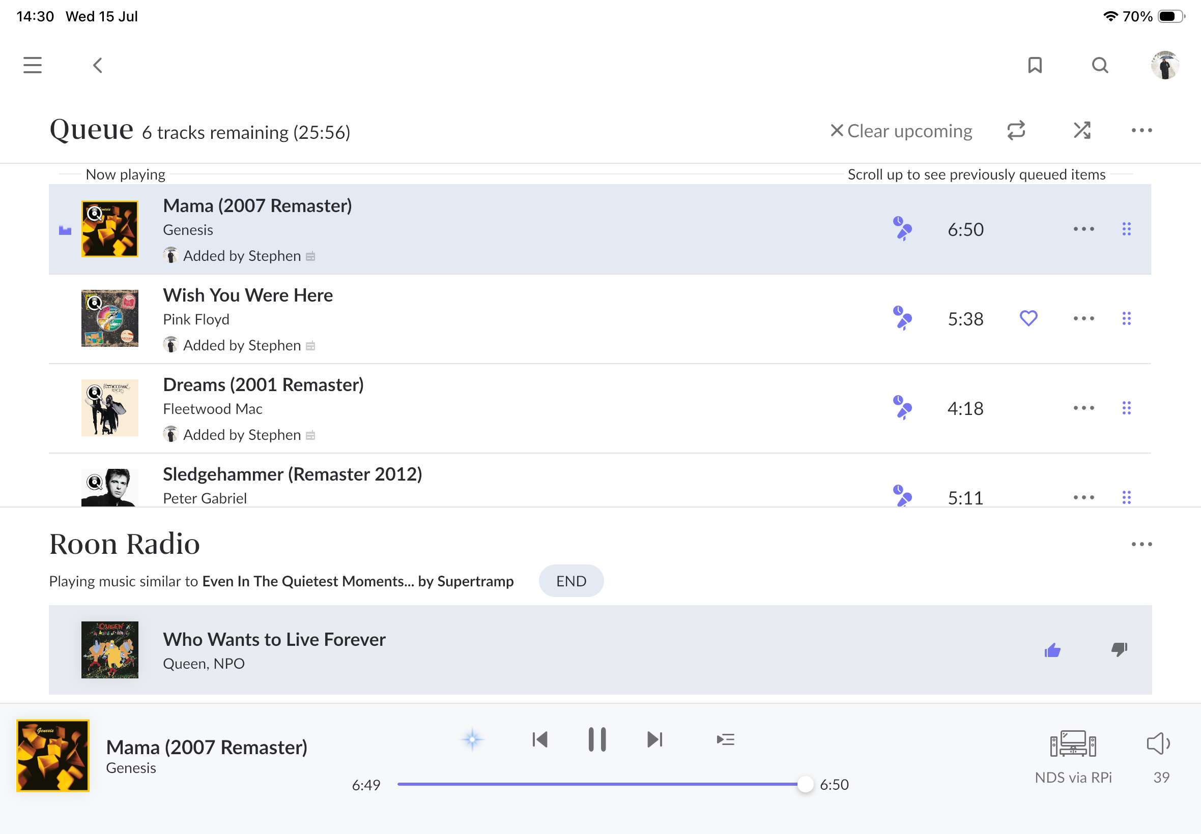

· Cisco switch, WiFi is linksys with two extenders
This one?
That’s the one …
I have rebooted RPi.
Some tracks continue with Roon Radio but others don’t.
