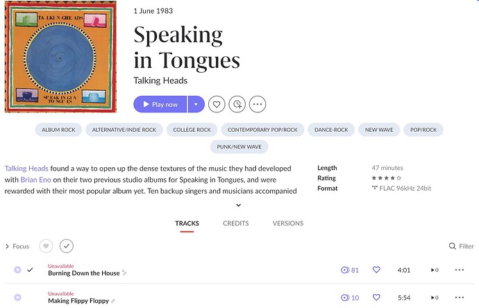

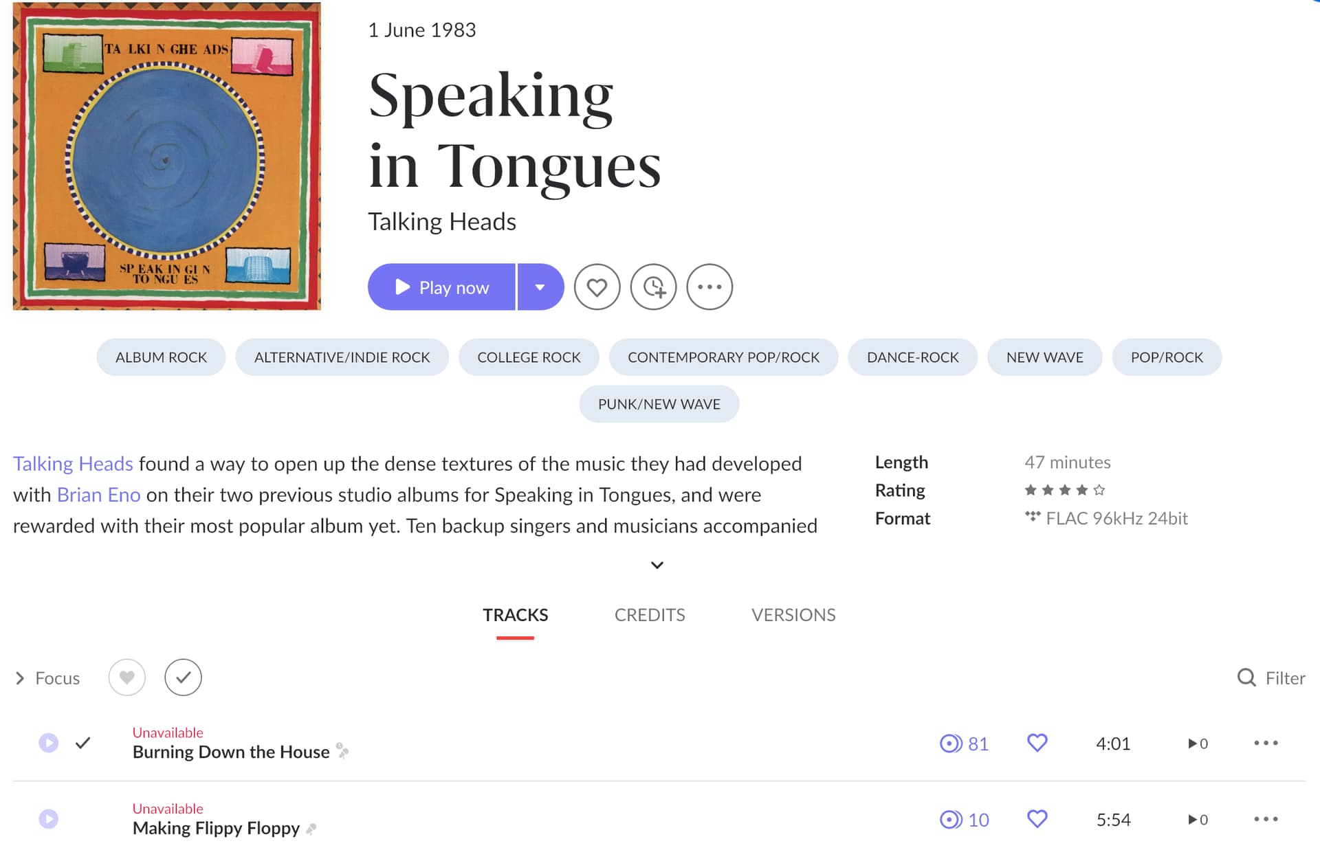

Albums show as unavailable and removal delayed on Roon 2.57.1598 with Tidal on macOS 15.7.3 (ref#R1X2I6)
· Streaming tracks greyed out or unavailable
· I'm running Roon 2.57.1598 with Mac OS 15.7.3 (Sequoia) and Tidal.
Even albums that I've just played are showing up as unavailable. Removing the album from the library does not actually remove the album from the library right away. My workaround has been to pick the artist and when the software selects a song from the "unavailable" album, I can add the album back to my library.
· Ubiquiti wifi with an AmpliFi HD WiFi Mesh point

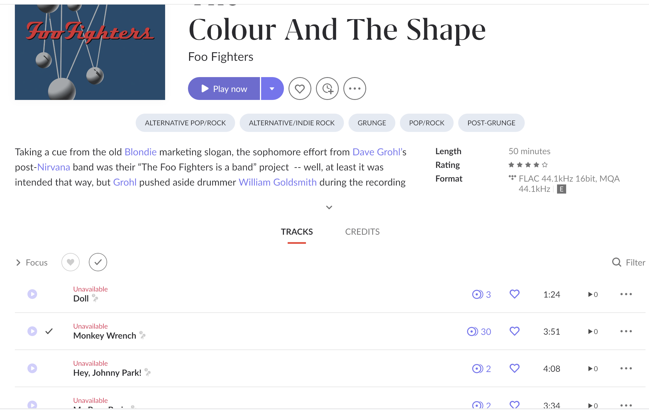

I have the same problem with albums that are part of my Tidal collection marked Unavailable. But it does seem like the problem is getting worse / that more albums are unavailable than last week.
Note I didn’t use Roon for a couple of years and only started using it again last month because of the Roon-ready WiiM ultra. Prior to that I used Tidal directly connected over USB to my other DAC.
It had been working fine with both the WiiM and the C47 which I even had playing sync so I could compare headphone audio quality. The problems started this weekend.
