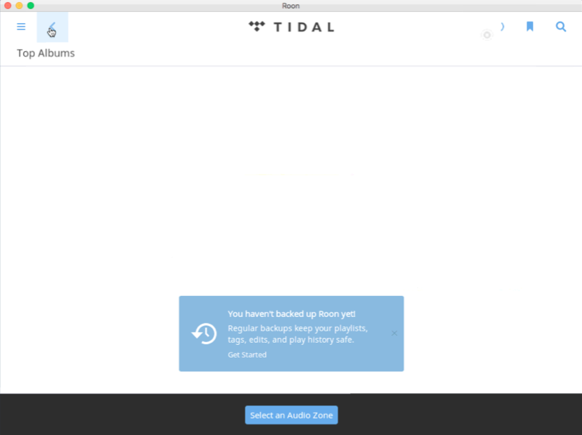

Second, can you share a screenshot of what you’re seeing when you navigate to your playlists and a TIDAL album?

Can you see the screen shots?

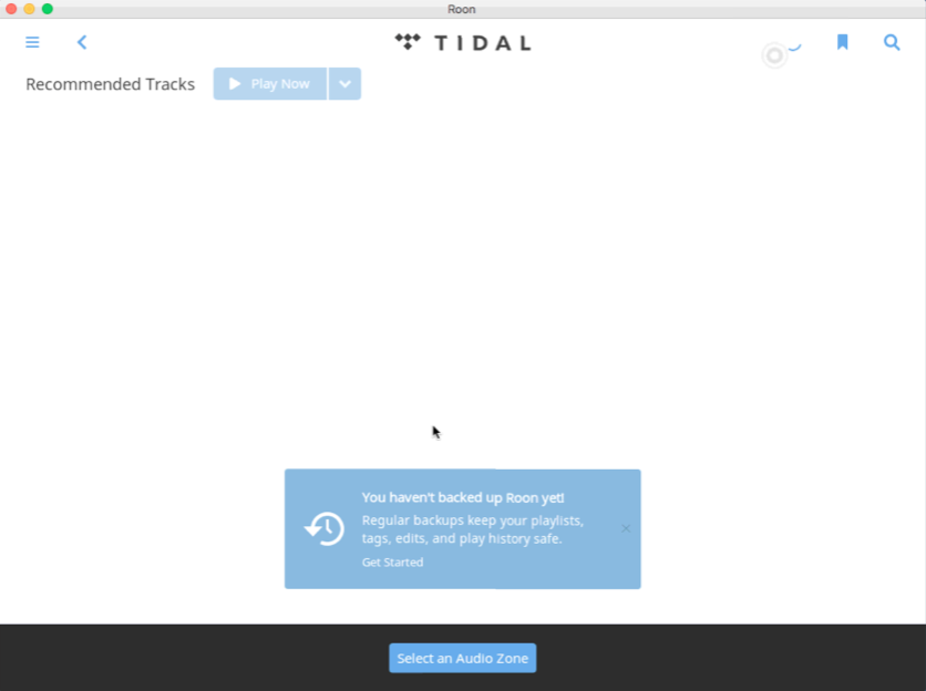

One more screenshot request — Are you able to navigate to an album in TIDAL rather than a playlist? If so, please screenshot what you see there as well.

Yes, but all empty, albums and tracks

Hi @Andi_Prabowo – we took a look at this and discussed with TIDAL, and there appears to be an issue with your TIDAL account.
The issue is that the country associated with this TIDAL account is Indonesia, which is not among the list of countries TIDAL is currently available in, nor is it among the list of countries Roon supports for TIDAL. That’s why nothing is loading is here.
I’m not sure how or why your TIDAL account is setup this way, so unfortunately you’ll need to get in touch with TIDAL’s support team and hopefully they can give you some more information about what’s going on here.
