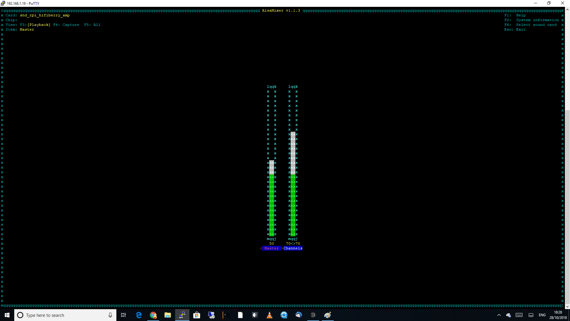

I found that pi hats all I’ve varying degrees of volume. Some are higher than others. What OS is the pi running it on. Itmight be Alsa levels are not at 100% in the mixer. Ssh in and type in alsamixer and check the outputs for PCM and master. Also make sure ttue Allo is set to Fixed Volume in Device setup.and in advanced bit of it it’s setting it to 100% on startup.

Ignore my levels as this is amp board so they are adjusted for volume control. The digi one should be at 100% if not use tab to select the levels and use arrows to move the values up if they are named differently post an image and I can guide you… To exit ctrl c. Then type alsactl store to set them permanently

forget the gui all that is for is setting up the soundcard to be the Allo nothing more. It does not control the output of the Allo itself, this is controlled by Alsamixer. Jusy type in alsamixer in the ssh shell you are running
