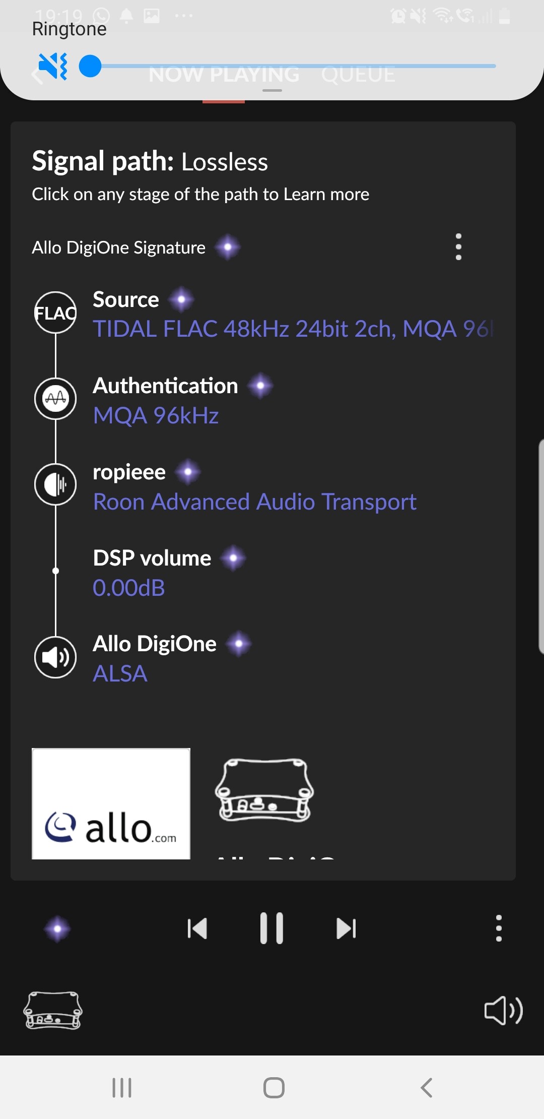

Any advice on Roon settings for allo digione sig device such as clock master priority? V best Julian
What DAC are you using with the DigiOne?
Master clock priority is used when grouping zones.
Using a Lexicon mc12 not grouping zones.
But dac showing 48khz?
That’s because you haven’t enabled the MQA core decoder in Roon. This will perform the first unfold for you.
Regarding the DigiOne, the settings to some degrees depend upon the DAC’s capabilities. I suggest you try the following for starters.
