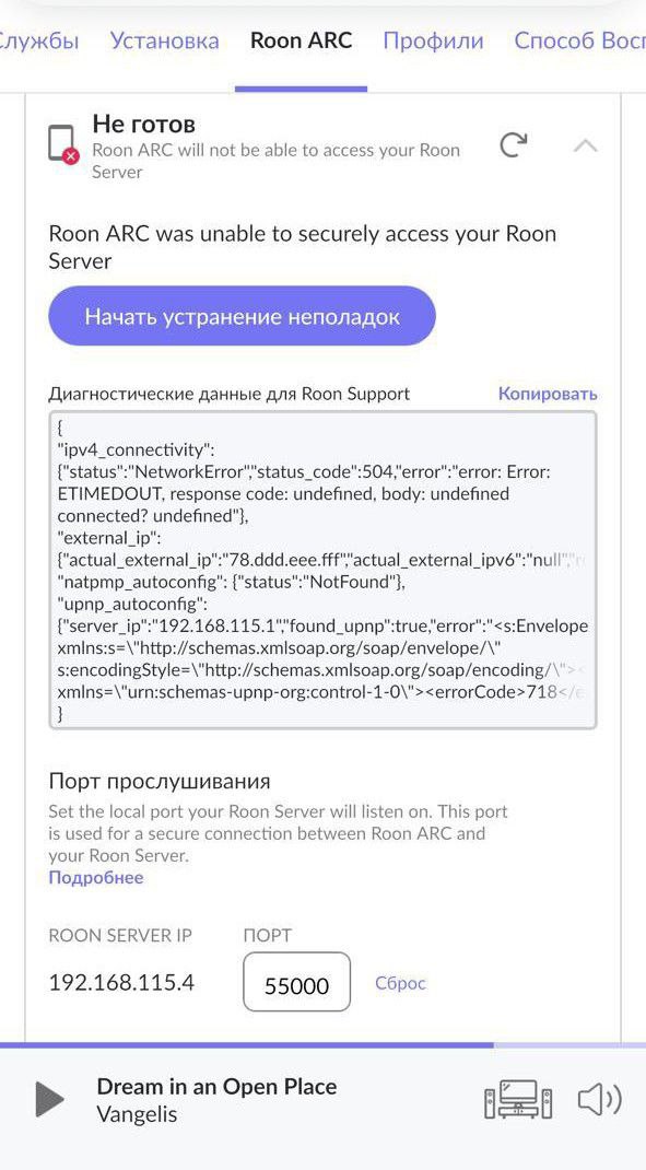

Description of Issue -
What is the exact port forwarding error message you see in the Roon Settings → ARC tab?
Hello. I’m setting up roon Arc and ran into difficulties. I managed to forward the ports but it doesn’t work. Please tell me what can be done for a successful result?

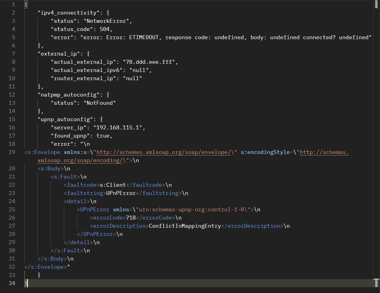

    "ipv4_connectivity": {
        "status": "NetworkError",
        "status_code": 504,
        "error": "error: Error: ETIMEDOUT, response code: undefined, body: undefined connected? undefined"
    "external_ip": {
        "actual_external_ip": "78.ddd.eee.fff",
        "actual_external_ipv6": "null",
        "router_external_ip": "null"
    "natpmp_autoconfig": {
        "status": "NotFound"
    "upnp_autoconfig": {
        "server_ip": "192.168.115.1",
        "found_upnp": true,
        "error": "
            <s:Envelope xmlns:s=\"http://schemas.xmlsoap.org/soap/envelope/\" s:encodingStyle=\"http://schemas.xmlsoap.org/soap/encoding/\">
                <s:Body>
                    <s:Fault>
                        <faultcode>s:Client</faultcode>
                        <faultstring>UPnPError</faultstring>
                        <detail>
                            <UPnPError xmlns=\"urn:schemas-upnp-org:control-1-0\">
                                <errorCode>718</errorCode>
                                <errorDescription>ConflictInMappingEntry</errorDescription>
                            </UPnPError>
                        </detail>
                    </s:Fault>
                </s:Body>
            </s:Envelope>"

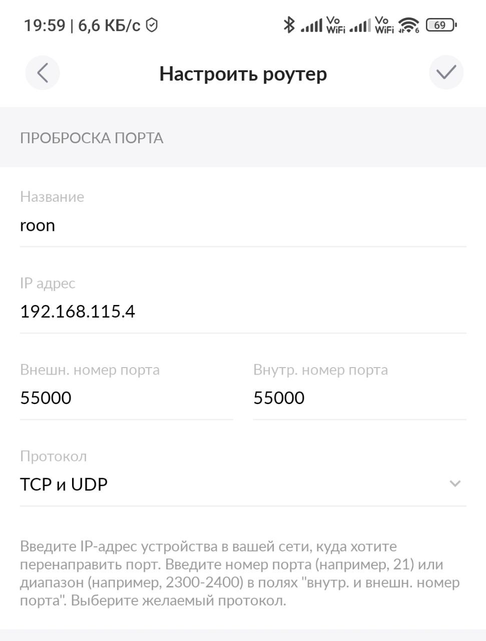

Port forwarding: outer 55000 → inner 55000
Most likely it is being blocked on your modem, I would check there.
The Internet provider provides a connection via optical fiber and it seems that I do not have access to the settings of the device that converts the signal from optical to lan. If I can find out what needs to be changed in the settings, I can probably ask the provider about it.
I got access to the Huawei HG8120 optical modem, now I’m figuring out what setting needs to be changed.

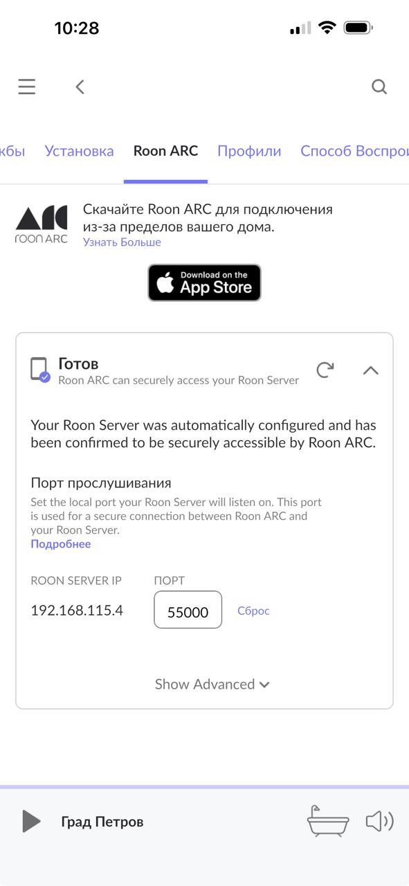

I managed to complete the settings, it turned out that I need to forward the port to Huawei HG8120H
This → post helped with the settings
