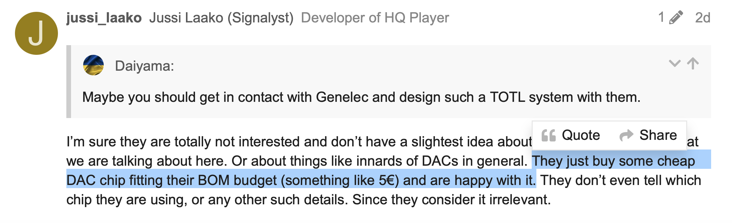

I don’t think @jussi_laako needs to reply but I’m sure he will agree with me that your two DSD Direct DACs are significantly better than the DACs inside your DSP monitors… especially feeding them DSD256…
i.e. in comparison to iFi and Holo, they are indeed crappy.
The sub-optimal part is (for the 7th time I repeat this I think…) that you take the beautiful Holo/iFi analogue output, then run it through a cheap ADC and then a cheap DAC.
