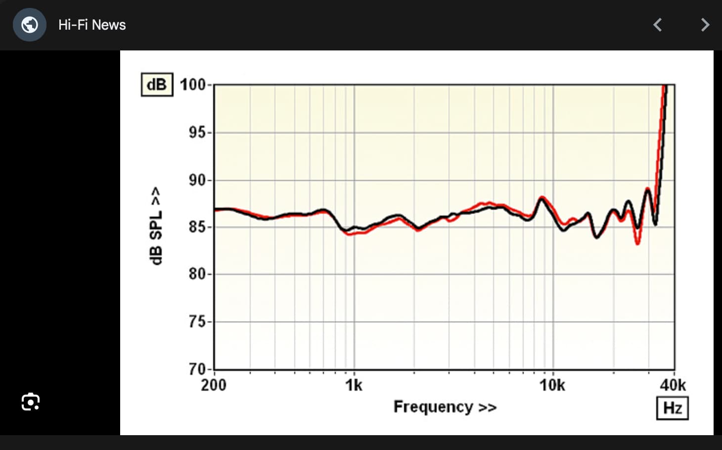

KEF tweeter is even worse, it has >20 dB oil can resonance right above 20 kHz frequency. I use either soft domes which have resonance below cross-over frequency. Or preferably ribbon tweeters (flat or AMT) which can go flat to 50+ kHz.
At the moment I use Dynaudio (soft dome) and Elac (AMT ribbon). Plus needed digital room/speaker corrections in HQPlayer. Since I now feed also vinyl (analog) sources through HQPlayer, I can have all the same corrections with those as well. I can do up to 768/32 PCM or DSD256 for analog sources, thanks to RME ADI-2 Pro. I could do digital cross-overs at those rates as well.
My R3 has the resonance above 30kHz but when I use the HQPlayer cut the crap filter, I can’t measure any resonance with my Earthworks M30 mic. So in practical sense, I never hear or measure it. I usually leave the 20kHz filter on always with speakers.

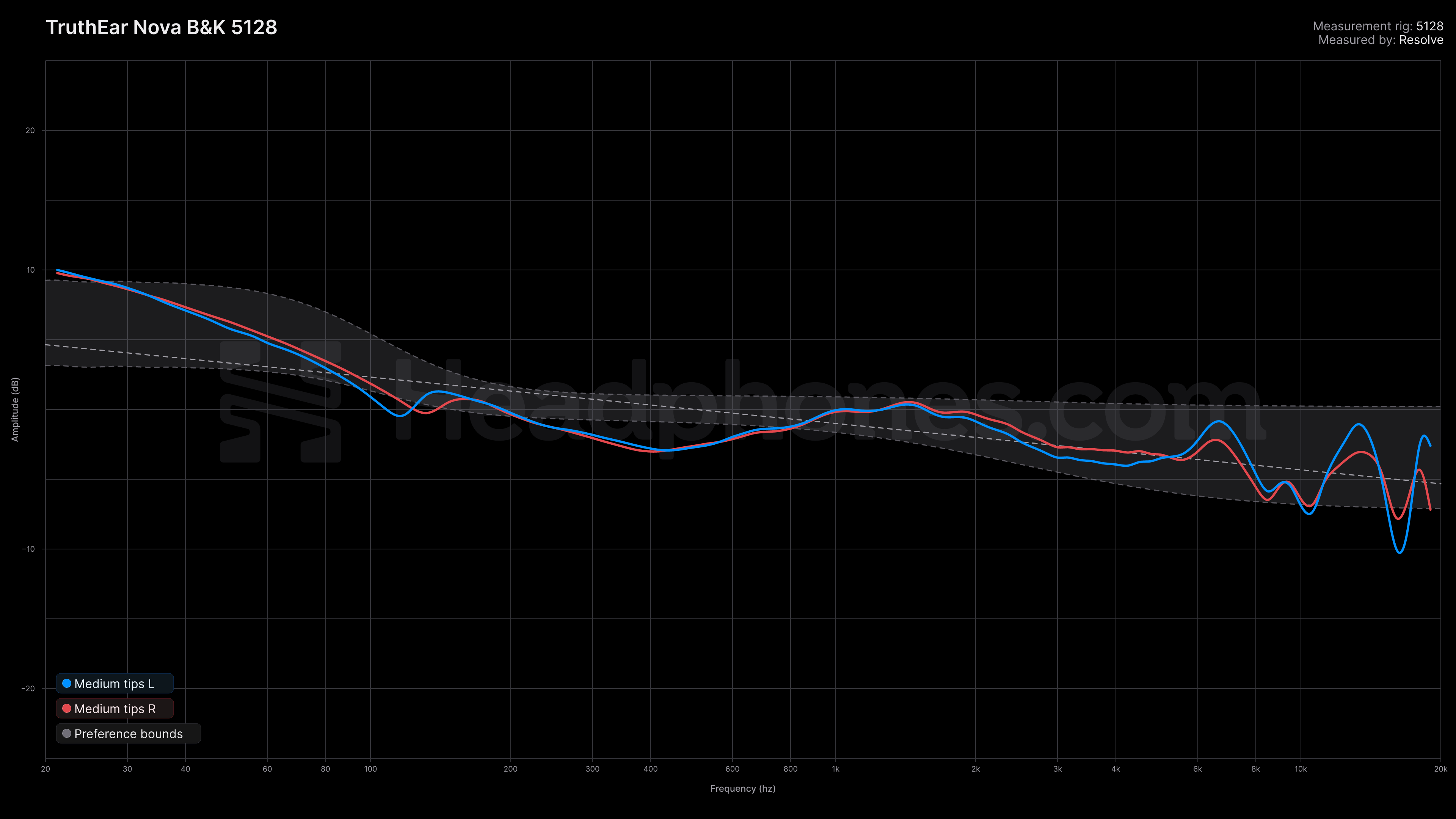

But I’m listening more with my Truthear Nova IEMs at the moment with Cyan 2 - these are amazing out of the box ! Only a bit of bass and 425Hz boost required, looking at B&K 5128 measurements. I am hearing things in songs I never hear before with speakers or headphones. Maybe because the combination of ultra low distortion and ultra low SNR due to being an ear plug essentially. No 20Hz filter here! Unless I spot fake hires

Some metal domes have the resonance as low as 23 kHz. The main issue with the resonance is when it is combined with a relatively leaky oversampling filters found in many DACs, since then it can be triggered even with RedBook content… If the DSP speaker can be run at 96 kHz from external upsampling, then that can be avoided when combined with the 20 kHz cut-the-crap filter.

Yes those are stellar, close to Harman target straight out of the box, without EQ.
And ultra low distortion. Getting this kid of distortion from speakers in a large room at decent SPLs is expensive, if even possible !! 114dB and under 0.5% THD !?
I gave my dad my Zero:REDs (got him brand new silicon tips of course) and got the TruthEar Nova for myself. Slightly different bass tuning (Nova has more bass). Both have the ultra low distortion. Both have different impedances, so the amp can make a difference. You want <1ohm output impedance and able to drive low impedances.
The Crinacle Red needs the gentle 425Hz EQ also - thats an issue with 711 couplers, that the B&K 5128 measurement rig doesn’t have.
Nova comes with a nicer cable too and I like the look more (as well as more bass)
