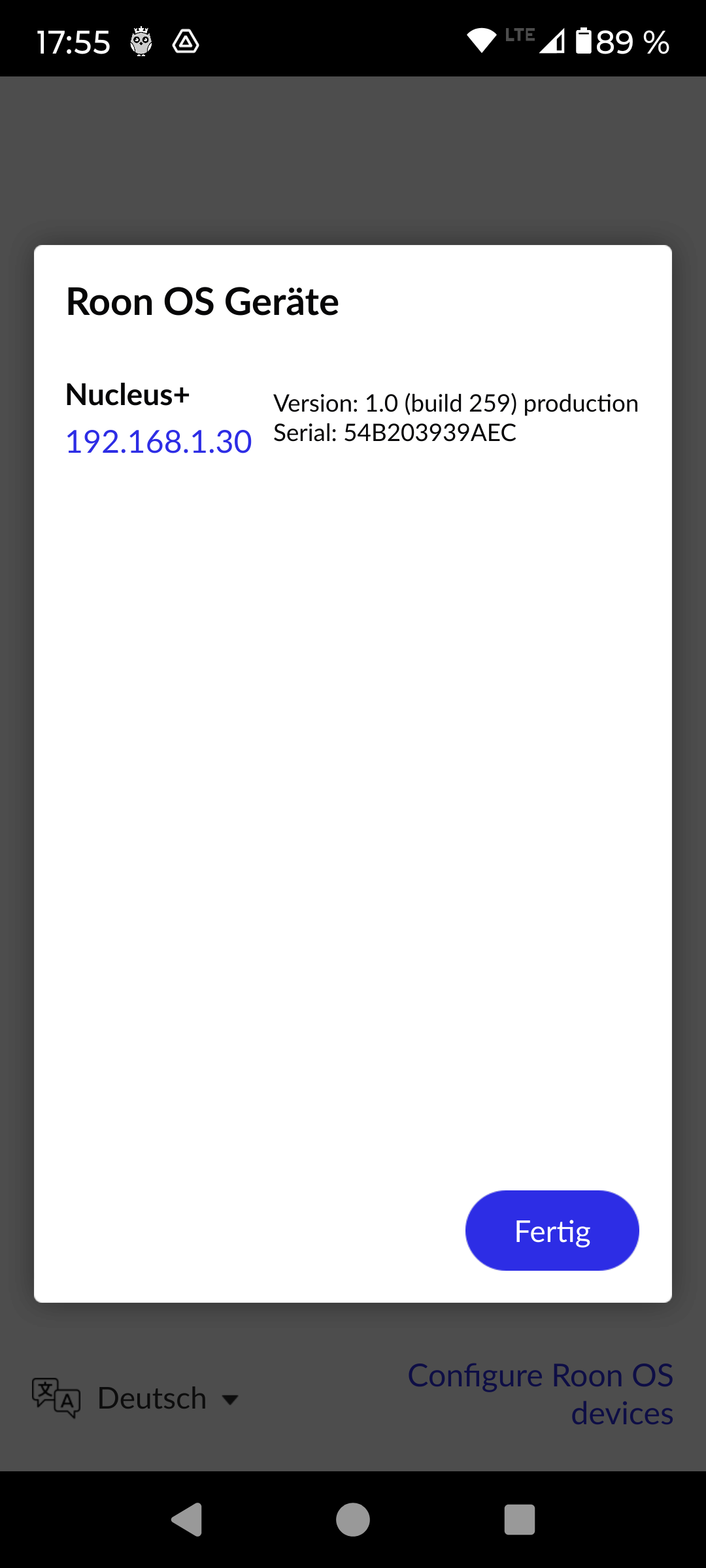

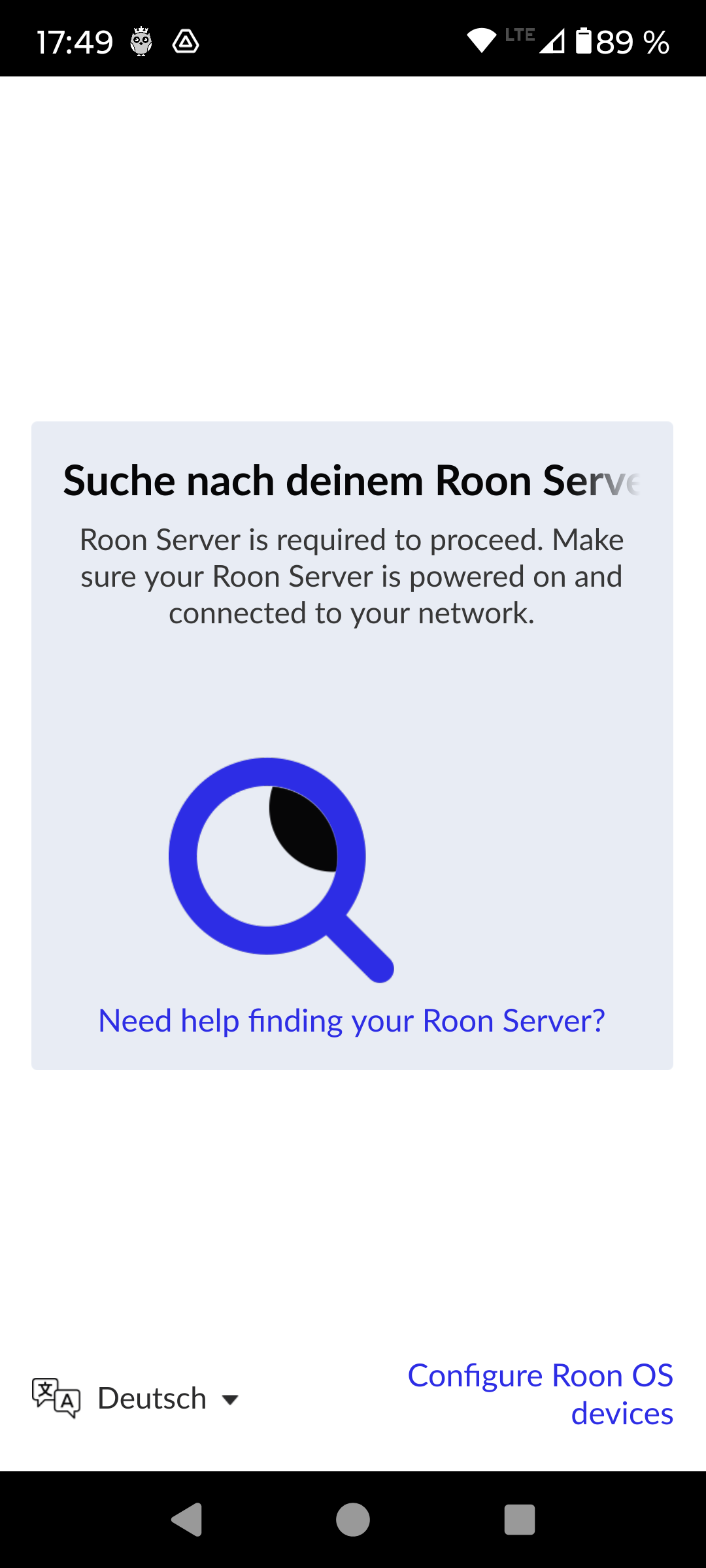

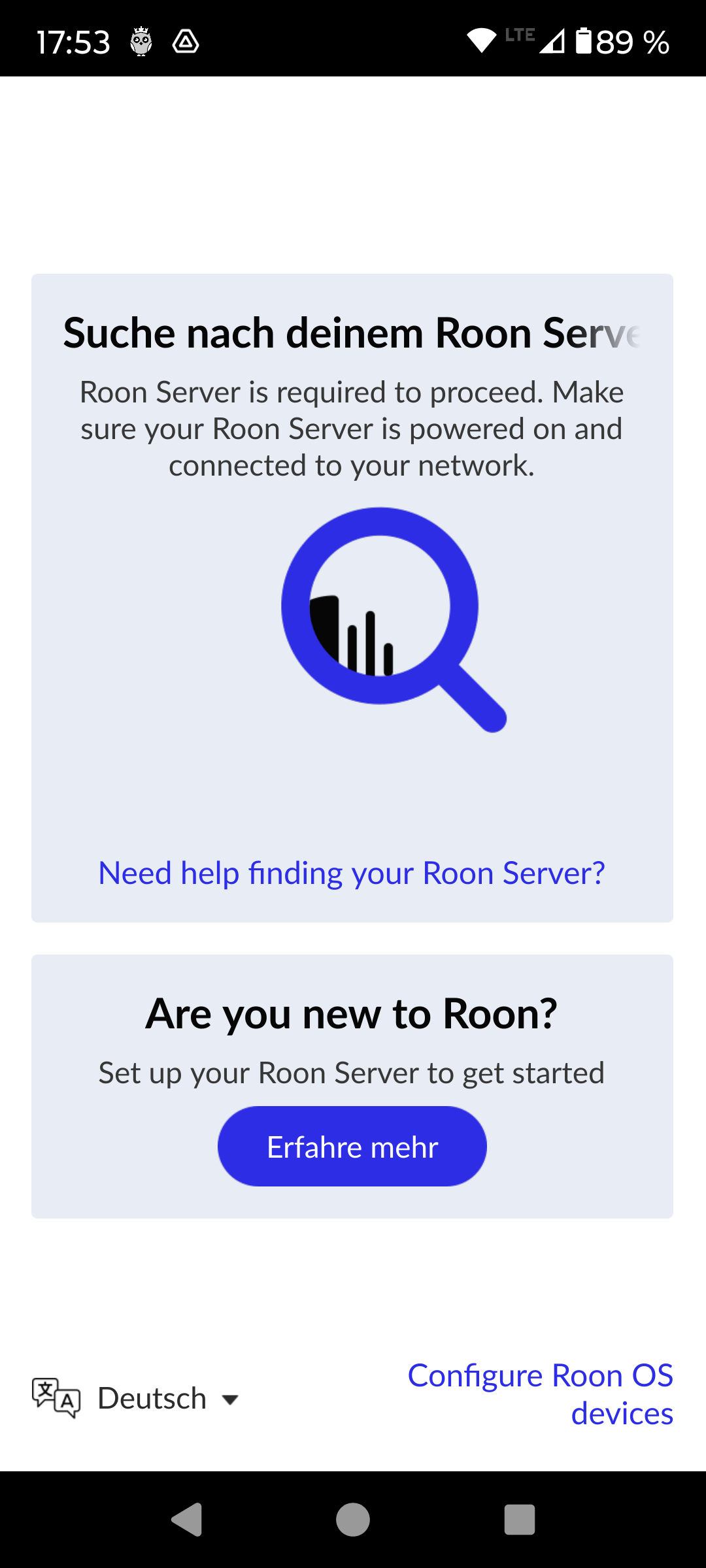

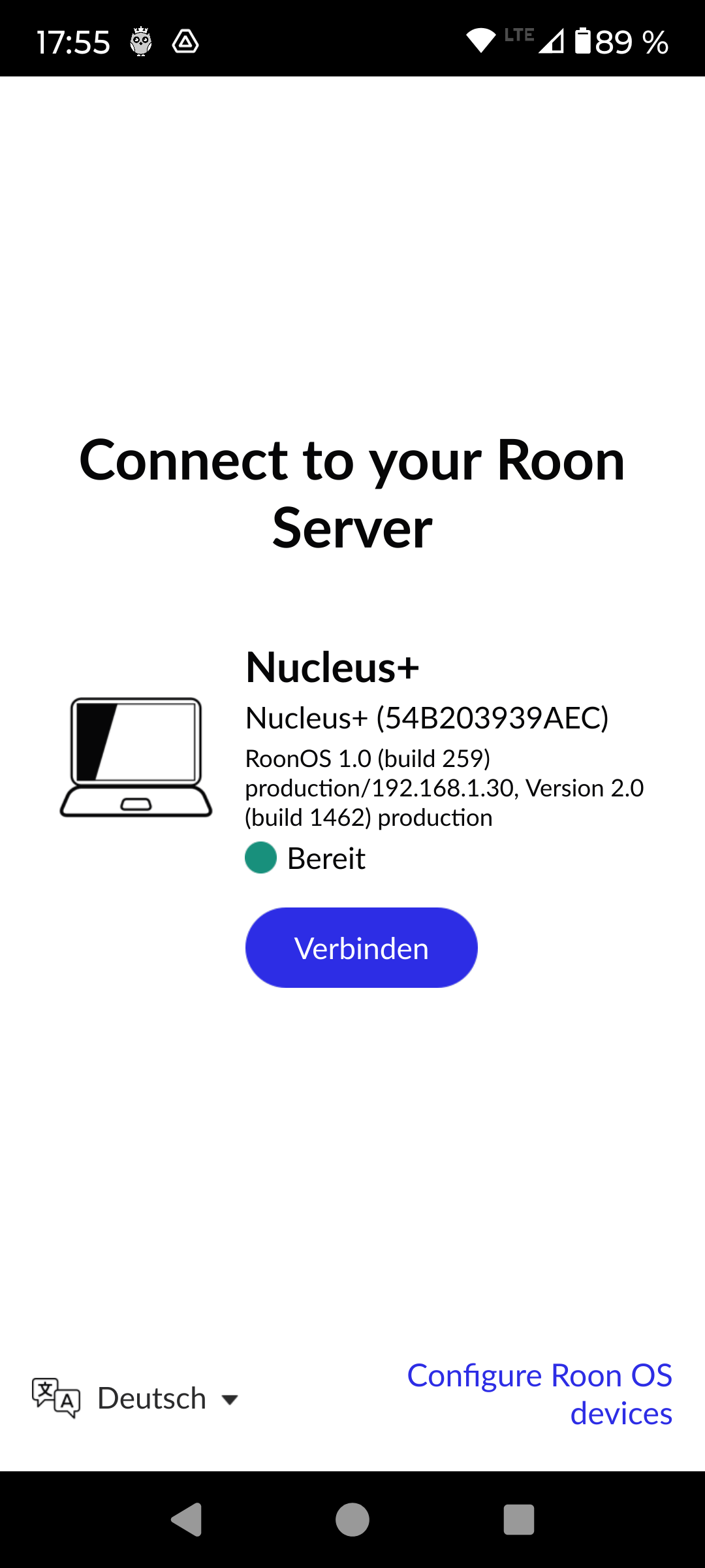

Yesterday, again I had problems to connect and made screenshots:
the first one at 17:49 shows “warte auf deinen Roon server” (waiting)
then some seconds later “suche nach deinem Roon server” (searching)
then I took an apple device: no problem to connect
at 17:53 on Android still searching - I klicked on “Configure Roon OS devices”
at 17:55 the Roon OS device was found
then I connected to Nucleus
I hope this helps…

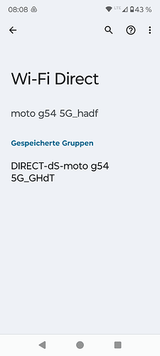

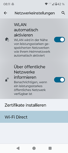

Hi @Boris_Huber,
Since the iPhone connects and the Android phone doesn’t on the same network, let’s explore some possible differences in the network interface portion of the Android phone.
Please try the following on the Android:
  1. Open Settings
  2. Select Network & Internet
  3. Select Wi-Fi
  4. Select your home network
  5. Select Advanced
  6. Select Privacy
  7. Select “Use Device MAC”
Next, please navigate to Settings > System > Advanced > Developer Options > Networking > Wi-Fi-Enhanced MAC Randomization. Make sure it’s turned off.
Then power the phone off and back on. Open Roon and try to connect.
Please let us know if this helps.
Hi connor,
I did as you wrote:
  1. Open Settings
  3. Select Wi-Fi
  5. Select Advanced
  6. Select Privacy
…on my phone there is no such option. But I made it into the developer mode by clicking 10x on the build number!
… I found that (hurrah) but there is no option to turn off…

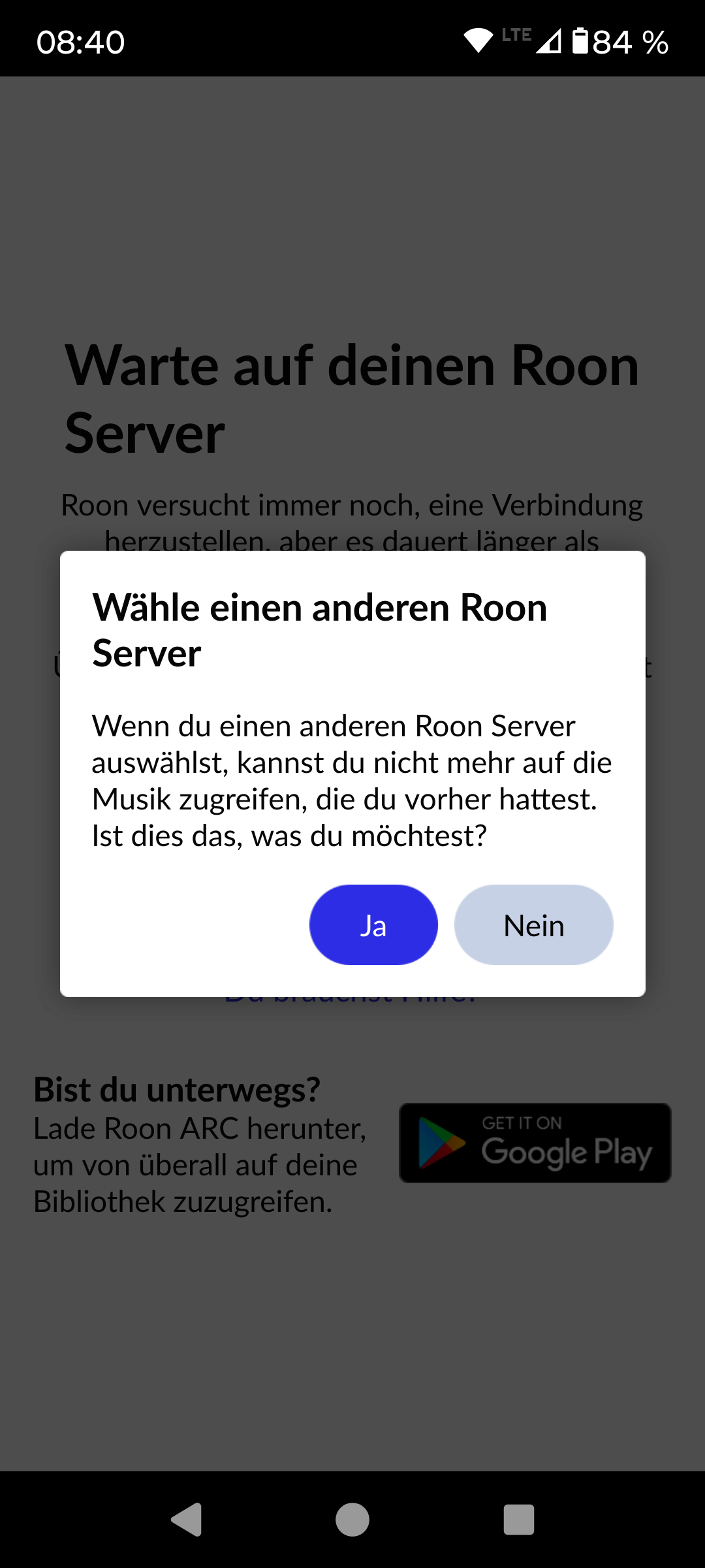

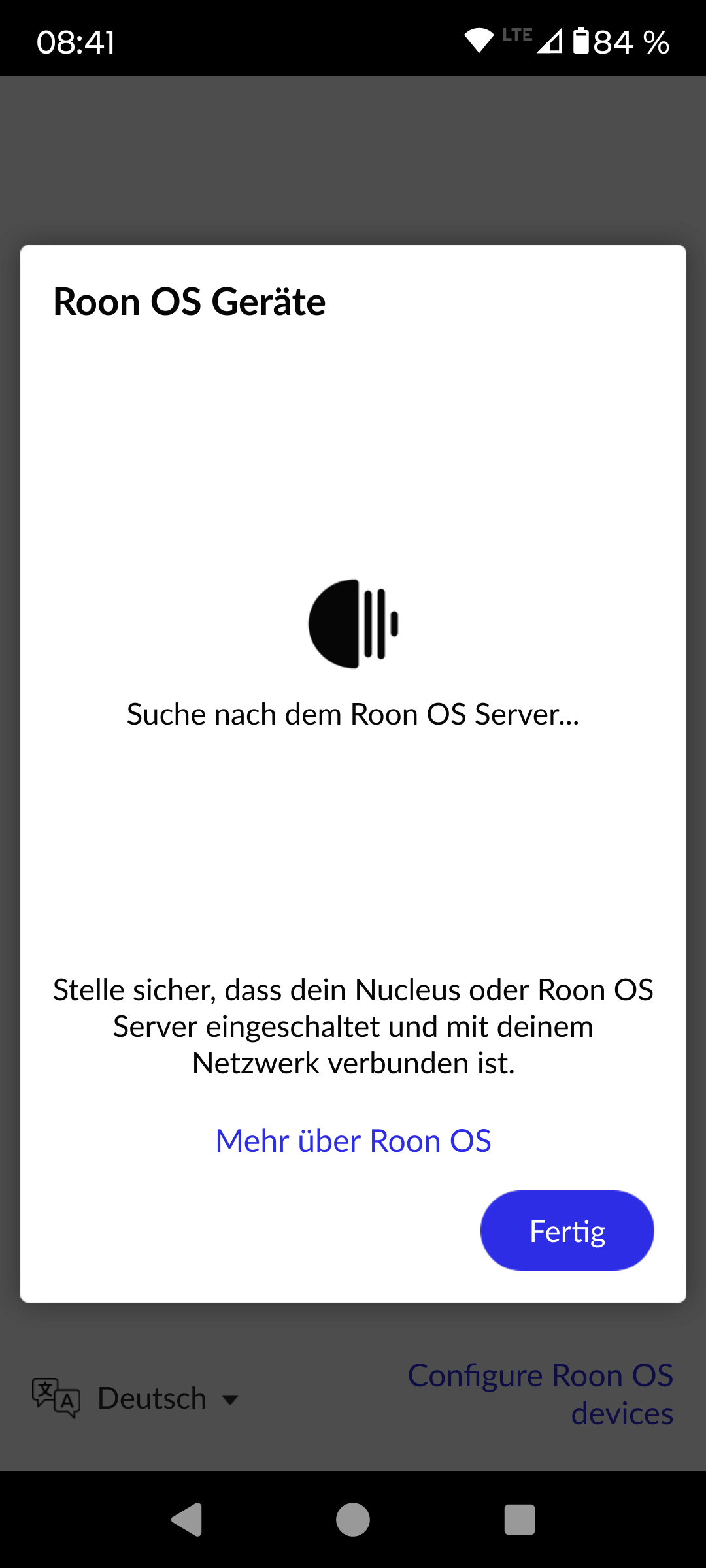

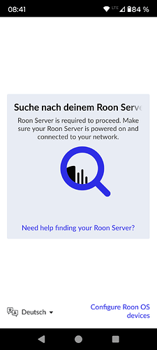

Hello,
I did as you wrote me,but the problem is still the same. Today I tried to connect (see screenshots),
At 08;48 there is still no connection. At 08:50 it worked.
Kind regards
Boris
