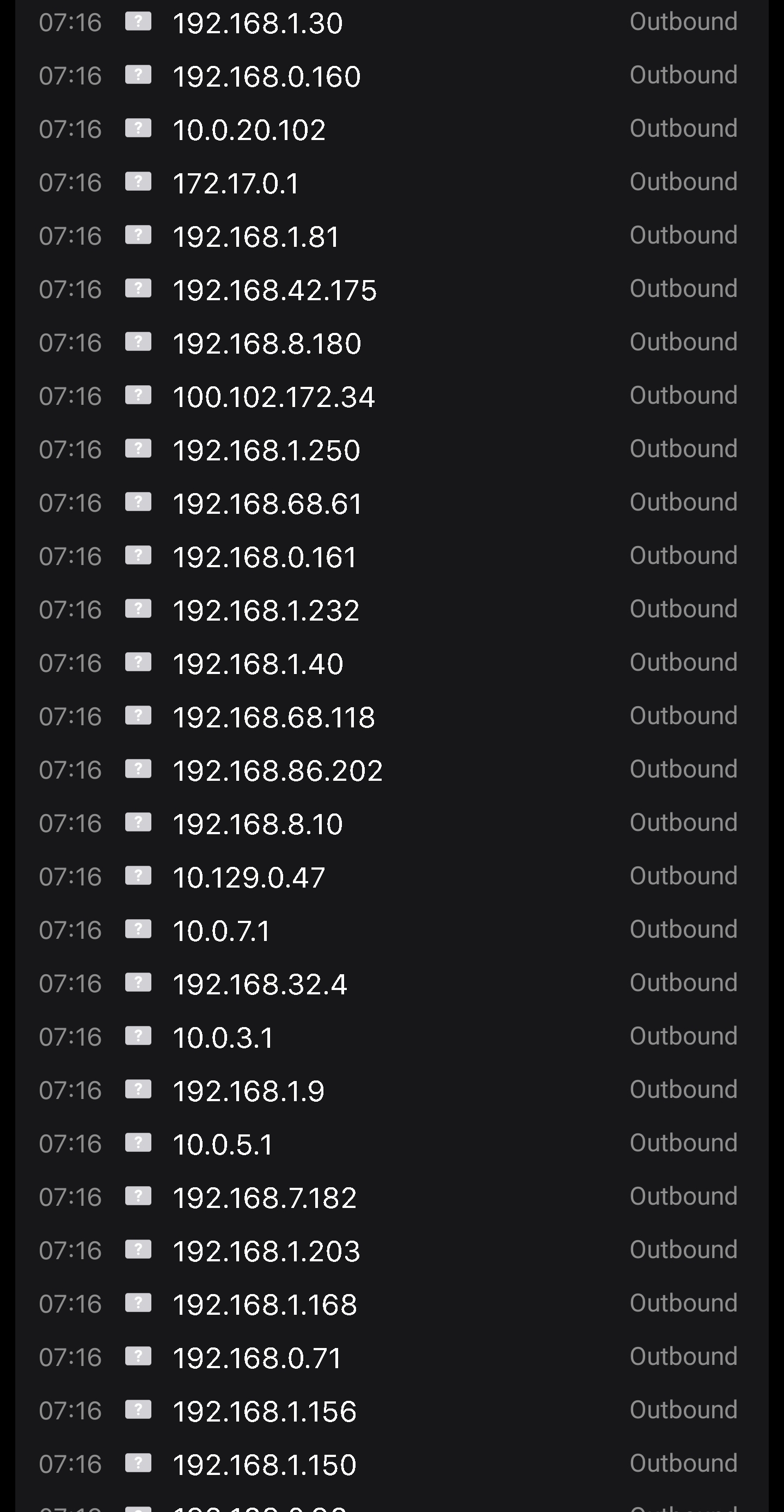

When trying to connect my Android phone to Nucleus and we are on the same subject, I can see that during scan alot of ip addresses are being scanned but not my subnet er both reside on.
192.168.3.0/24 is my subnet

And I can see in my log files that roon does not search the local lan ip scope but a lot of other subnets…
Why is it Roon client does not start searching from local ip subnet?
Your screenshot shows the term “Outbound” also. So it might be a snippet from your firewall logging outbound traffic (only – nothing else to expect). Your local network is local though and so not outbound – in fact does your router / firewall not get involved handling internal traffic in the same subnet.

And many others that face the same issue wrote that it finds the server even without, you just have to wait a long time for it to happen. You provided a picture with the term “Outbound” on it as evidence. I just commented on your picture and why your subnet doesn’t show there (why it doesn’t do as evidence, or at least requires a good explanation why your subnet should show there).
