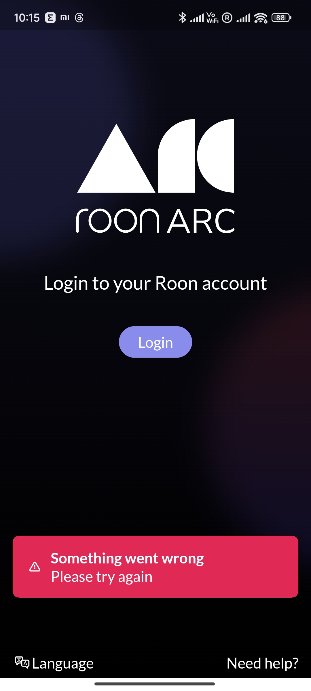

Need help as the subject, because always hang and show message as "something went wrong..."
Router: CBNHub CH8679
wifi to xiaomi 13 cell phone

I did both you mentioned but it’s not solved.
Hey @jsnliu,
Thanks for the follow-up! Can you be a bit more specific around when the hanging and failure occur during the sign-in process?
Do you simply press the login button and receive the error in your screenshot above? Do you have any VPNs or third-party antivirus applications active on the device?
An important thing to note with your specific device - we haven’t yet tested ARC on the MIUI 14 operating system running above Android on this phone. Because of this, it may be useful to review a set of ADB logs from the affected mobile device. Steps to follow below:
