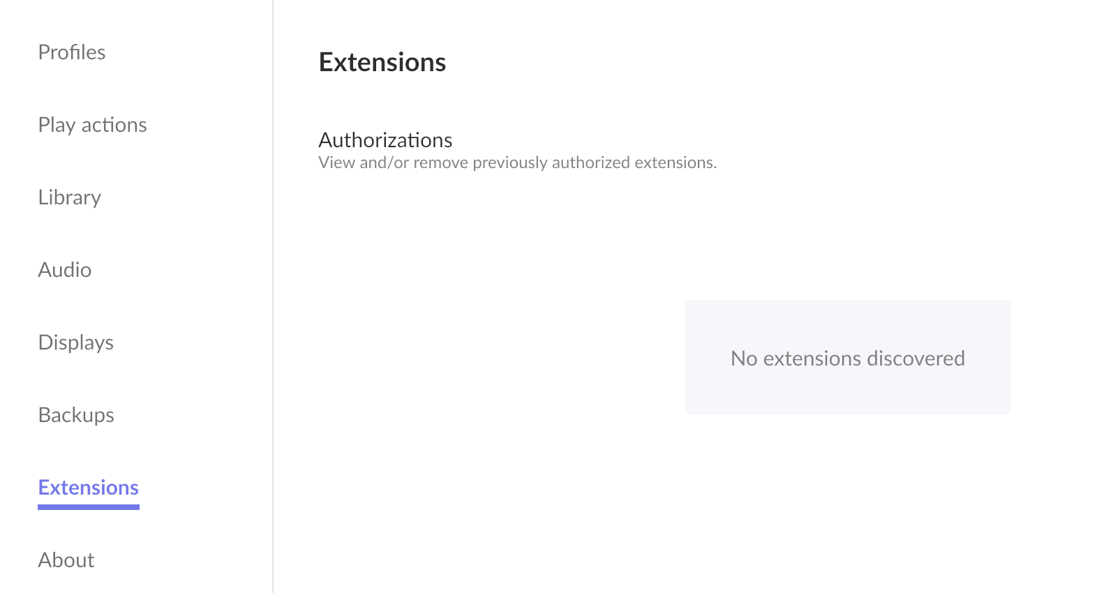

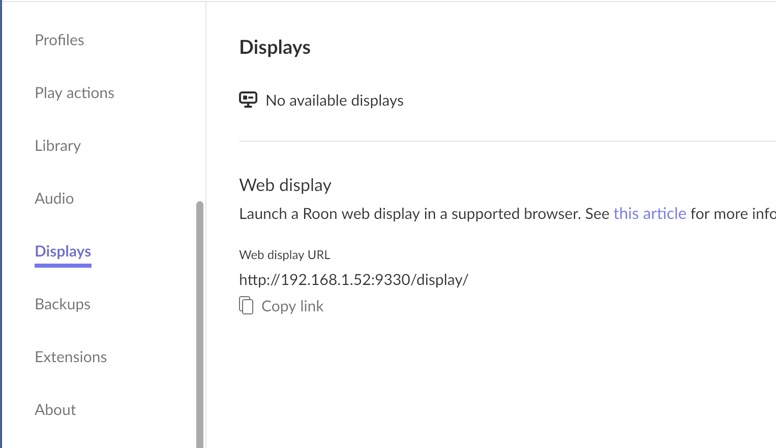

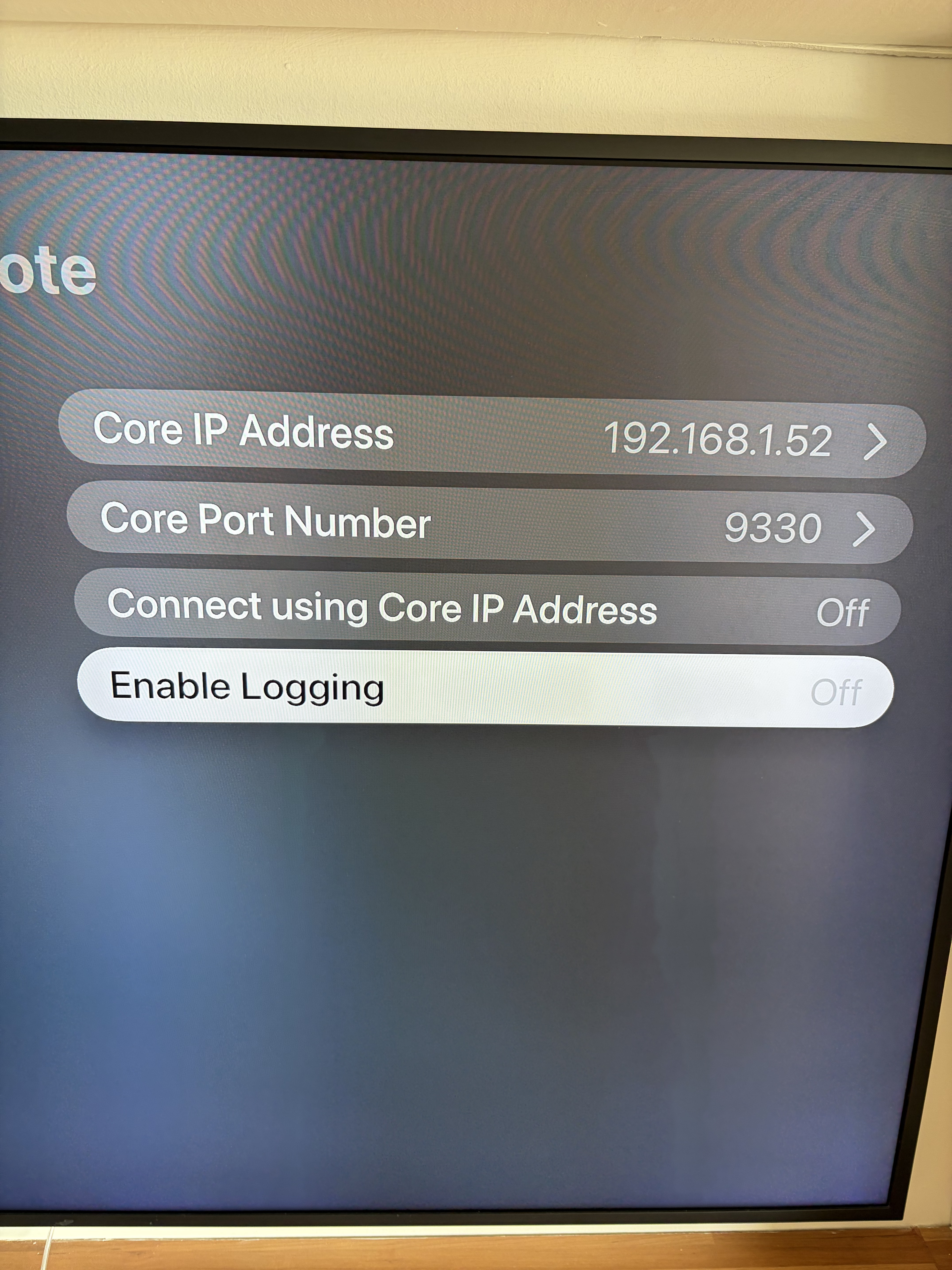

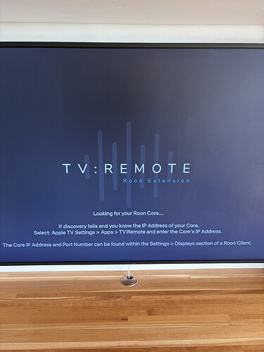

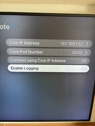

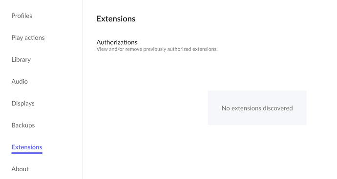

With apologies, I’m back again :grimacing:
Every so often I can’t get TV: Remote to work, and I’m at that point again.
Here is what I’m seeing:
and in my Apple TV settings:
In my Roon settings:
Any guidance would be appropriated. Thanks!
-David
Have you tried a reboot of the Roon Core? When I’m running the core on a Mac I sometimes run into this issue.
Alternatively, setting “Connect using IP Core Address” to Yes in the app settings will bypass discovery and connect directly to the entered IP address.
A reboot of the Roon server did it.
