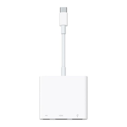

My iPhone is now USB-C and hence my Apple lightening Camera Adaptor is redundant. There is no Apple equivalent. However they do retail an Apple USB-C Digital AV Multiport Adapter Dongle.
Can the forum confirm if this would be suitable?
The chain would be Apple iPhone 15 - Apple AV multiport adapter - Meridian Explorer 2 DAC - Line Audio in to my car radio

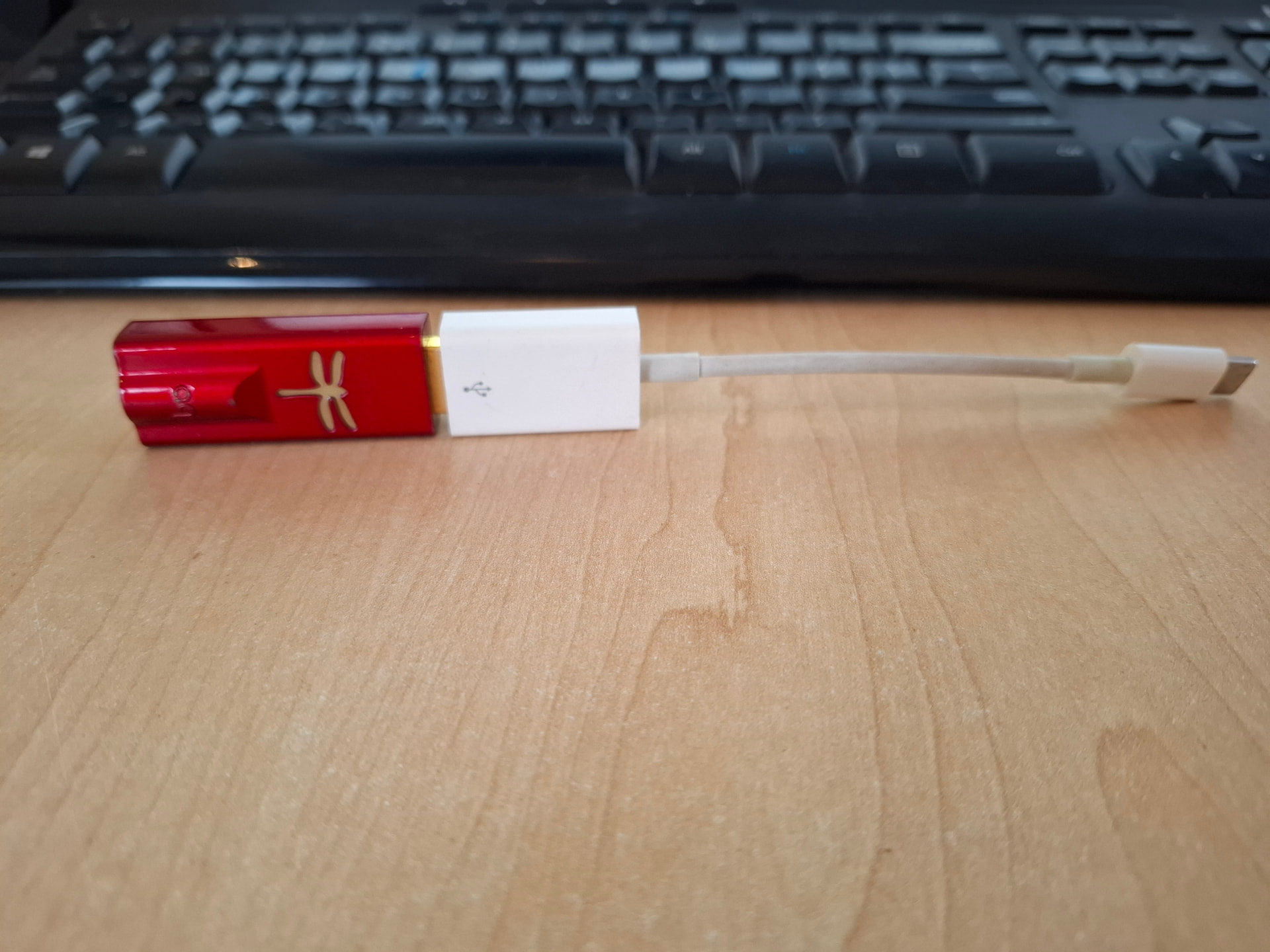

this is a “genuine apple part” its seen here running a Dragonfly DAC. USB C one end USB A female the other. same as the camera kit with Lightening replaced by USB c
Thank you for this attractive suggestion. My existing Meridian DAC throws up an insufficient power error message on the iPhone. It would seem your Dragonfly does not hence it is a compelling choice. Meanwhile Currys here in the UK promote (you remember them!) via their eBay channel refurbished Apple AV adapters at a more realistic price with male USB-C for the iPhone and female USB-C and A ports for the DAC & Power. They have a returns policy so I have placed an order. If no joy I will buy your working solution.

That was Audioquests claim to fame the got current consumption undr the apple limit !’!

Connecting an official Apple lightening camera connector via an official Apple lightening to USB adapter returns an unrecognised device iOS message. So the former is consigned to the bin! However there is some good news …. The Meridian Explorer DAC works perfectly interfacing to iPhone USB-C port using an official Apple USB-A to C converter

This is the exact device I use with DAC and a battery pack.
https://www.amazon.co.uk/iPhone15-Compatible-Accessories-Thunderbolt-Converter-USB-C-USB/dp/B0CSD1RC6V
