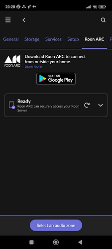

I have an Android phone (Xiaomi 13) and Arc simply does not start. I just get a black screen and nothing else - even after waiting up to a minute. On my previous phone (Samsung Galaxy with LineageOS) it worked so my server setup is probably OK.
From the server side everything seems to be OK and my iPad connects - albeit from the same WiFi (I have no other option for the iPad)
